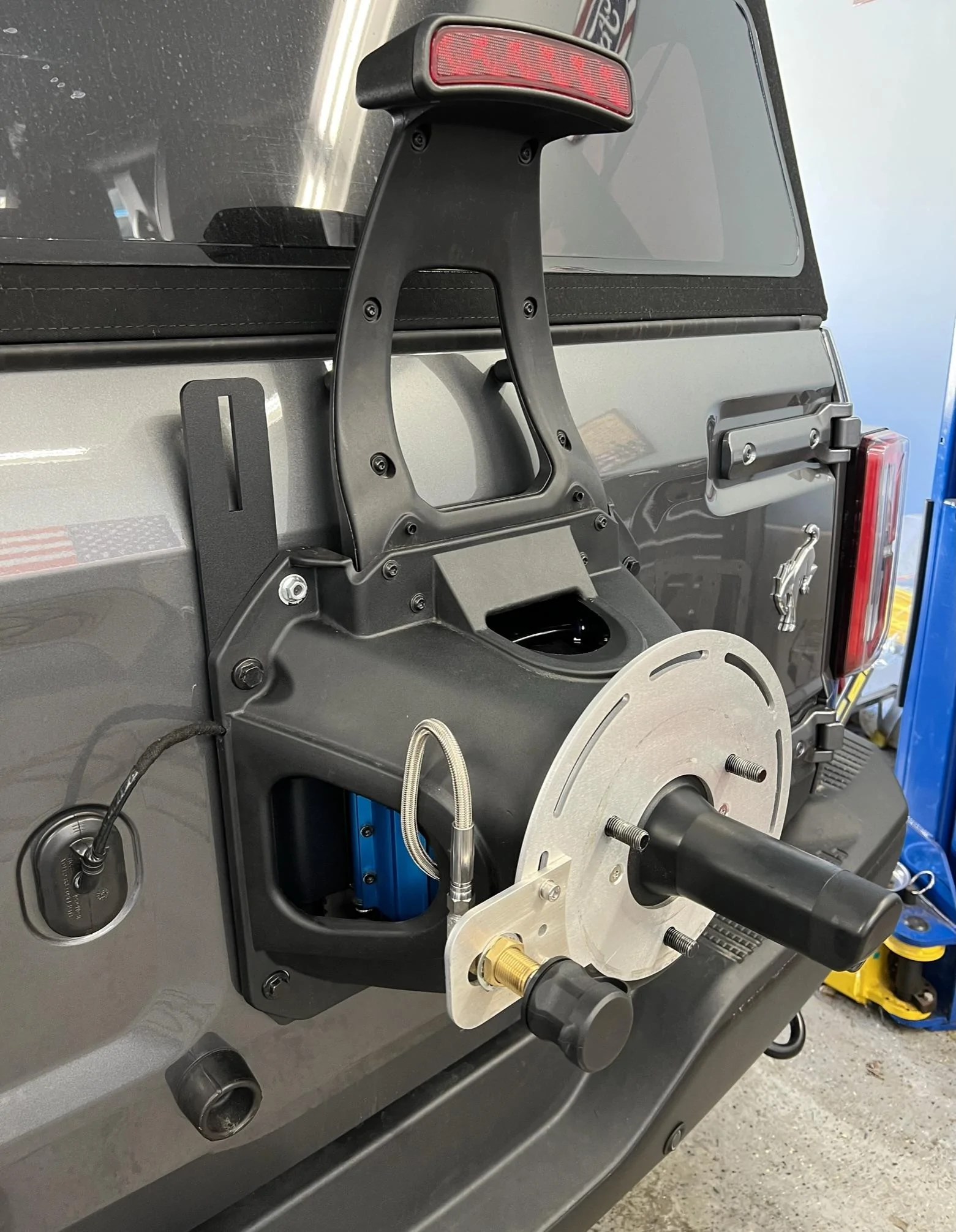

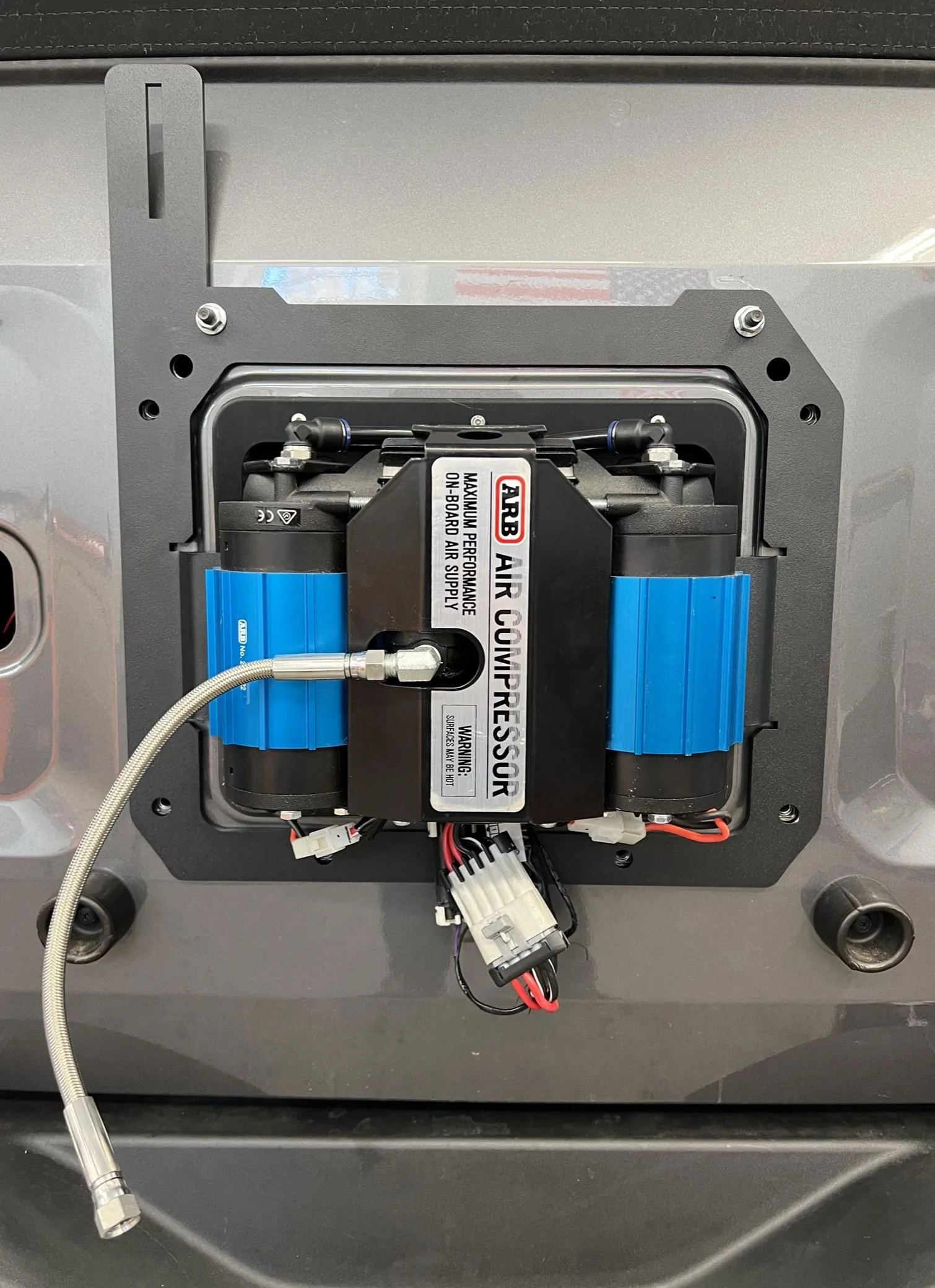

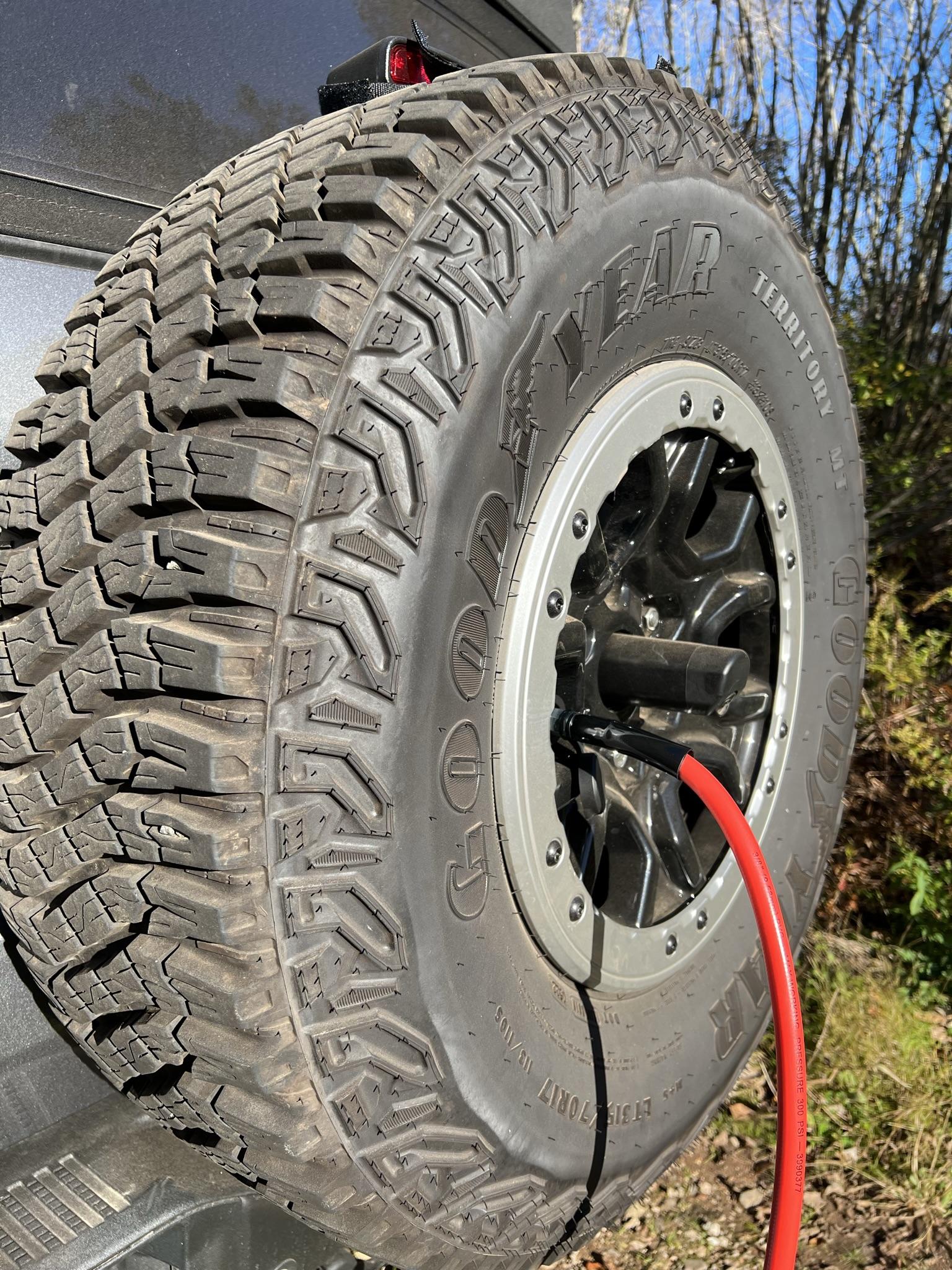

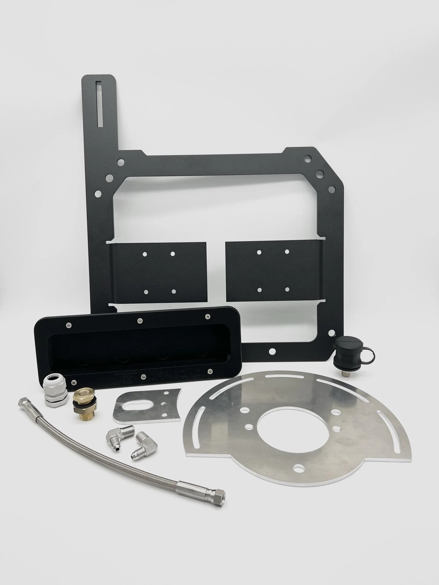

Introducing our newly designed ARB Twin Compressor mount- the best way to mount your ARB Twin Compressor to your Bronco.
Using the AGS Off-Road Air-Gate Kit, make use of wasted space on your vehicle and easily mount your compressor inside of the spare tire carrier. Keep your compressor away from the hot engine bay and have easy access to your air hookup without opening the hood. The mount is easily installed without drilling, cutting, or disturbing critical factory components.
With the optional AGS Filter Relocation Kit, keep the elements out and pull only cool, clean air from the interior of the vehicle for worry free off-roading.
Click HERE to check out the AGS Off-Road Air-Gate Kit and all of its contents.

The wiring harness goes from the compressor through our Modular Tailgate Pass-Through, giving you a water tight seal. From there, it is routed through the hinge using the factory wire loom to the interior of the vehicle (where the factory subwoofer is located). This is where you will need to extend the ARB harness from, and it is an easy spot to tie into upfitter switch. From there we ran our large power wires through the interior of the vehicle and exited through a grommet on the firewall.

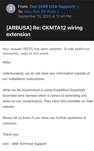

Any issues being this far from the battery? I remember someone mentioning in another thread that ARB’s instructions say the distance from the battery was a limiting factor.

We had similar concerns when developing this product, so we reached out to ARB to get their opinion. Attached is a screenshot of their response.
Ford Bronco The best way to mount your ARB Twin Compressor - from AGS Off-Road IMG_5420
We recommend using the Expedition Essentials Extended wire harness that ARB recommended. The harness we made for testing purposes was built to the same specs, and there have been no issues.

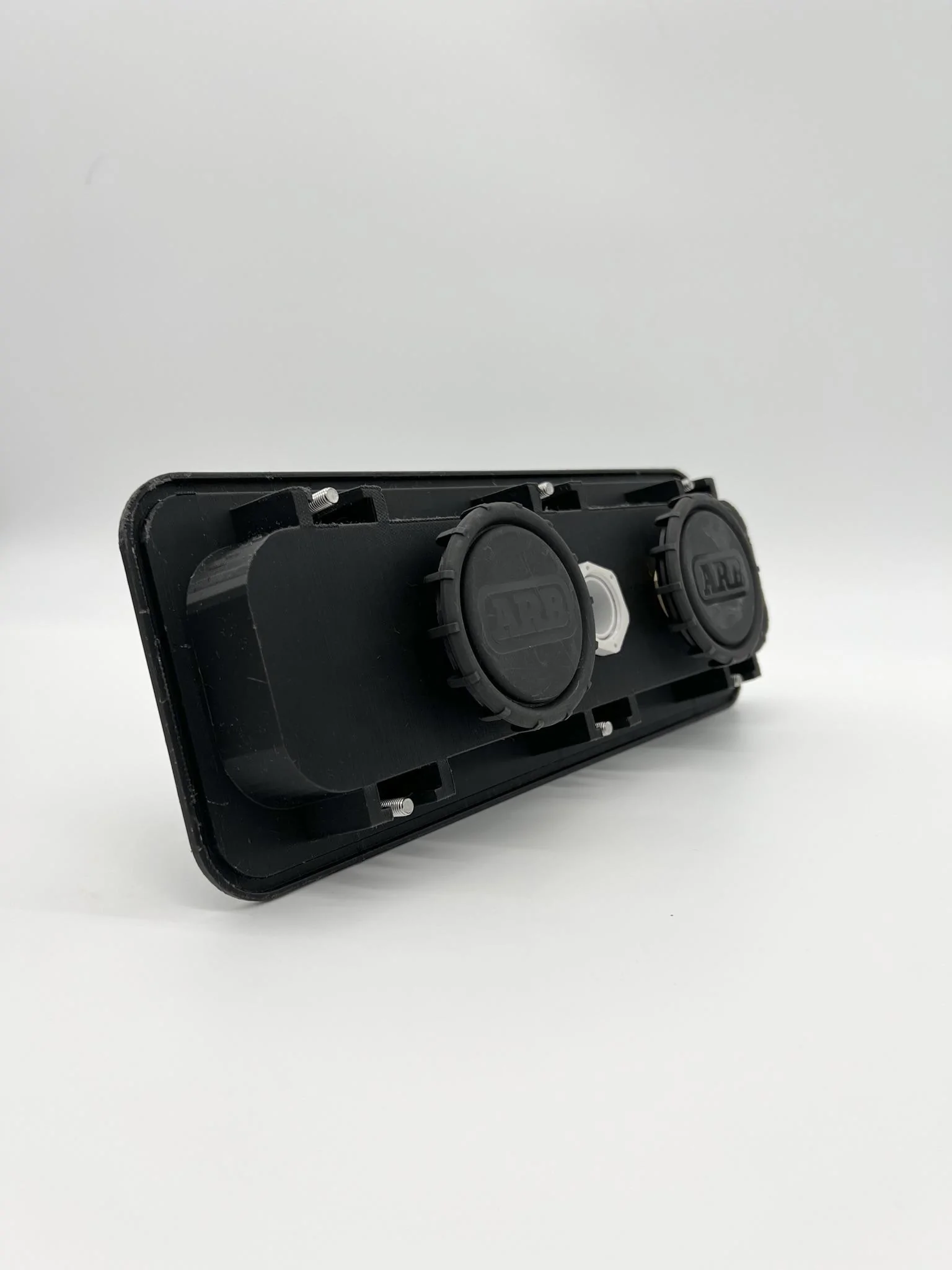

Sounds great! Do you have pictures of the optional filter relocation kit installed on the inside of the door?
Also, it looks like the prototype part is 3d printed. Will that be injection molded for the production run?

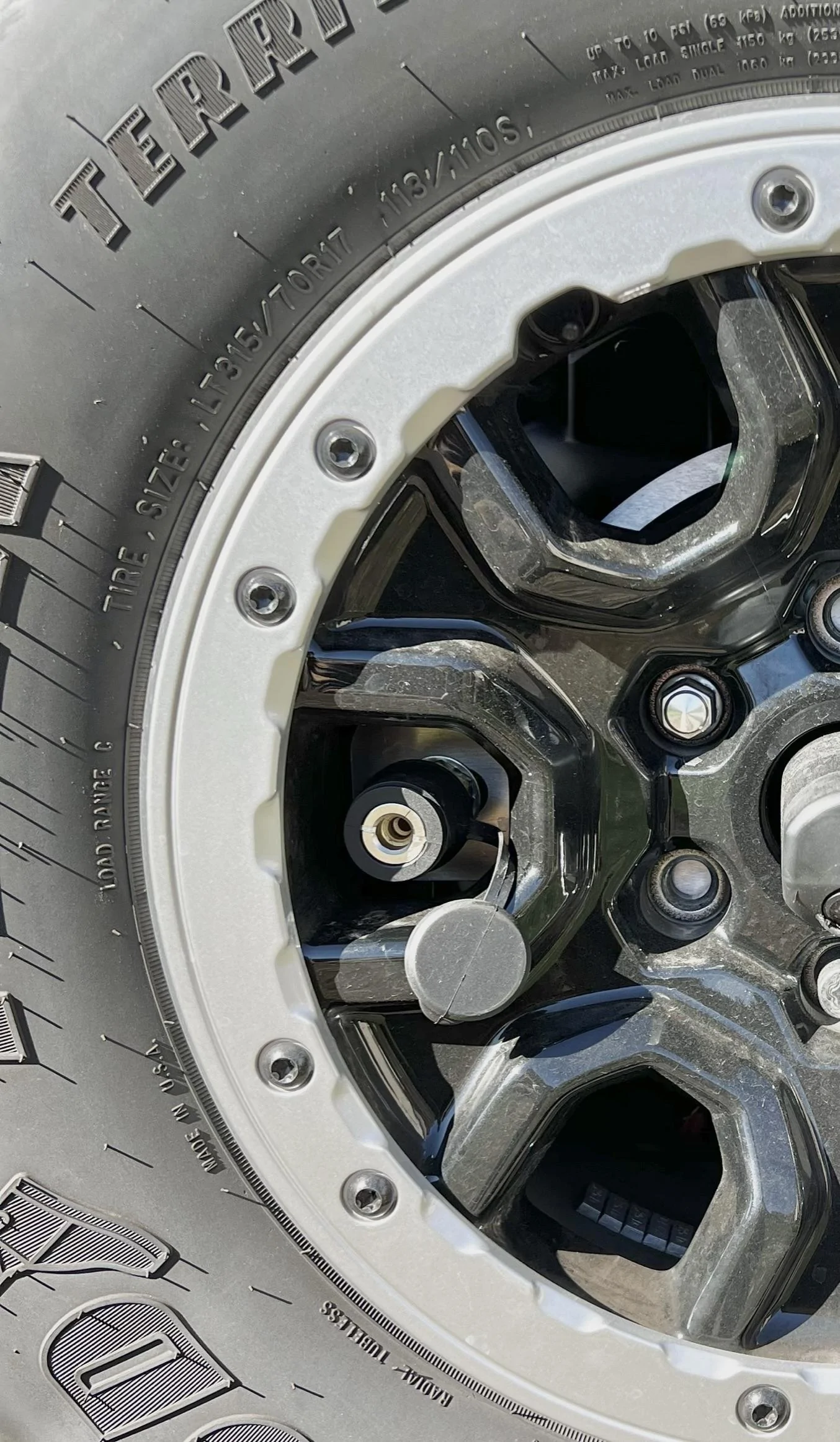

Will that quick connect sticking through the wheel, work with every factory wheel?
Here is a picture of the Filter Relocation Kit installed on the backside of the Modular Tailgate Pass-Through. Can not show it installed because it is hidden inside the tailgate.
Ford Bronco The best way to mount your ARB Twin Compressor - from AGS Off-Road 82B3E168-D320-4538-B56F-991D6F410E25
Yes, exactly. The Modular Tailgate Pass-Throughs we ship out will be injection molded with a UV resistant Polycarbonate material.
