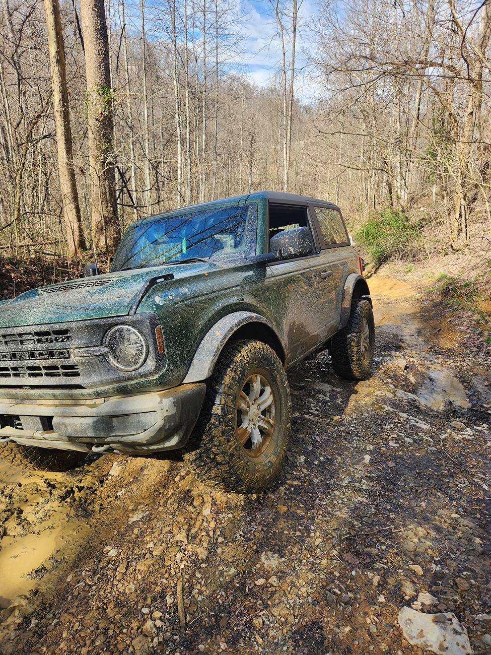

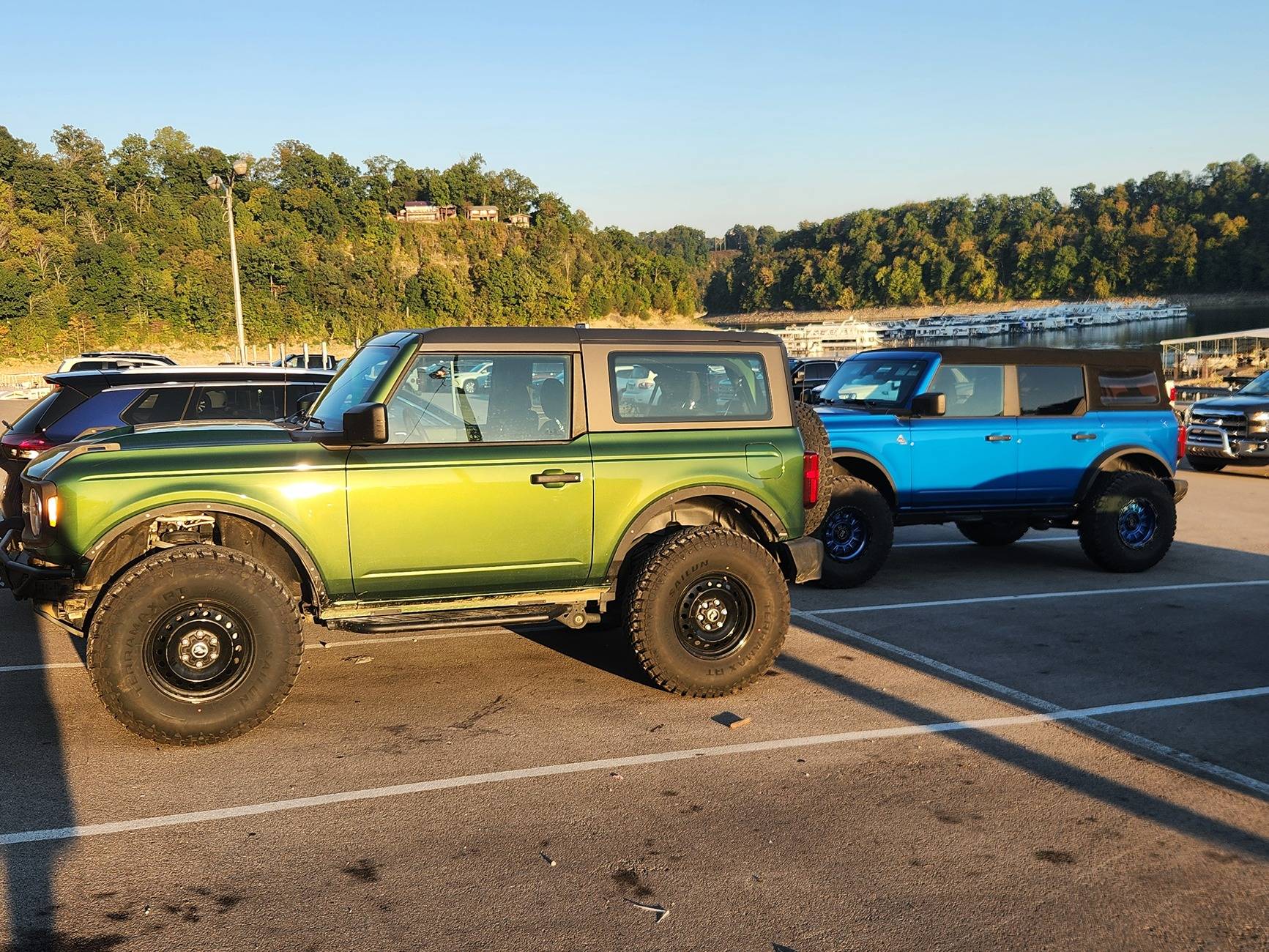

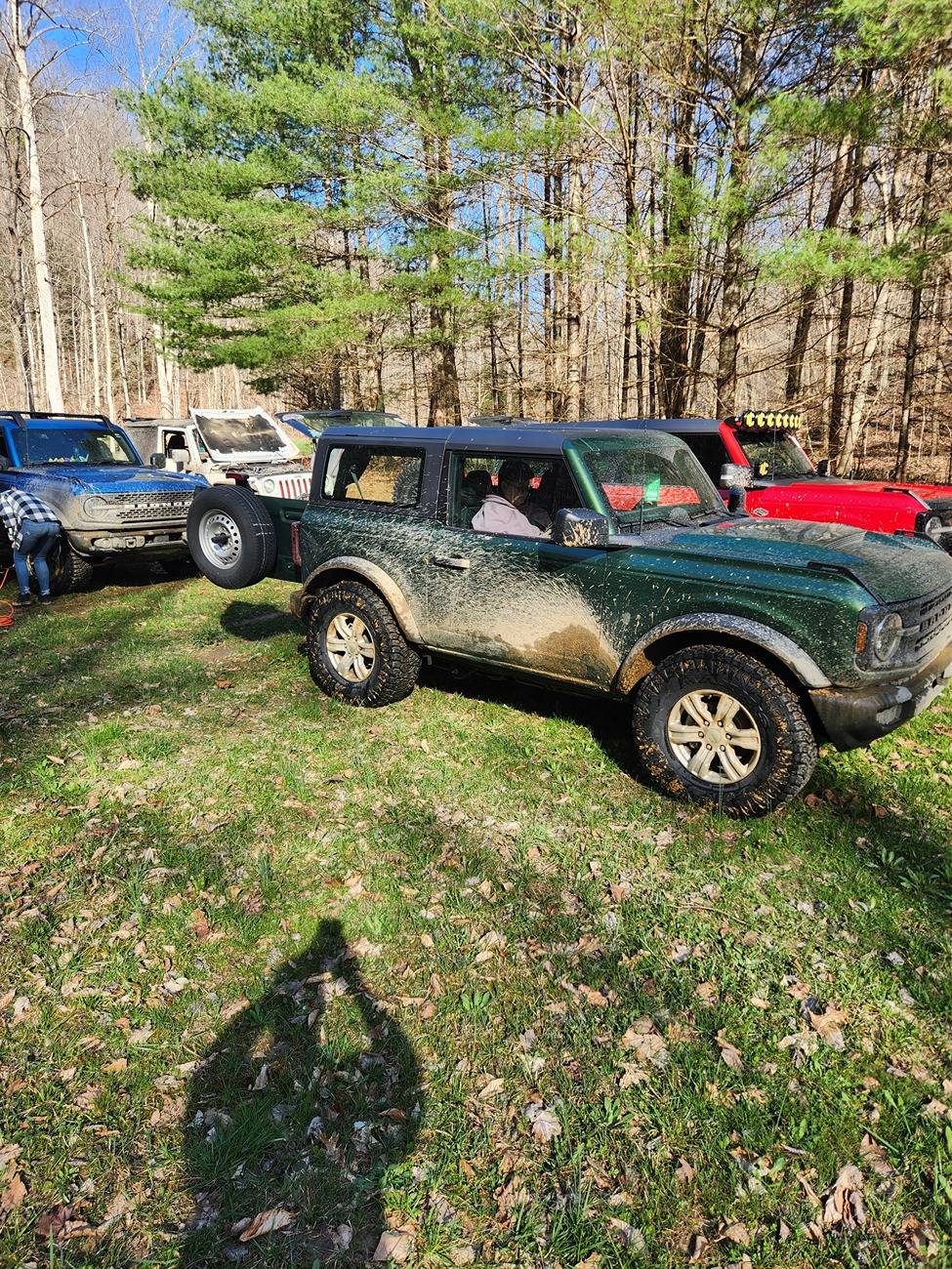

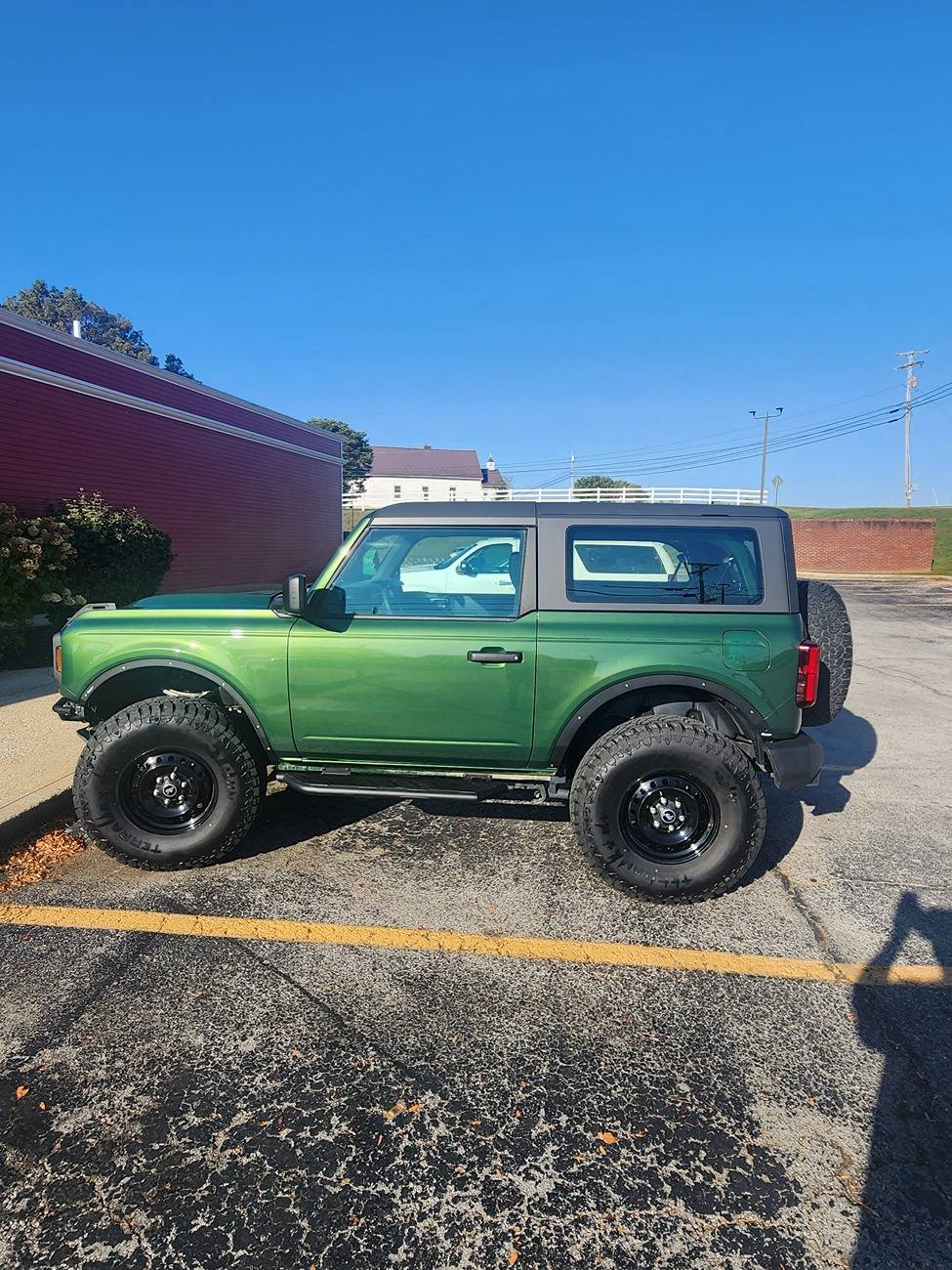

When you buy the cheapest Bronco Base 7 speed no boxes marked, add a 2" inch RC lift, 1.5" wheel spacer and 37 12.50 17 tire on steelies.
Tires are TerraMax RT
Ford Bronco The cheap Base Bronco build on 37's 1000000796
