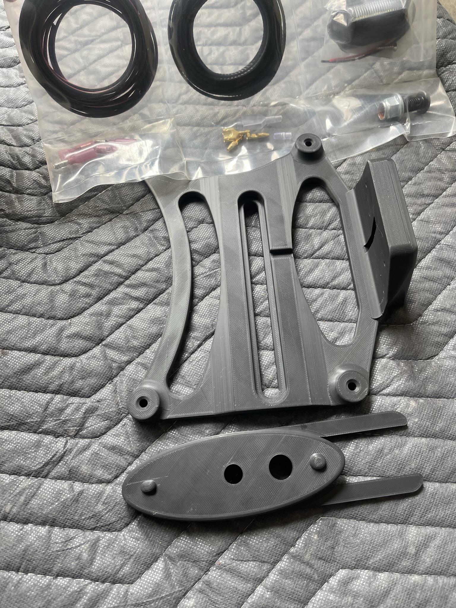

I just installed the Lobo Off-road Adjustable Tailgate License Plate Mount [forum link to product] and I’m pretty impressed. The fit and finish is pretty good considering it’s a 3D printed part using what Lobo is calling “UV stable filament”, only time will tell if it can handle my extreme Las Vegas sun and temperatures.
The cool part about the bracket is that it’s actually adjustable side to side, so you can make sure the plate is still visible even if your running large 37s. Overall the install went fairly smooth, it is a little laborious because you need to completely take apart the passenger side of your cargo area to slice in the led plate light to a factory harness (not difficult, just time consuming). The bracket mounts directly in place of the oval Ford emblem on the tailgate (never liked that emblem anyways).
You do need to drill 2 holes in that emblem location, one for the mounting bolt and one for wire passage. Drilling into the panel there didn’t bother me as it’s a spot that would normally be covered anyways. I think this will be a great solution to get my license plate higher up and away from the rocks while not getting in the way of taking off my spare tire like most other relocation brackets do. If you have a aftermarket rear bumper that doesn’t have a spot for a license plate this may be a bracket worth checking out.

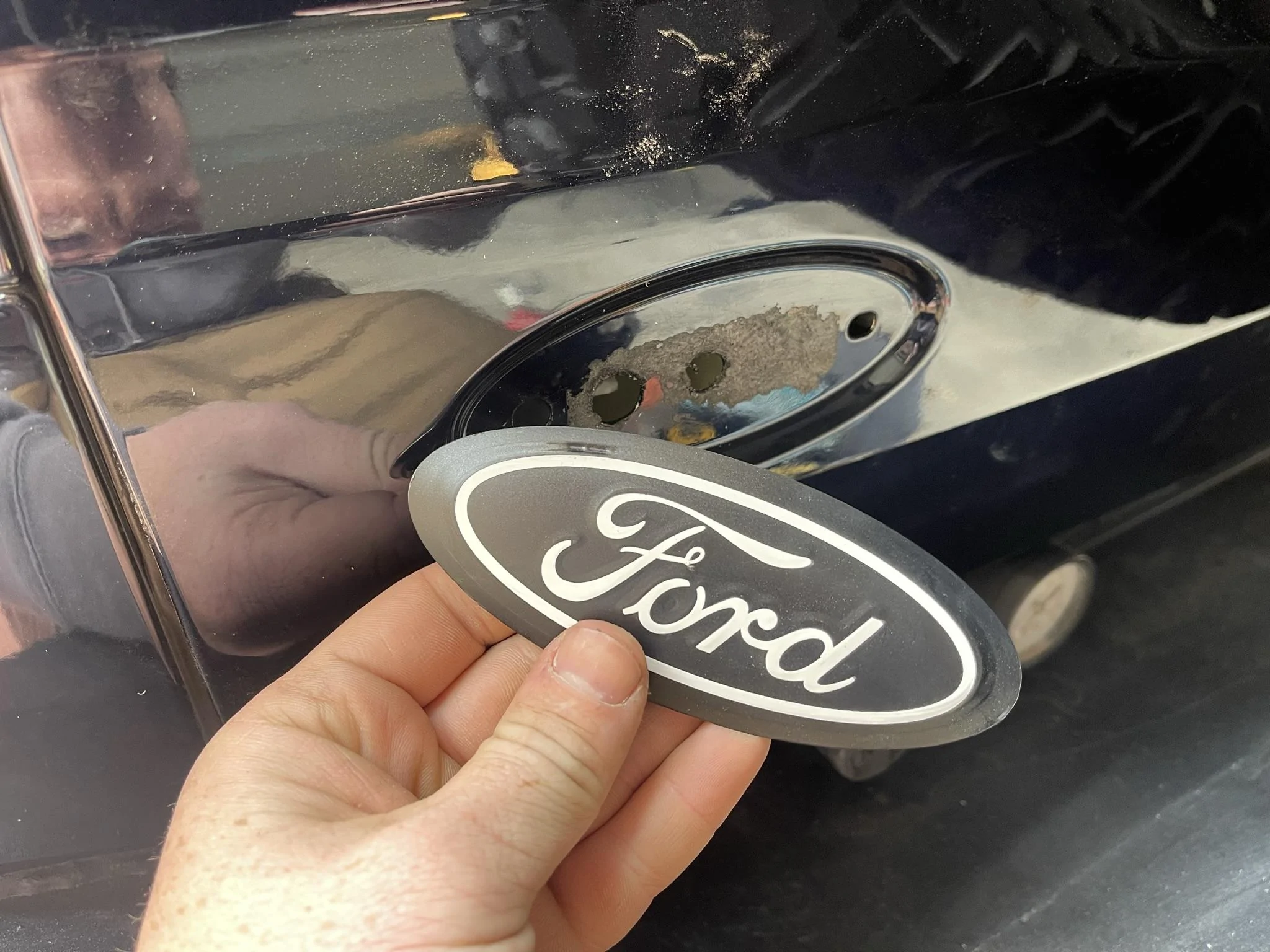

The factory emblem is held in with 2 clips and double sided tape.

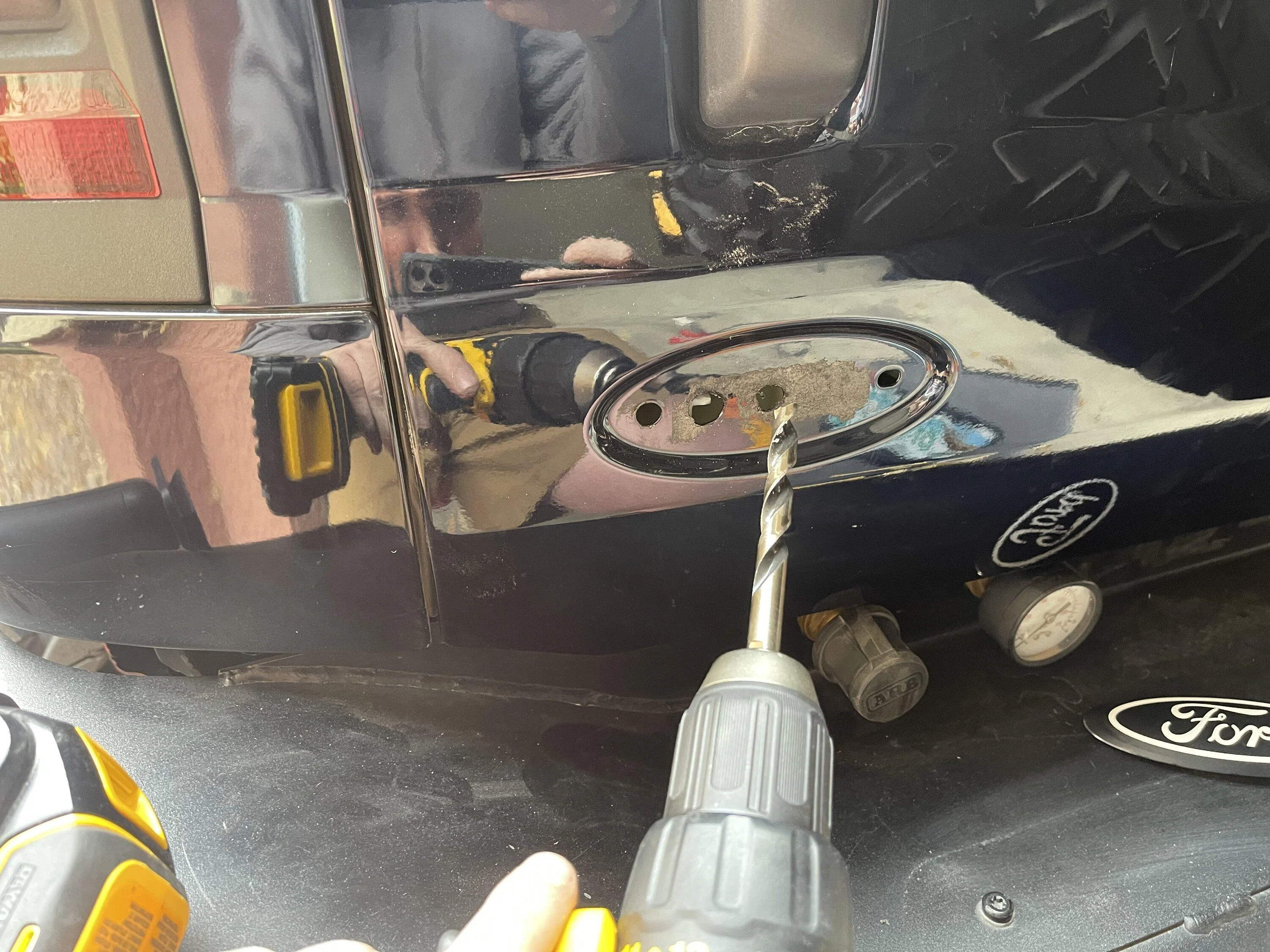

Use Lobo’s mount as a drill guide. Be sure it’s on with the ears facing the taillight

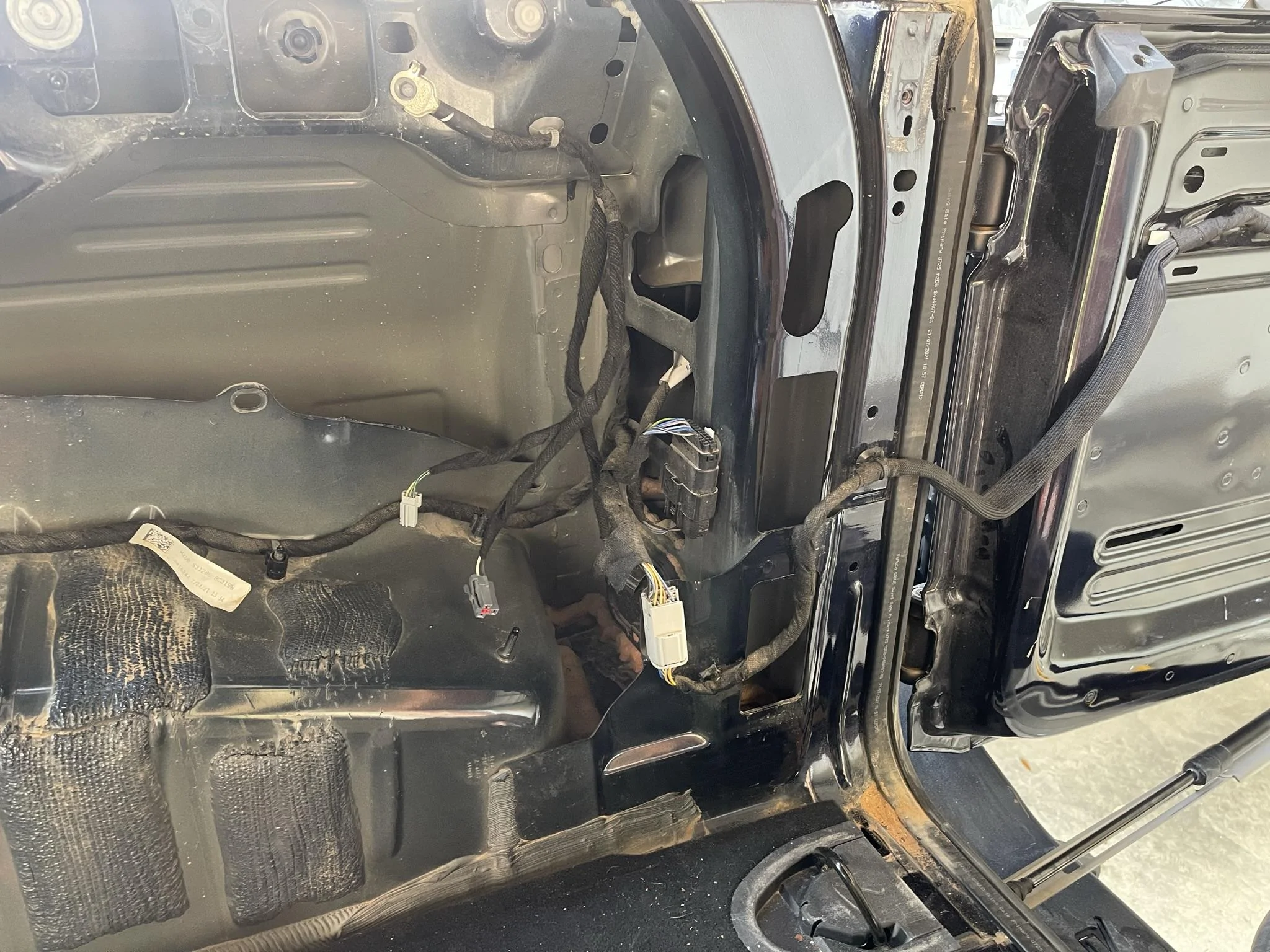

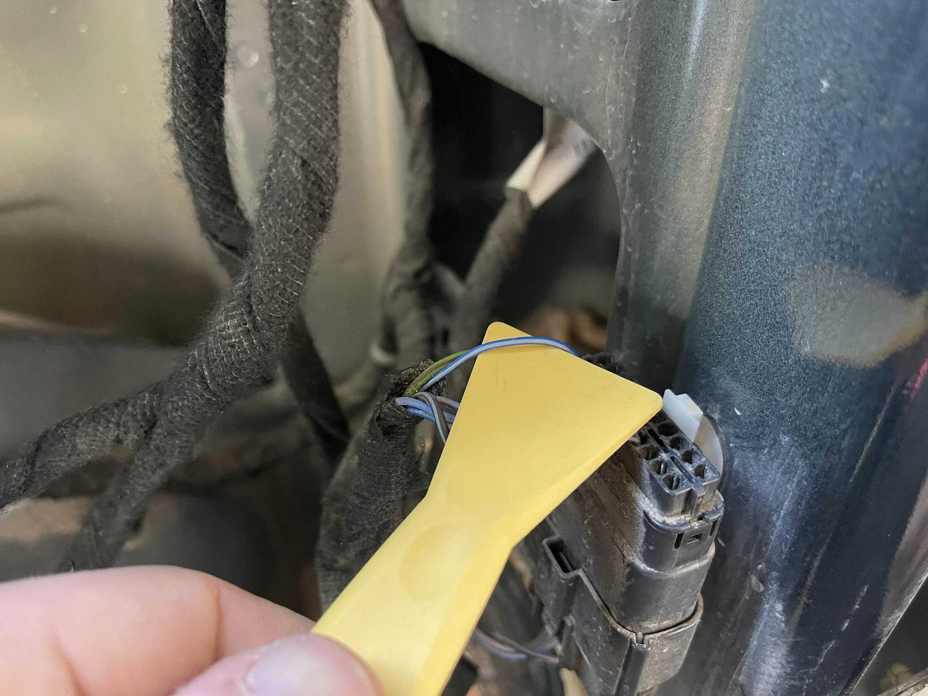

You’re looking for the larger black connector on the back of the
Ford Bronco The perfect Bronco license plate mount? - Lobo Off-Road Adjustable Rear License Plate Mount -- Install DIY Guide & Review 76550DD0-75A7-4BC5-8F88-99655B96DCF9
Splice into the BLUE wire with the GRAY STRIPE. Then run the extension wire along with the factory wires into the tailgate and to the emblem location

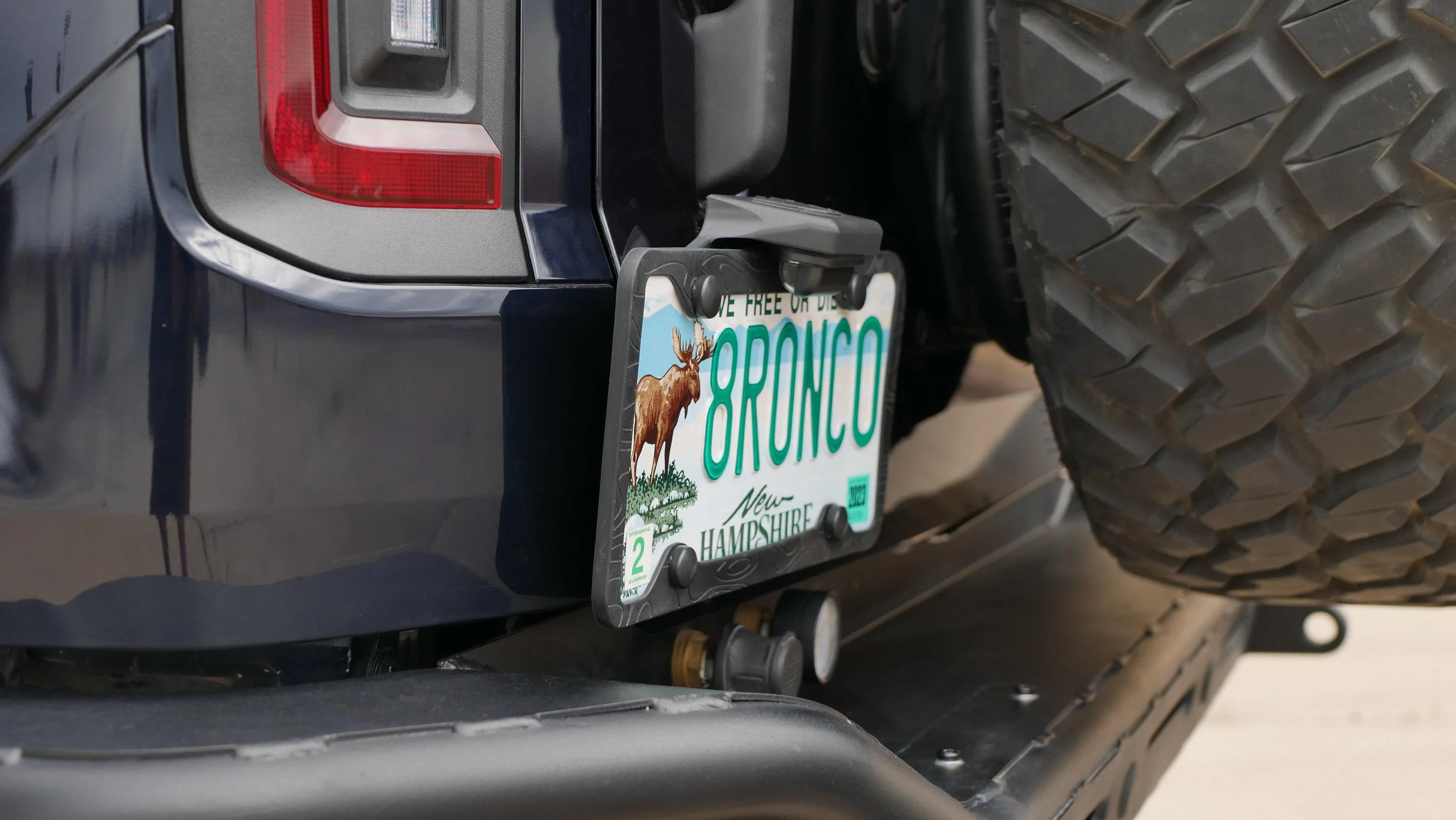

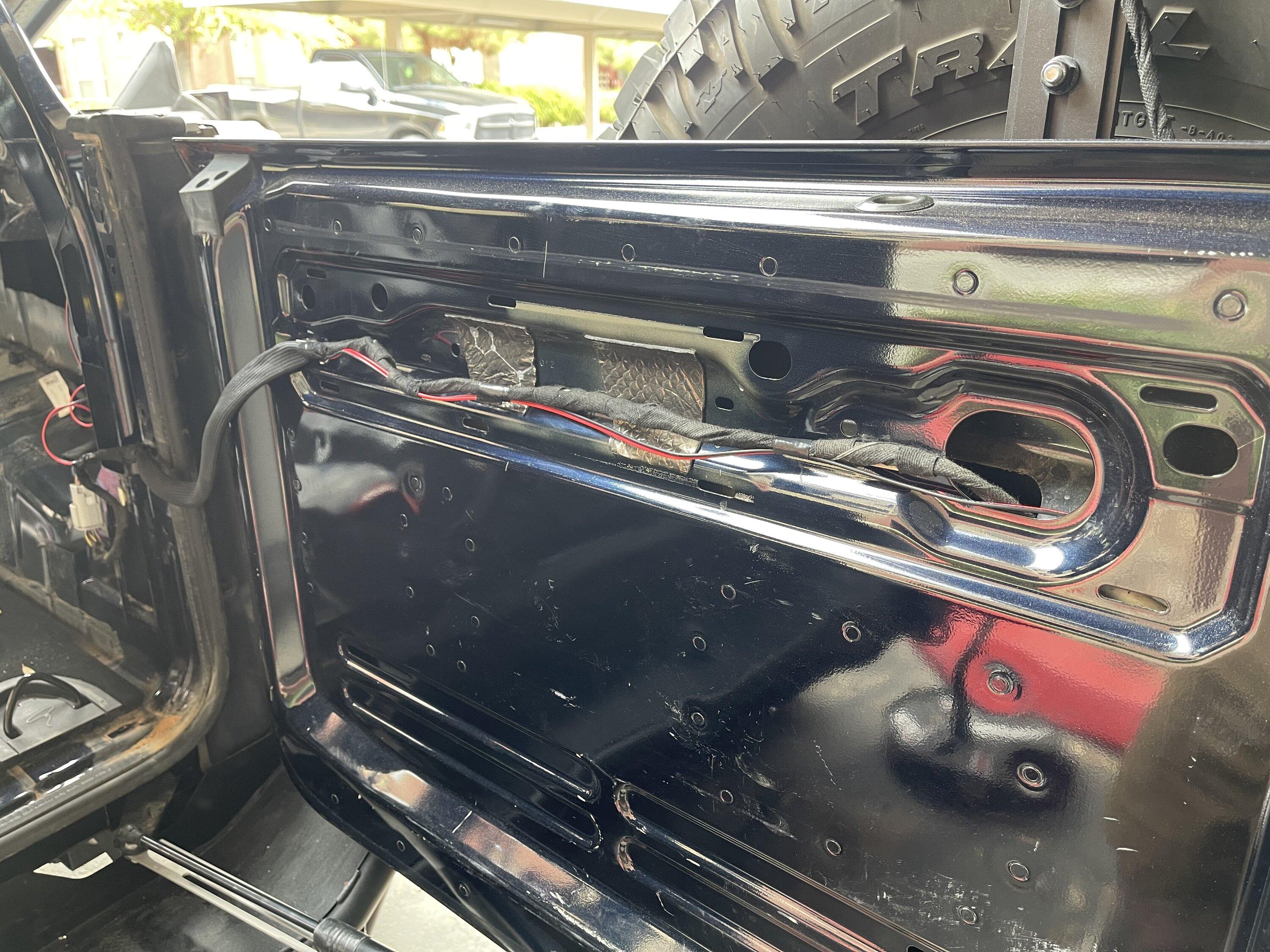

Finish the wire job and bolt it in.

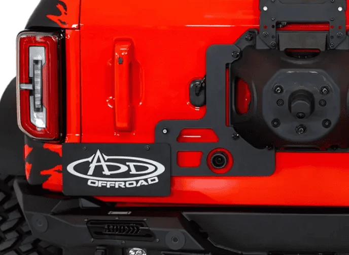

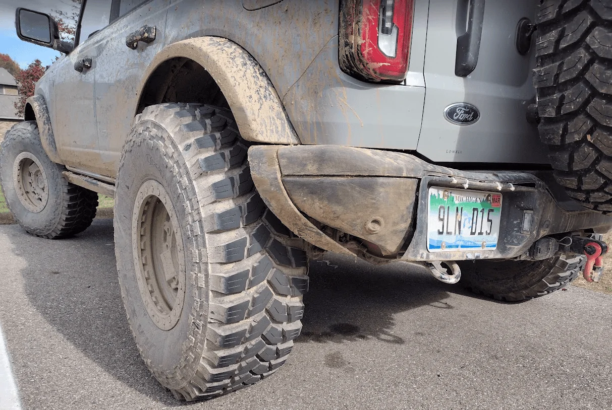

ADD's solution that comes with their Stealth Fighter Rear Bumper is much better. Not sure why they don't sell it stand alone... You would just have to come up with a lighting solution (because they re-purpose the factory light and integrate it into their bumper). No drilling, no taking the Ford badge off, fully reversible.

DV8 seems to make what you want, comes with a light also.
https://dv8offroad.com/collections/...-bronco-rear-license-plate-relocation-bracket

Cool option. But my idea was to not add anymore weight and I bet thats decently heavy just for a license plate. It not adjustable and Im curious if it rattles or flops on more aggressive driving being that it’s basically hanging way out from the mounting location. I still like that option over mounting to the spare tire though. The lobo option is also totally reversible, just put the badge back on and it covers the new holes.
