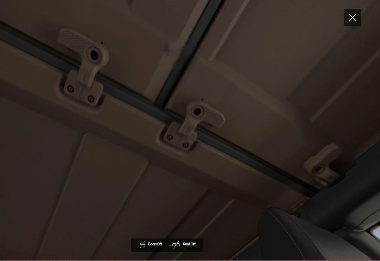

Nope, sadly - Front panels latch to the rear section...from the B&P 360 view above the driver's seat -

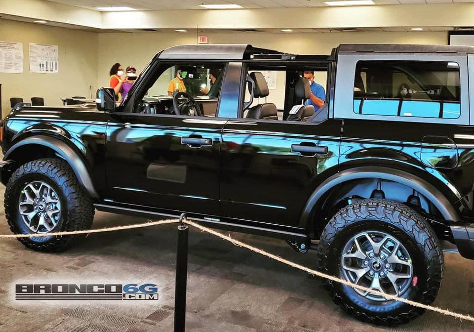

Ford Bronco Three-piece top question 1616558030305
don’t know if these are just sitting there or not... but they have side latches on the front two panels, so I think it would still be secure. There are also pics with just the front panels on a two door out there somewhere.
