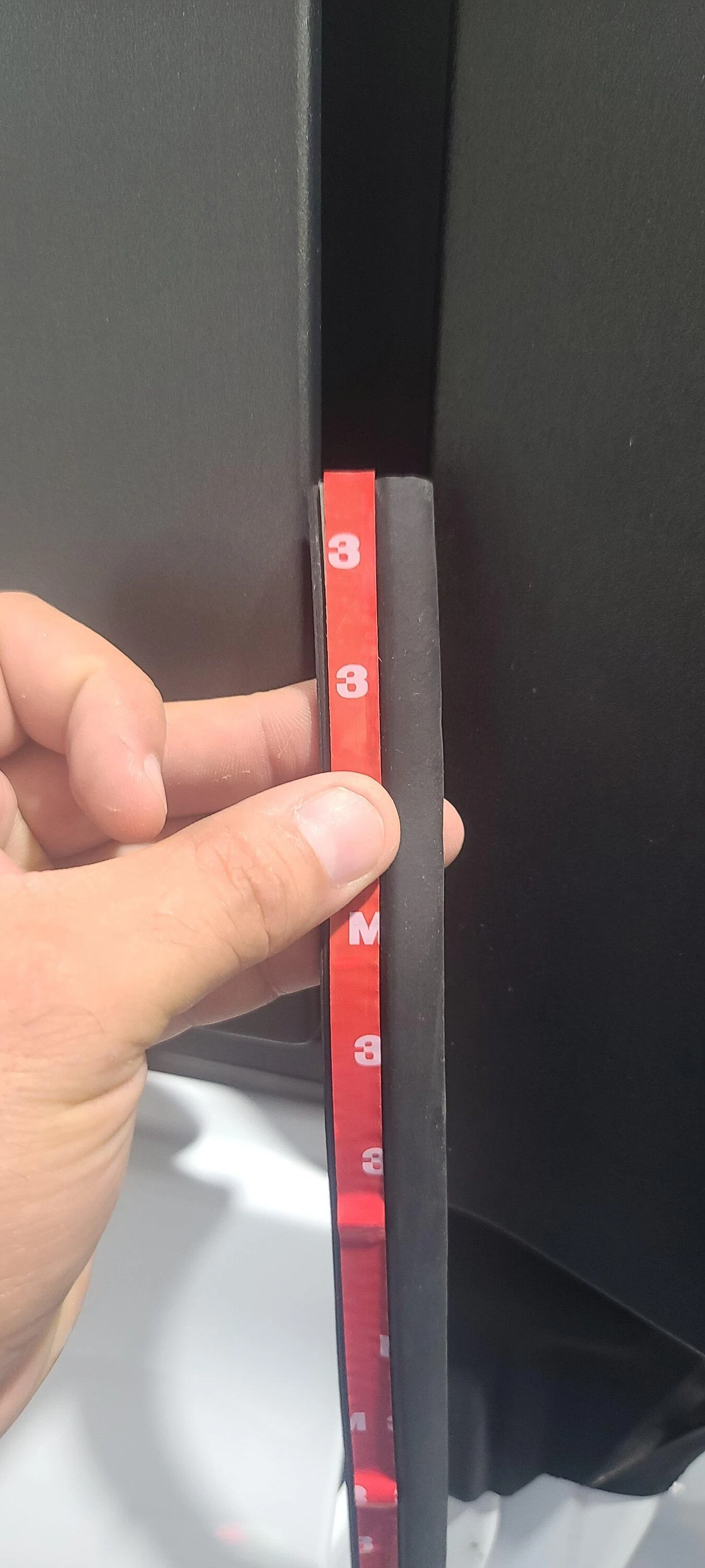

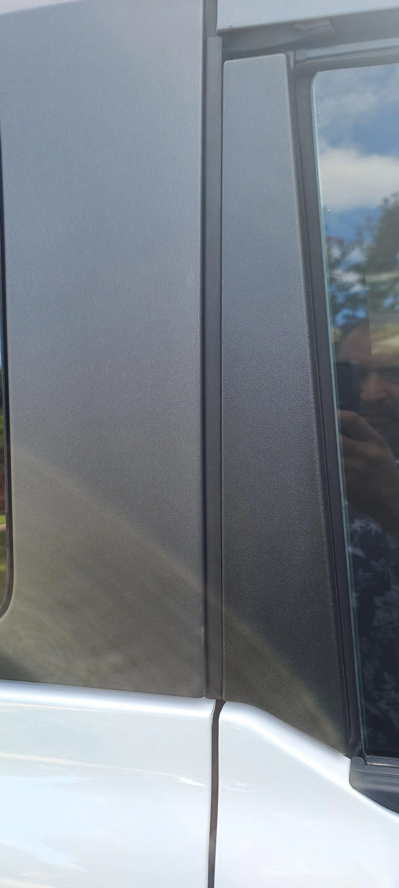

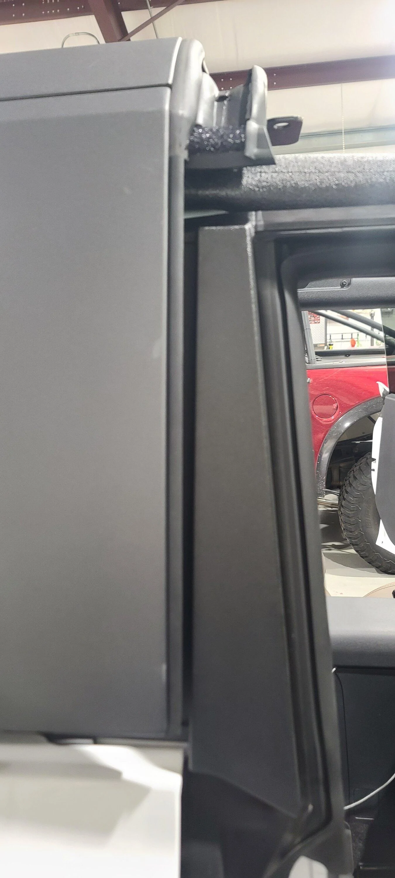

Last update... added some weatherstripping on the hardtop, it knocked out the wind noise coming from the b pillar. Adding rhe roof rack brought a lot of noise back lol
Do you mind sharing a link to the specific weather strip that you used?

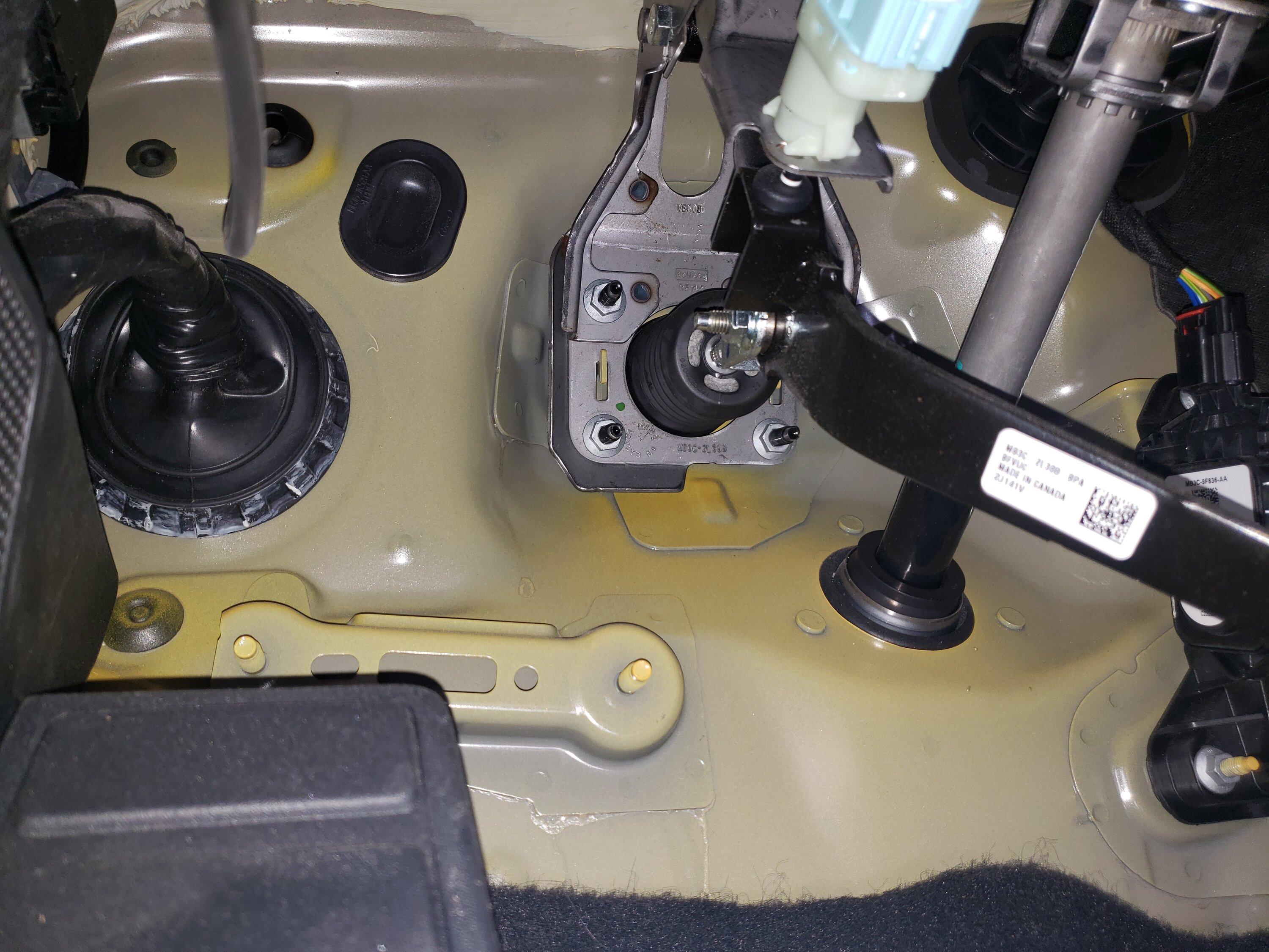

I want to tackle this project myself for my 4-door OBX. Part of my issue are noises from the engine bay. Mostly injector noise from the drivers side, and an odd resonating noise from the passenger side (only occasionally). So I wanted to start with putting the butyl and foam in the foot well areas that aren't covered. I see the passenger side has some kind of padding though.
Ford Bronco Time to lower the road noise / NVH sound level - my DIY sound deadening material install project 20230517_114137
I believe i can cover most of the metal here with no issues.
Ford Bronco Time to lower the road noise / NVH sound level - my DIY sound deadening material install project 20230517_114223
I just have to remove this loose molded padding and I can slap some butle and foam under the passenger side as well. Hopefully that will stop the resonating noise I hear occasionally.
Any thoughts on these 2 areas?
Thanks!

adding material to these bare areas should help, please post up your results!

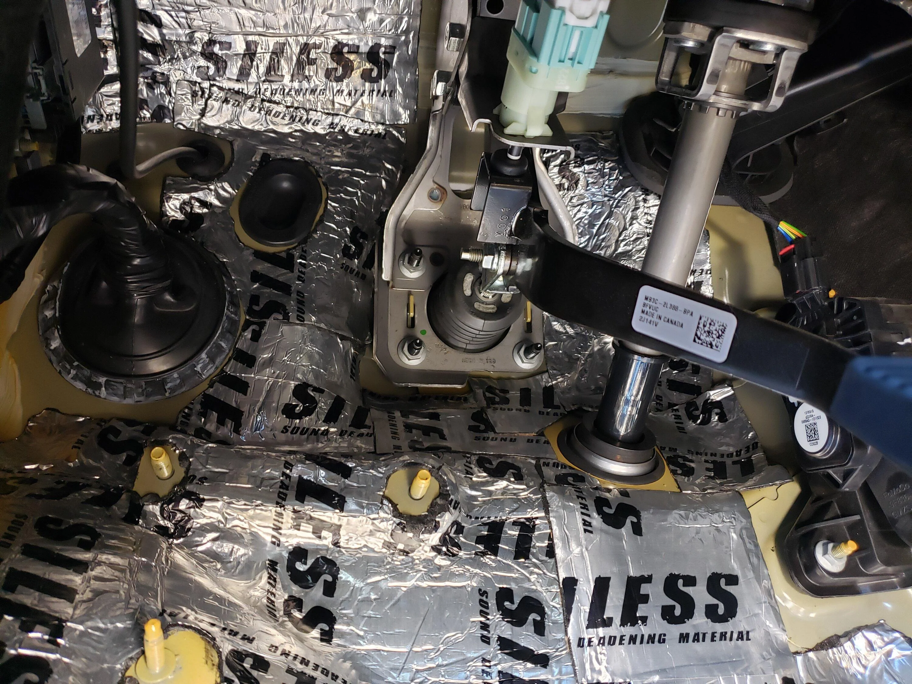

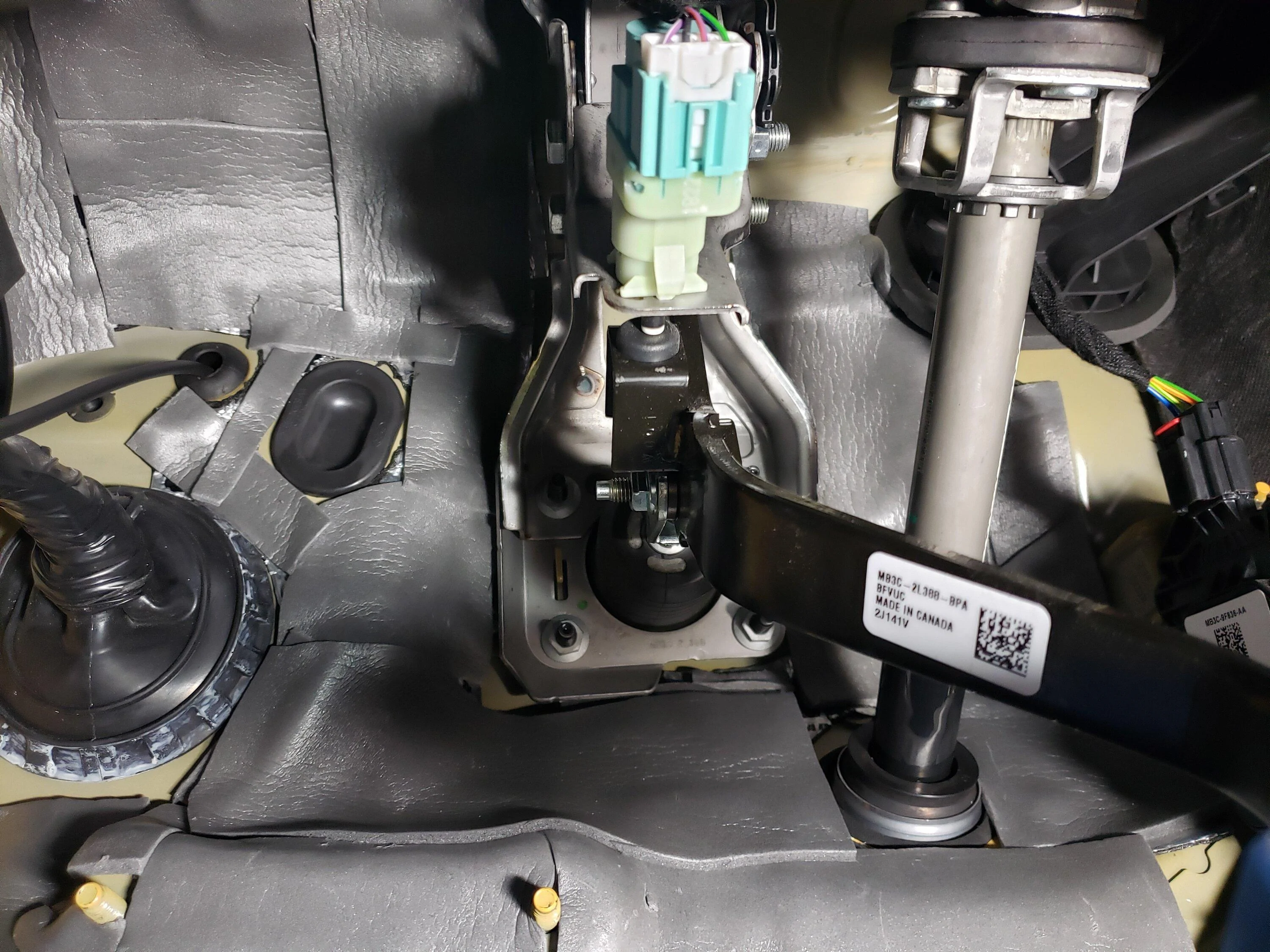

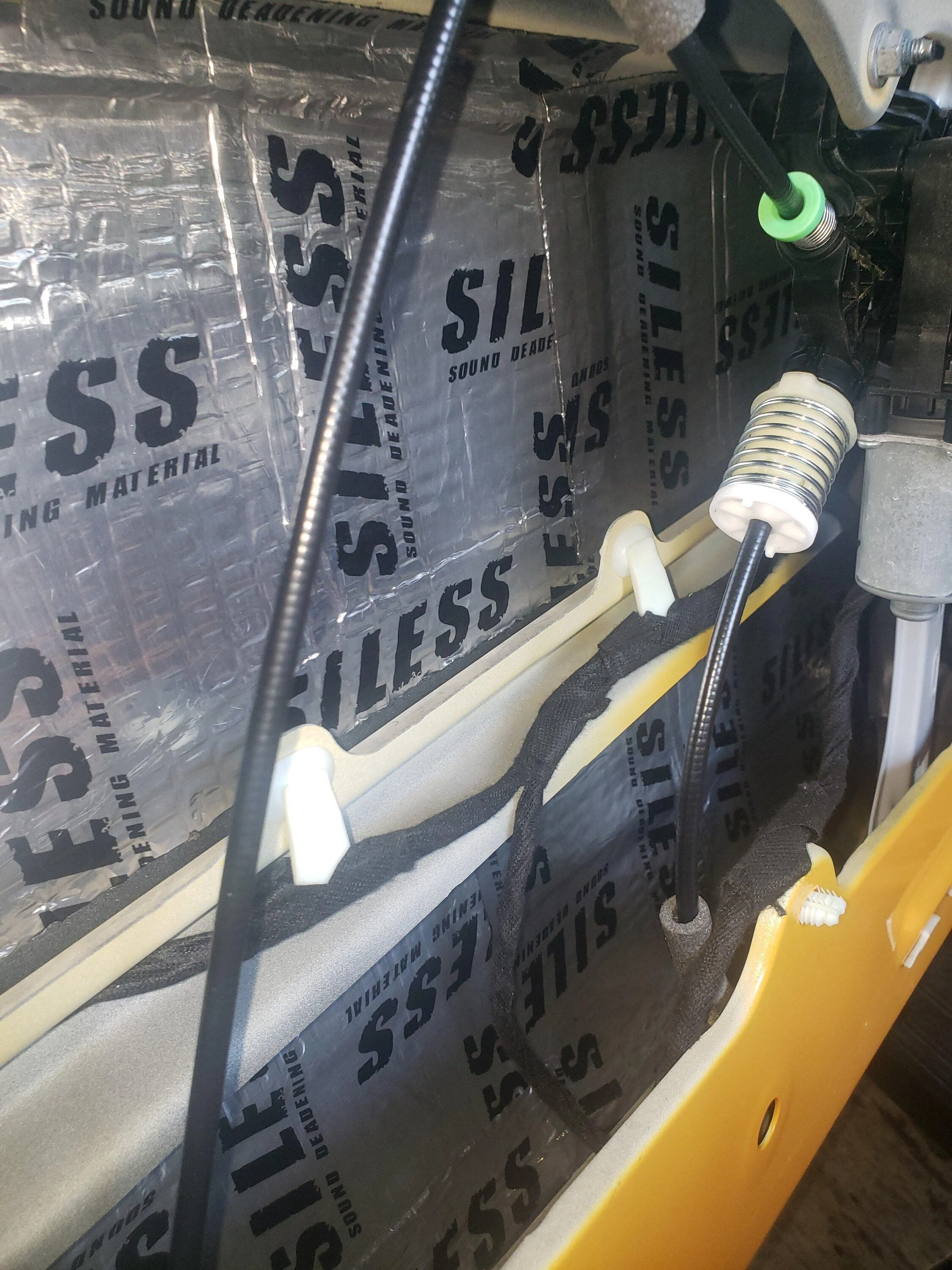

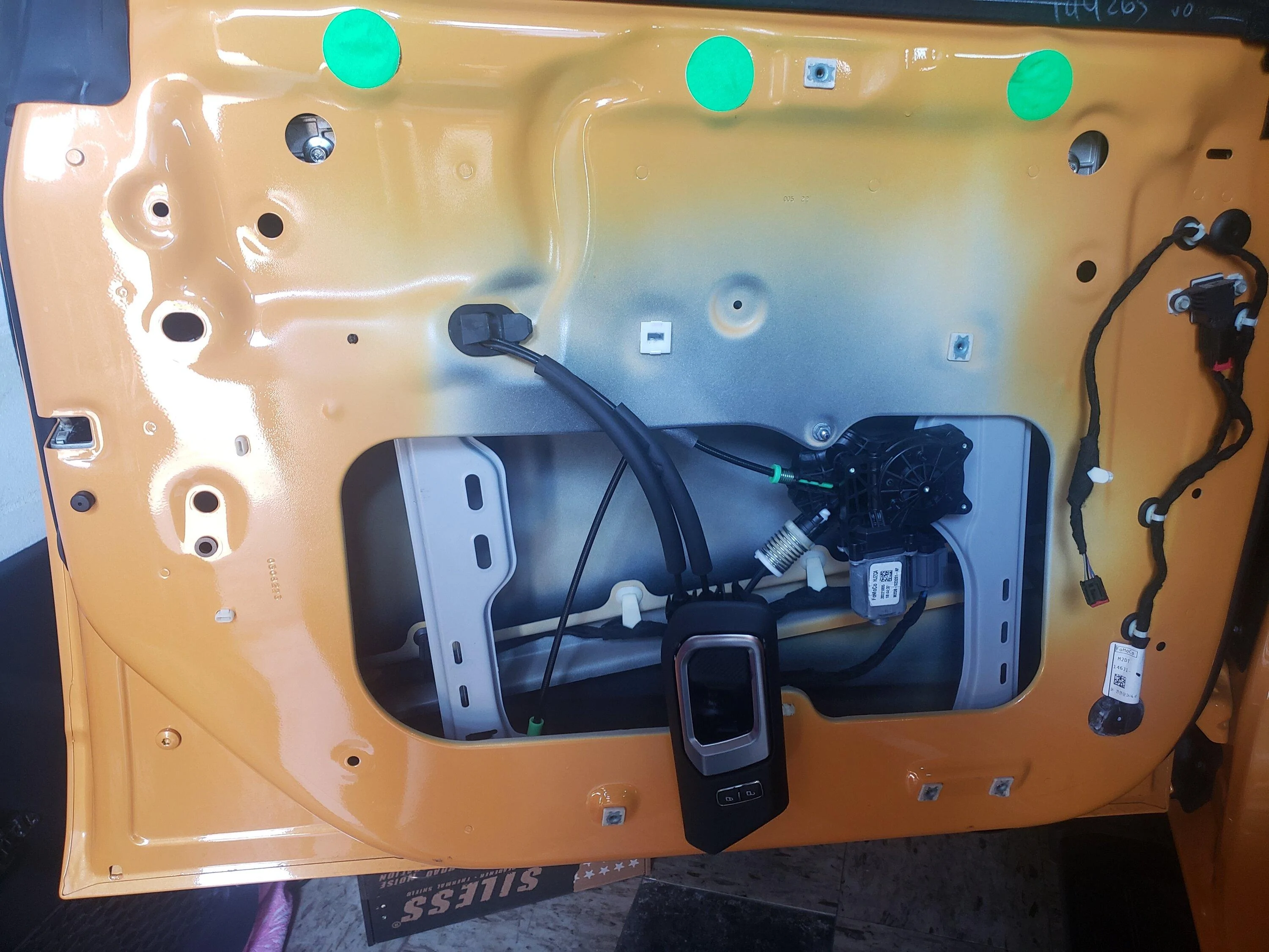

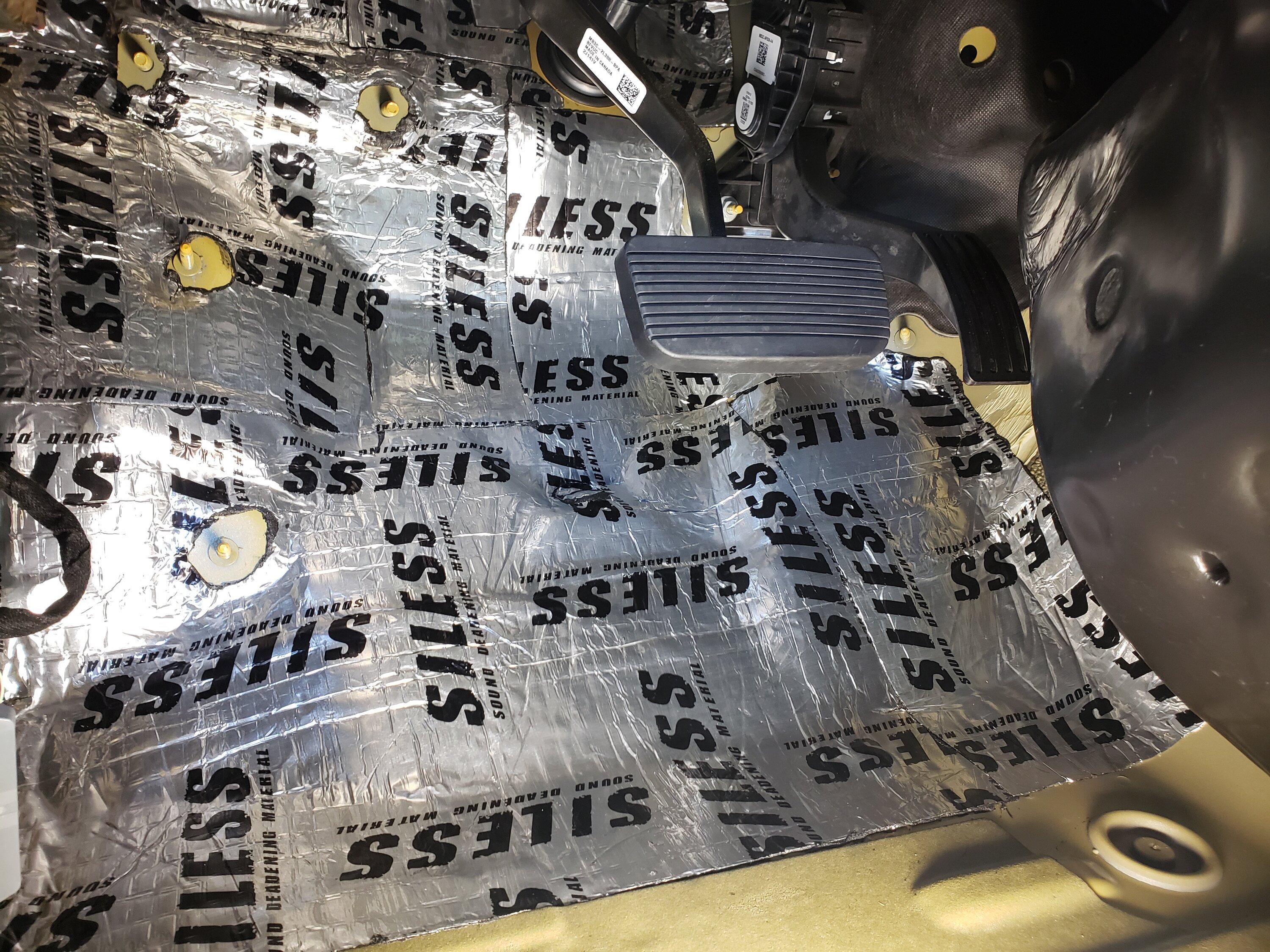

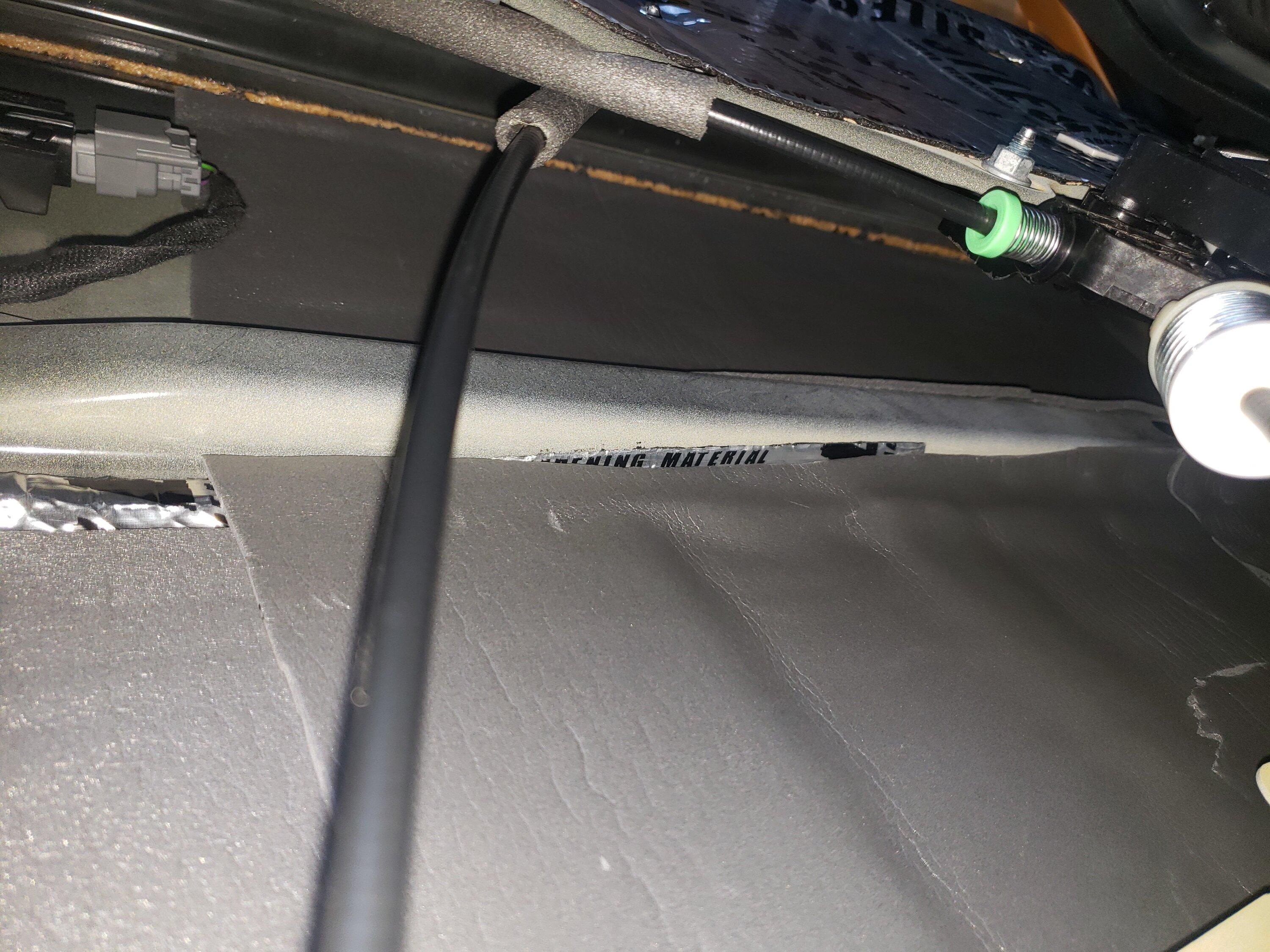

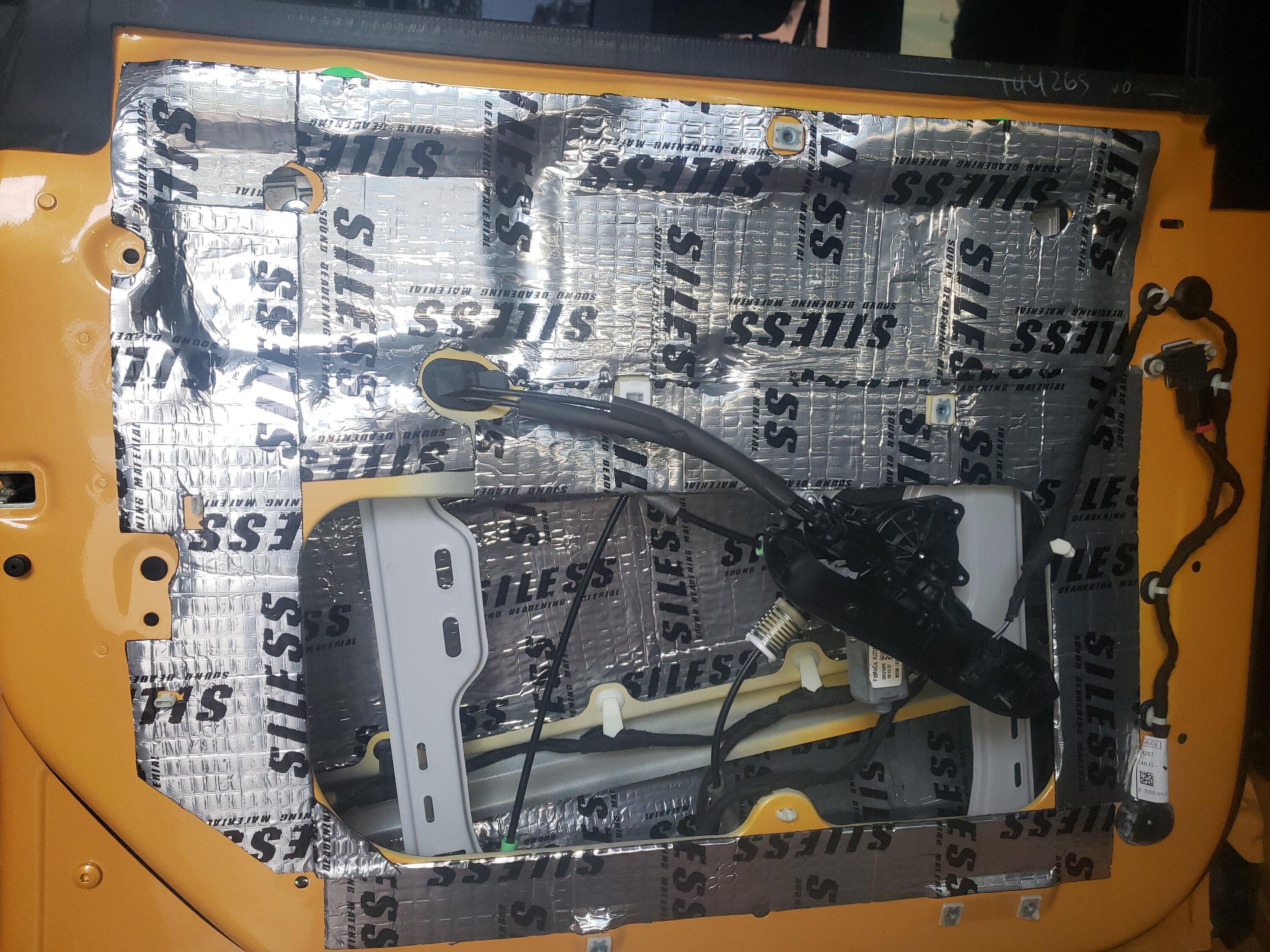

I wanted to post my first attempt at this. Keep in kind I've never tried sound deadening before. I took it slow and tried not to damage anything or cover up things that might be important. I started with the drivers side footwell. I was trying to reduce engine noise coming into the cabin but I don't think it worked haha. I will try to add materials behind the center console and also the passengers side to see if covering everything helps. So here are some photos of the drivers side. It started out well, but man its really difficult to get pieces up under the dash and behind the pedals etc. I can see why no one does it haha.
Ford Bronco Time to lower the road noise / NVH sound level - my DIY sound deadening material install project 20230606_114127
Ford Bronco Time to lower the road noise / NVH sound level - my DIY sound deadening material install project 20230606_114134

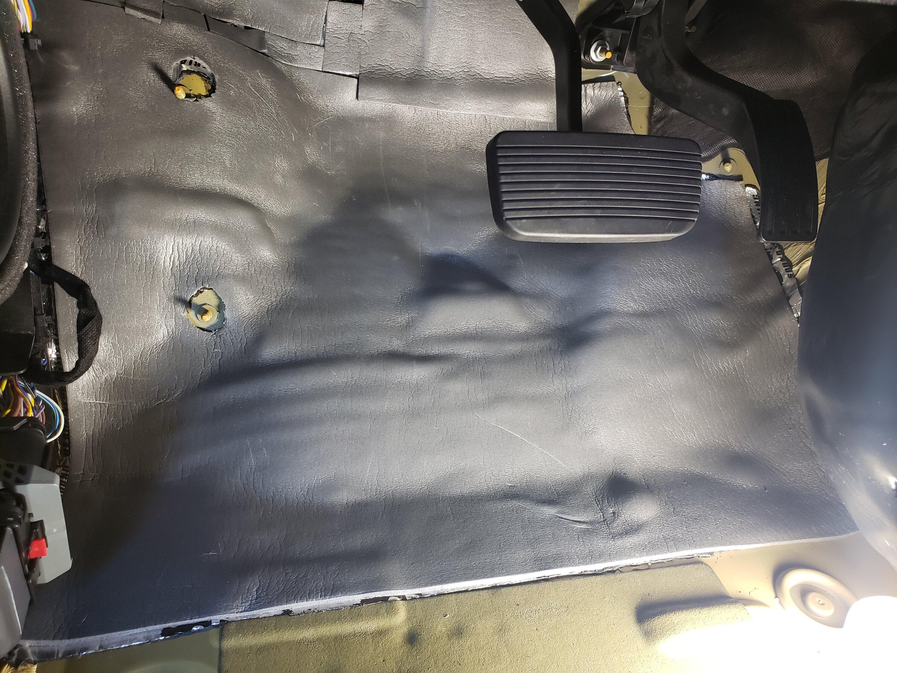

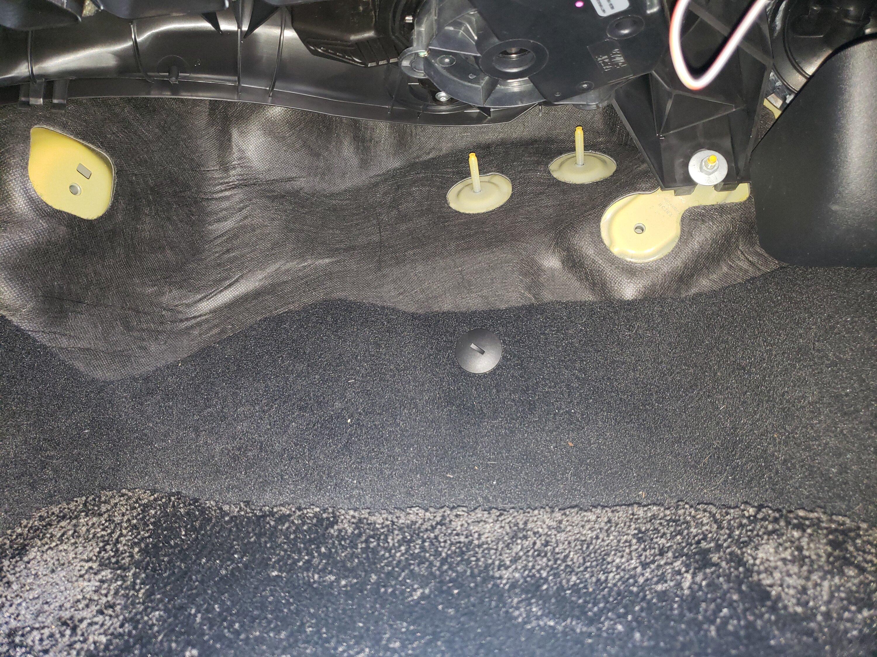

Next I added Siless PE foam. It started out well, but once I got to the tight spaces, it become quite difficult. The backing is incredibly sticky and it basically adheres the second it touches anything. So it doesn't look that great, but you can't see it unless you crawl under the dash.
Ford Bronco Time to lower the road noise / NVH sound level - my DIY sound deadening material install project 20230606_121235
Ford Bronco Time to lower the road noise / NVH sound level - my DIY sound deadening material install project 20230606_124306

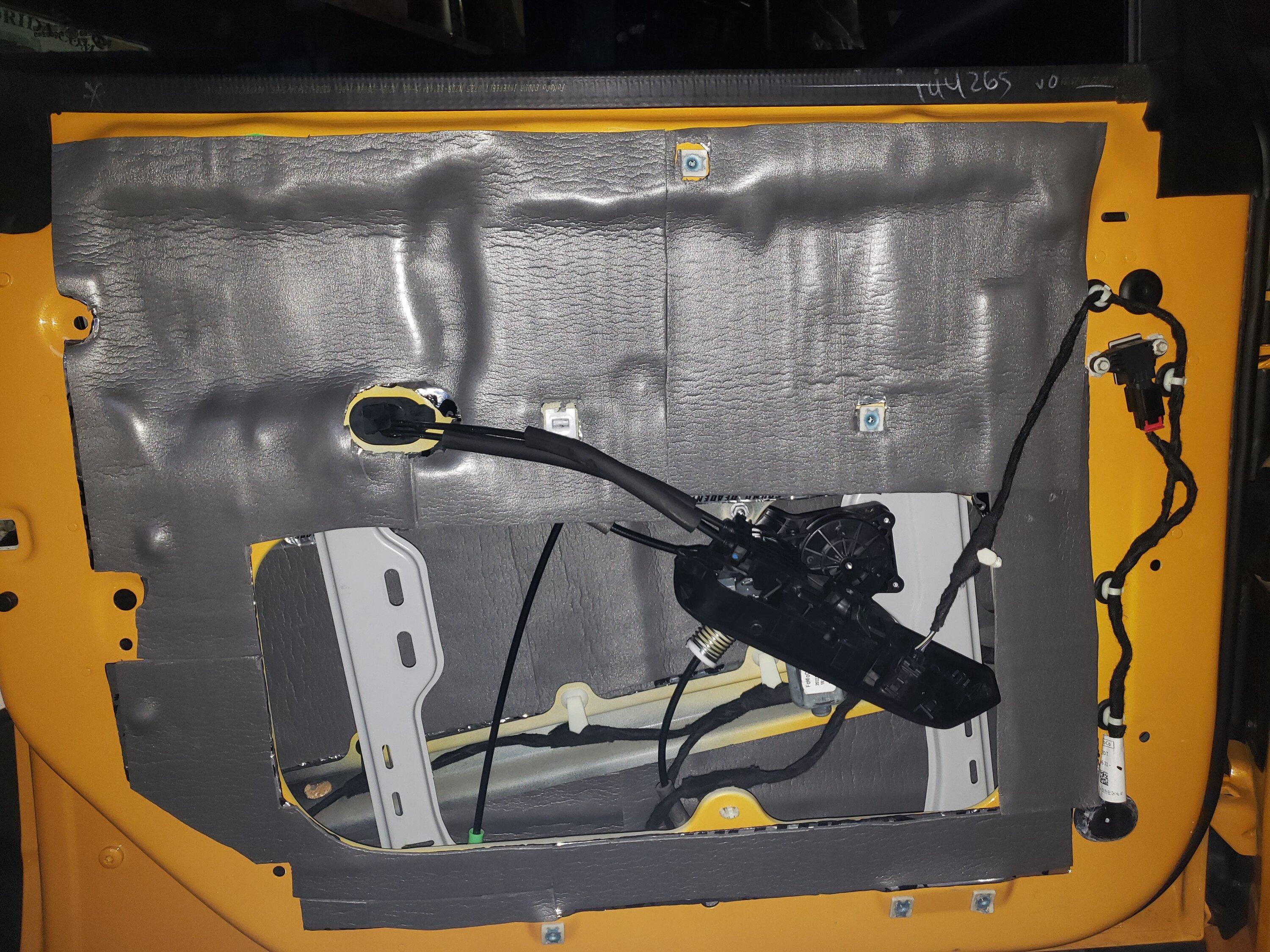

Later in the day I was able to do the drivers side door. Now that I can definitely tell a big difference. The door feels really solid, and most likely blocks a lot of noise. As an FYI my driver side doors where replaced. 85/yo slammed into me 2 weeks after purchase. I noticed the transparent plastic cover is missing from the inner door. I put both materials on the inside and outside of the door. I might even put some foam on the backside of the door panel.
Ford Bronco Time to lower the road noise / NVH sound level - my DIY sound deadening material install project 20230606_181749
Ford Bronco Time to lower the road noise / NVH sound level - my DIY sound deadening material install project 20230606_185946
Ford Bronco Time to lower the road noise / NVH sound level - my DIY sound deadening material install project 20230606_193901
Ford Bronco Time to lower the road noise / NVH sound level - my DIY sound deadening material install project 20230606_200959
Ford Bronco Time to lower the road noise / NVH sound level - my DIY sound deadening material install project 20230606_202920
Not bad for my first time doing this. As you can see not everything looks perfect etc, but nothing important is obstructed and everything fits bat perfectly. I'm really looking forward to doing the other 3 doors, and eventually the entire floor and rear cargo area!
