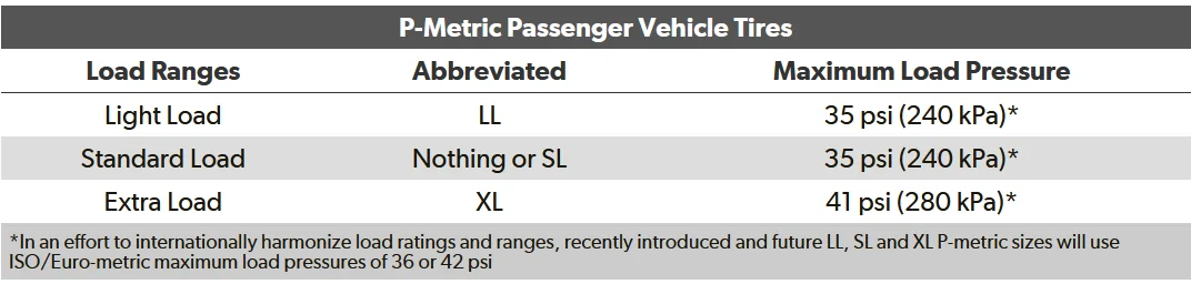

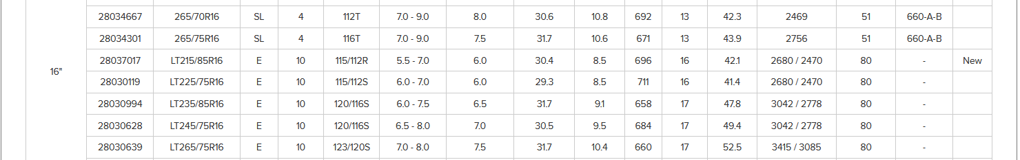

Next, head on over to tiresize.com, tons of tools and listings to learn. In your 265/75 R16 size you will see there are the following number of tires by load ratings, use the filters and play about with it.
https://tiresize.com/tiresizes/265-75R16.htm
Ford Bronco Tire load rating 265 75 16 tires
Next, here are some tables to show you the different types of load ratings, see this link for more information.

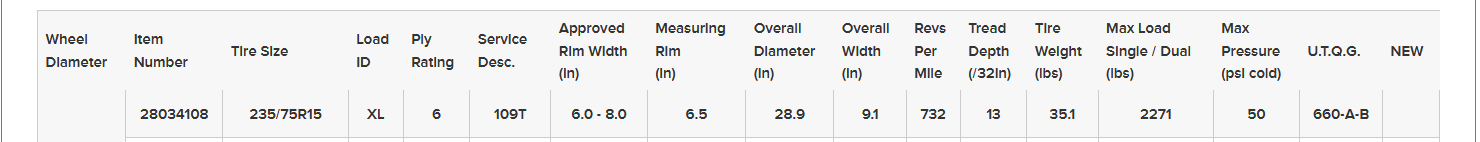

How to Read Speed Rating, Load Index & Service
Ford Bronco Tire load rating SL load rati
Ford Bronco Tire load rating LT load rati
Falken examples for the Service Description number, 113, 116, etc.
