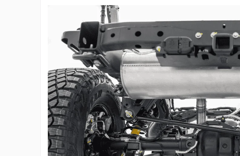

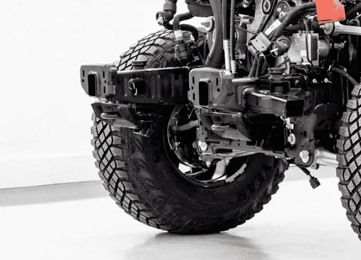

The chassis pic shows a bunch of extra hardware associated with the front tow loops, as compared to the simple bolt-on loops on the rear. Maybe the front loops pull out for use, then you can shove them back out of the way when not hooked up?
If this is the case, will the front loops be prone to damage if used for a vertical lift point?

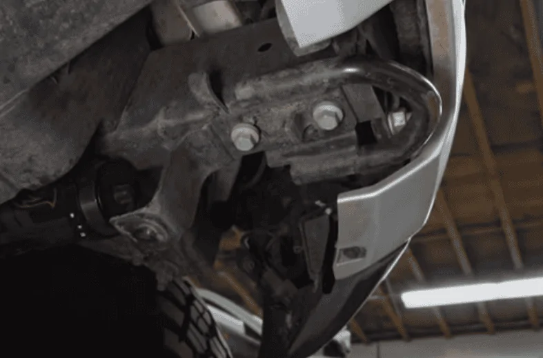

For comparison, Ranger front loops are simple bolt-on design.

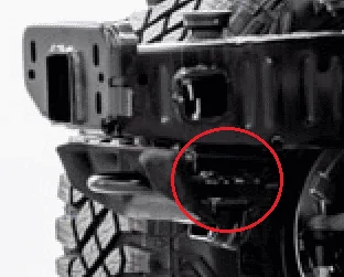

Thanks, NoDoors....... but it was all the stuff in highlighted in the red circle here, below the Bronco's box frame, that I was curious about.

Hmm interesting, I thought you were talking about the plastic piece to the left of the red circle. I'm not sure what that is, maybe bumper mound hardware? Who knows. I doubt it would be some crazy way to attach tow hooks. That seems like from a production and materials engineering standpoint, something overdesigned for no reason that increases material use and complexity. I'm sure the front hooks mount normally with come vertical bolts.

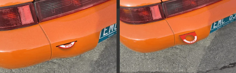

Retractable tow loops are a "thing" nowadays in the race car world. It would be interesting if that's what's also going on with that attachment box on the Bronco.
