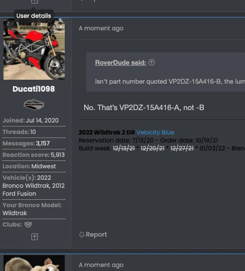

Isn't part number quoted VP2DZ-15A416-B, the lumen 4/ 7 pin kit?
Ie, you still have to run the wires up to the connectors in the drivers wheel well.
Which never made sense to me, because the tow module (in rear cargo panel) creates most of those wires that go to back to the hitch.
A lot of extra wire going back and forth in my opinion.

VP2DZ-15A416-A is the lumen 4/7-pin kit that's used to retrofit 2021-2023 model year Broncos.
This DIO part is VP2DZ-15A416-B.
