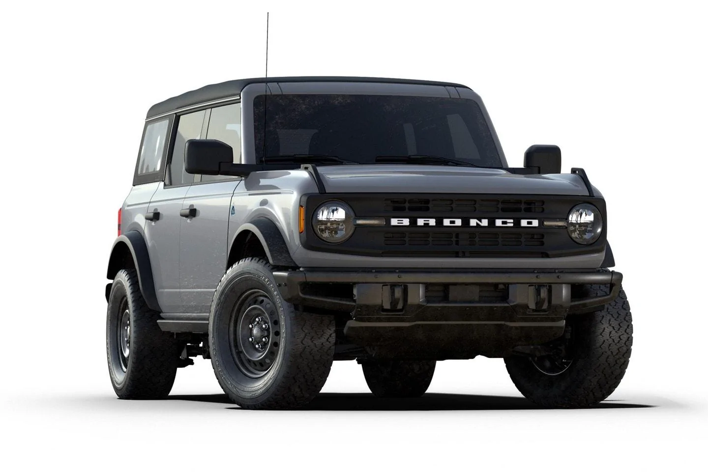

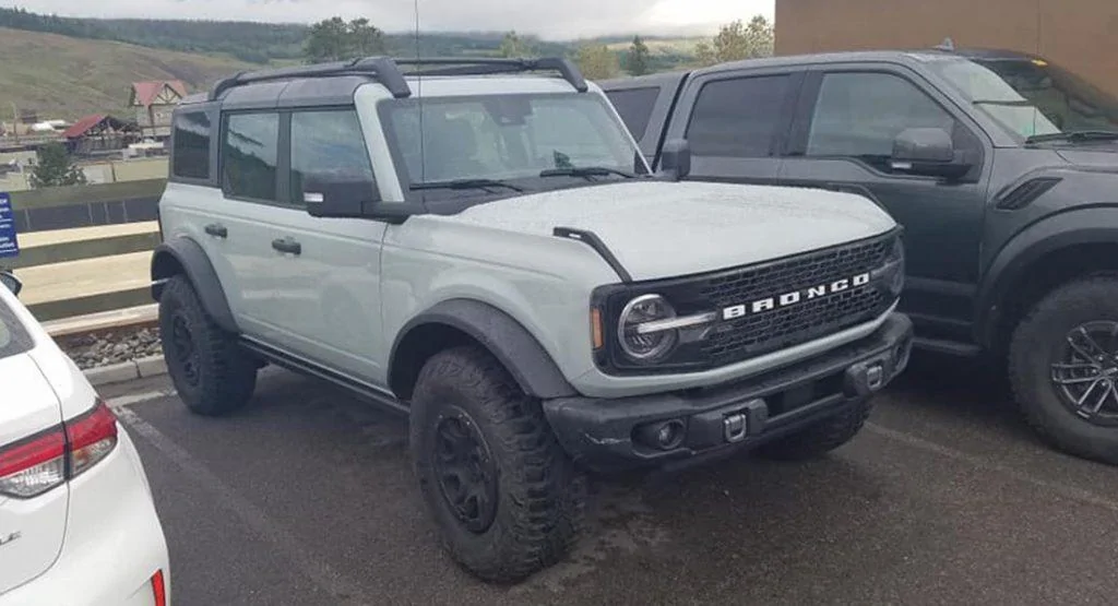

Are all the front tow points on the Bronco the same or varies by trim? I recall seeing some pictures of shackles but some without and more of a ”solid” mounting point.
Can someone clarify this? Thanks

It doesn't vary by modular bumper vs. standard bumper? Some pictures I saw online show a difference. But maybe it was a very early pre-production.
Ford Bronco Tow Shackle size. cq5dam.web.1440.1440
Ford Bronco Tow Shackle size. Ford-Bronco-7b-1024x555
Actually they are the same, just shackles mounted to the lower one, and the bare mount on the modular bumper.
The second bumper is the "capable" version and is not offered for MY21. It has built-in shackles rather than shackle mounts.
I believe the non-HD bumper has tow loops rather than shackle mounts
That's a good point, looking at the photo's in the B&P no shackles are shown, but we all know how relieable the B&P is.
Just did an image search here. No shackle mounts on the standard bumper, only tow loops.

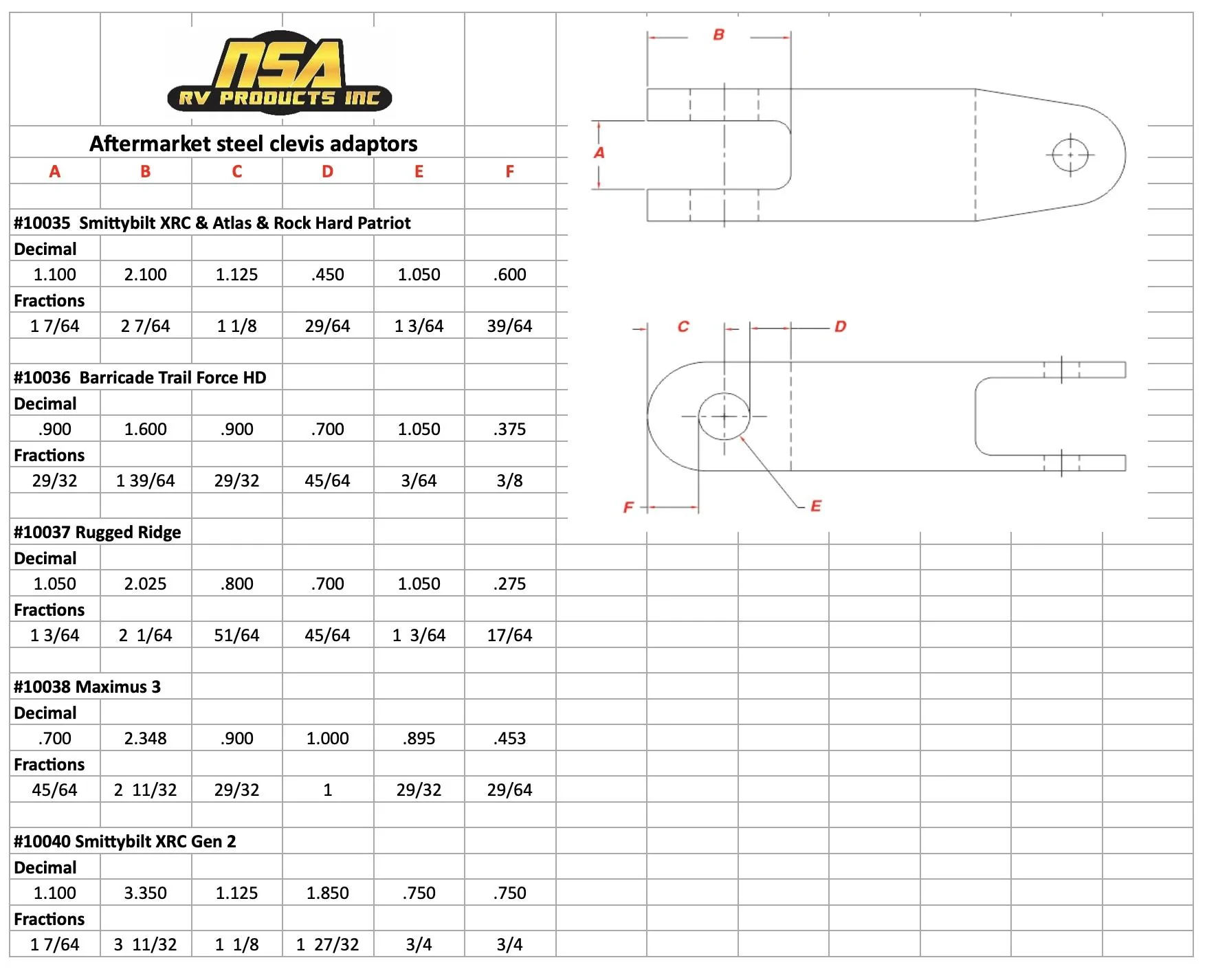

Here are the standards for a couple of main off road company's.
Ford Bronco Tow Shackle size. Screen Shot 2021-04-26 at 16.41.24
