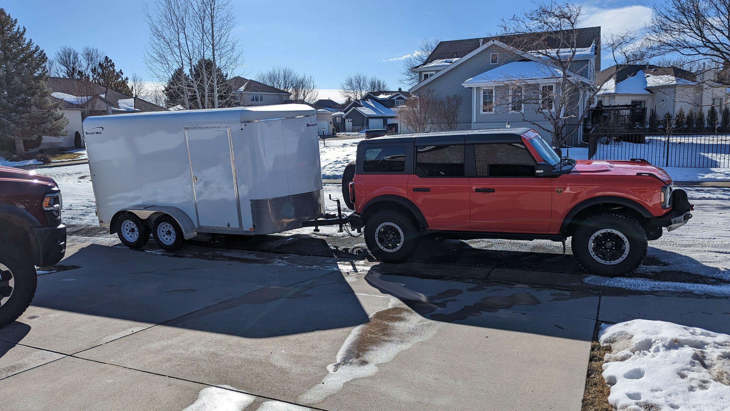

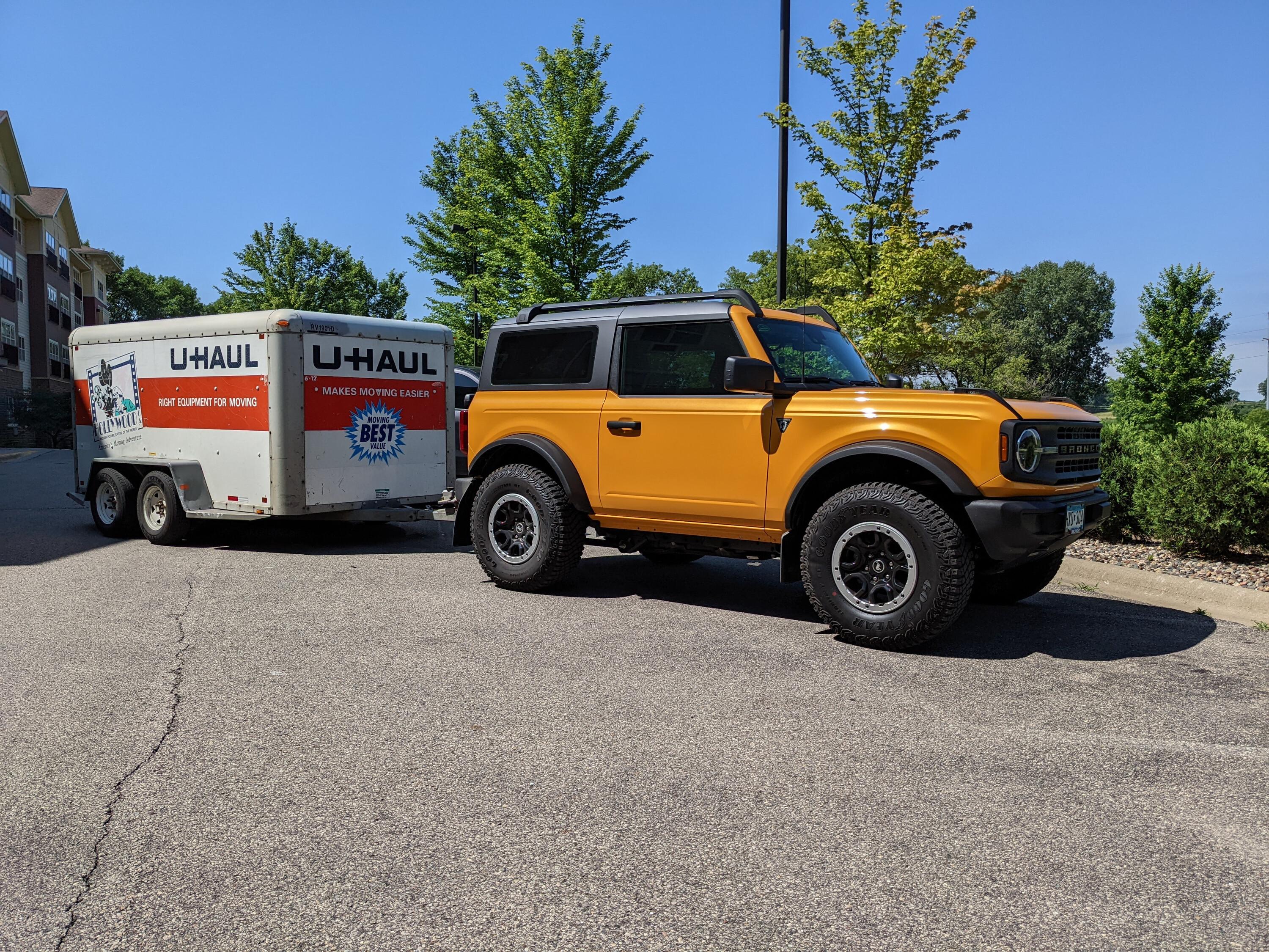

Figured I'd test out the Bronco with a 6x12 cargo trailer for a local scout troop i've been a part of for decades. It's a 22 badsquatch, lux, tow, you get the point. Here's a pic without the Andersen weight distribution hooked up. it doesn't look like it, but the bronco squatted about 1 1/4 inches. This trailer is a touch over 3500 pounds and has about 450 pounds of tongue weight.

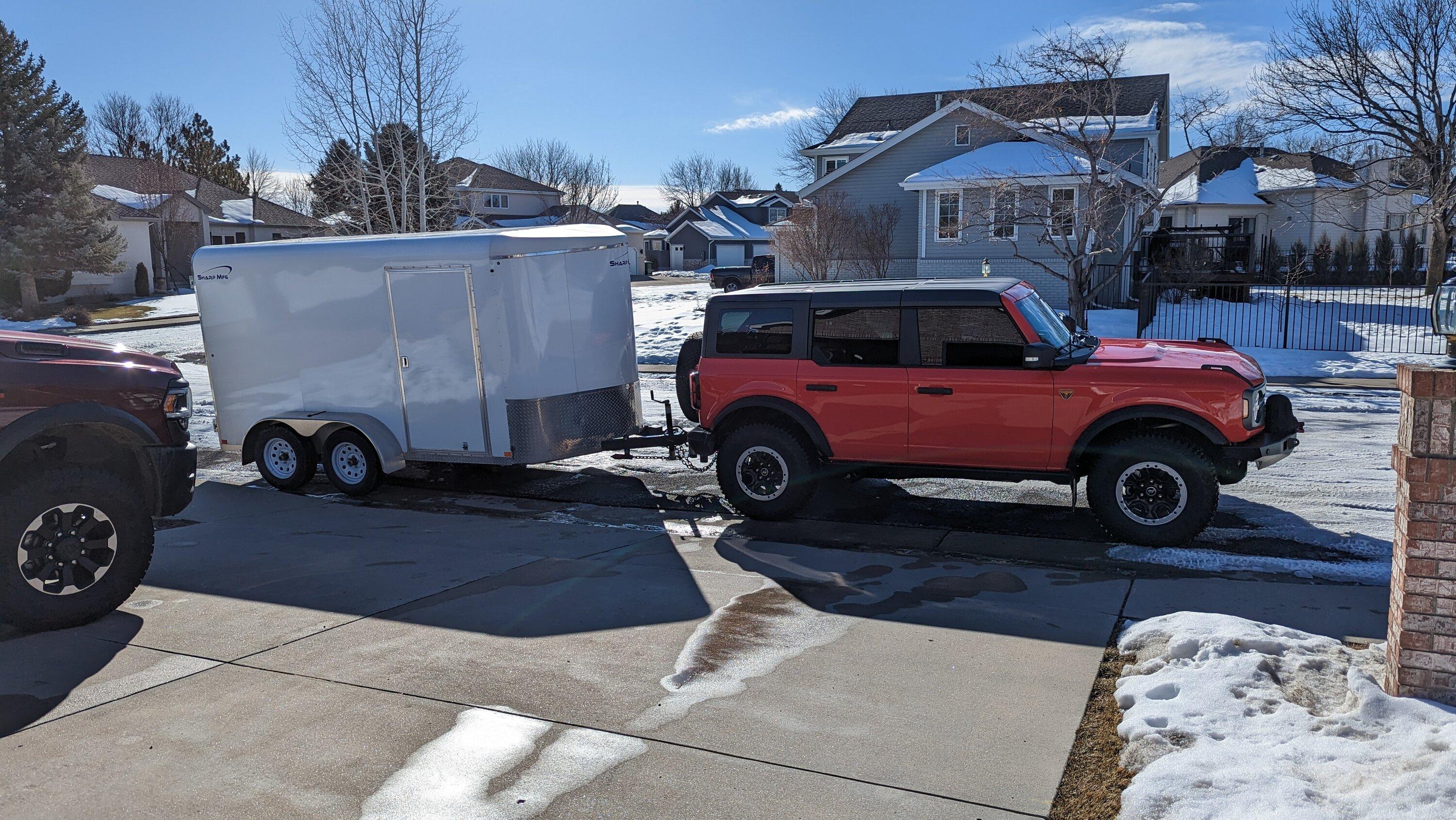

now with the weight distribution tensioned. (notice the extra chains running parallel to the trailer tongue). I tensioned enough to put me back to 1/4 inch of sag vs 1 1/4.
Did a quick road test since I don't have a brake controller in here (yet) and you can tell the bronco just wants to go! I went up to 60 MPH and did a few quick jerks of the steering wheel to make sure it stayed planted, and there's really no harshness to the ride.

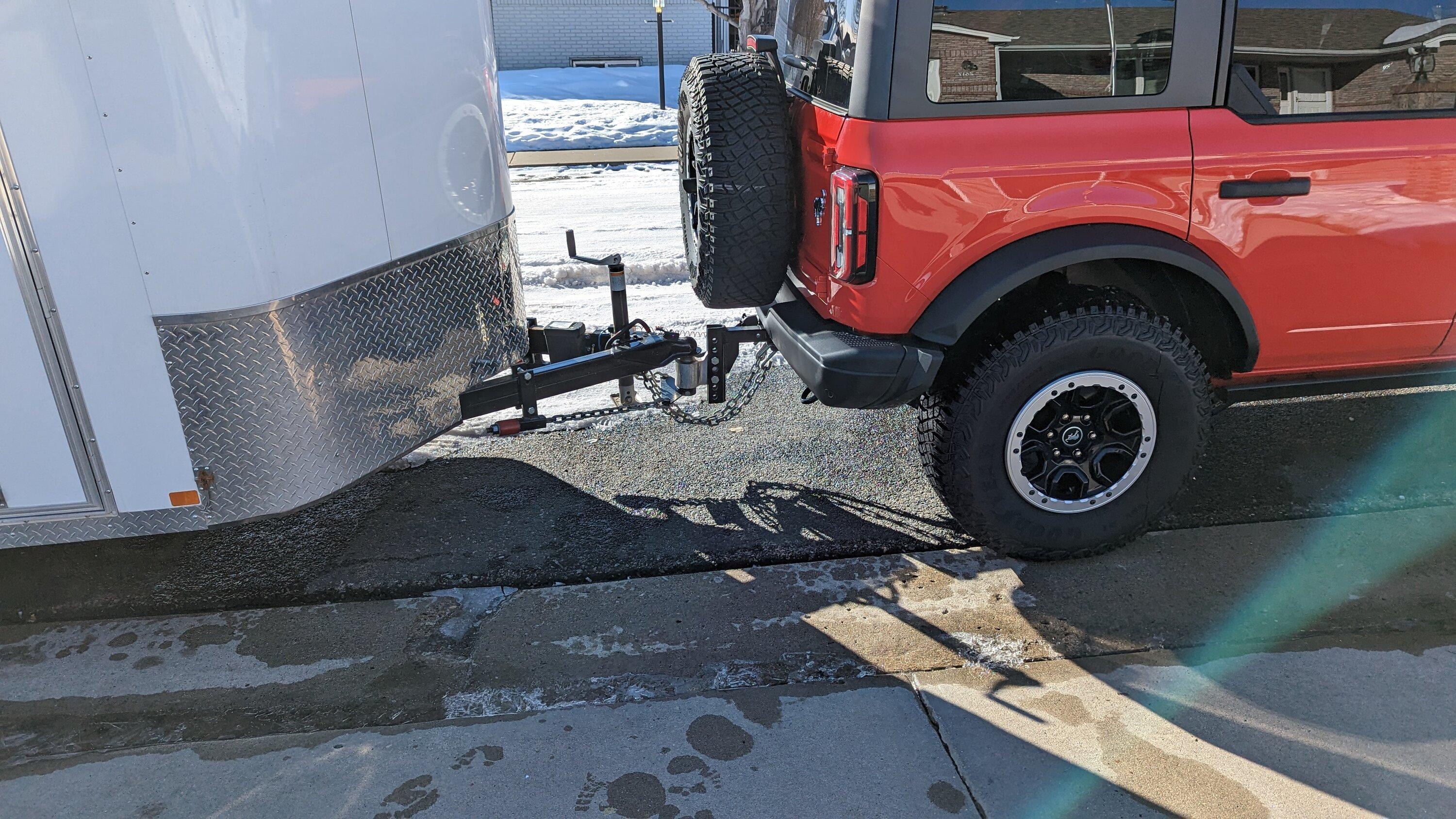

here's a pic of the andersen hitch a little closer (they've changed the design on these around 2016, but i've had this one for quite a long time):

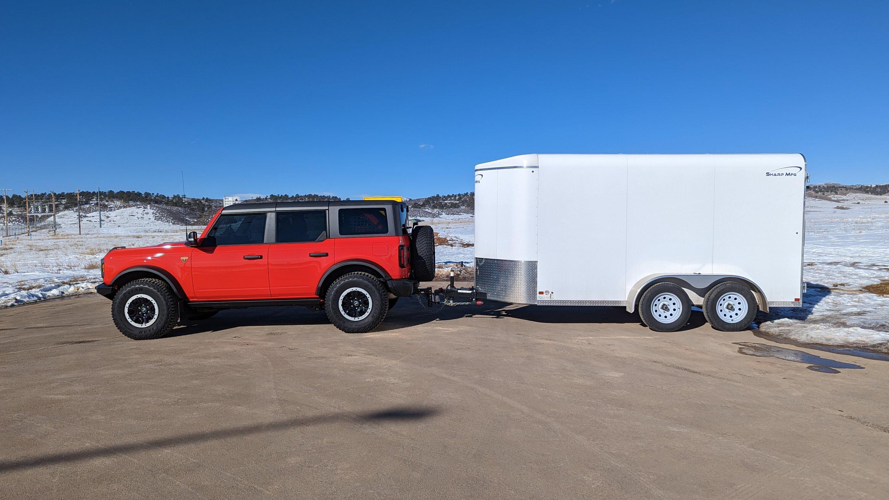

and here's a better side profile shot:
