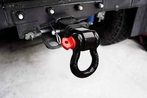

It also adds another recovery point to the rear of the vehicle. So for me, that and the wiring make it worth it.

Place to attach a winch to.
Right, I know the advantage of having a hitch receiver (which I plan to get regardless). The question is whether the factory option is worth the $600 or if an equivalent (or better) aftermarket solution will be available for significantly less.
I would ask the winch manufacturer, but class II , 3500lb capacity receiver is maybe a bit light for even a 5k lb. winch. Adding a snatch block to pull the big Bronco would definitely stress the capacity.

Was only answering about the additional recovery point... but yeah, I know what ya mean about capacity
