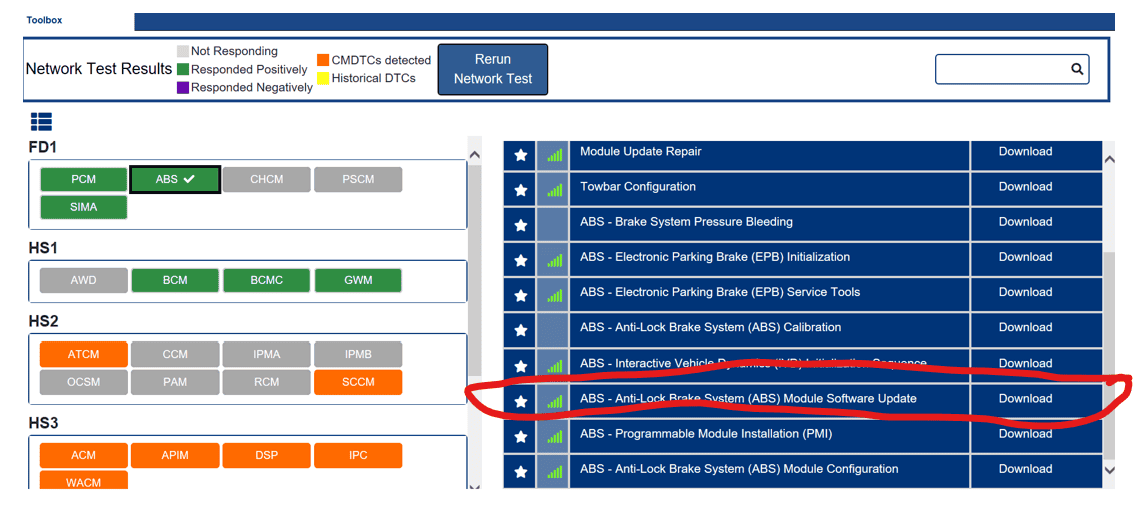

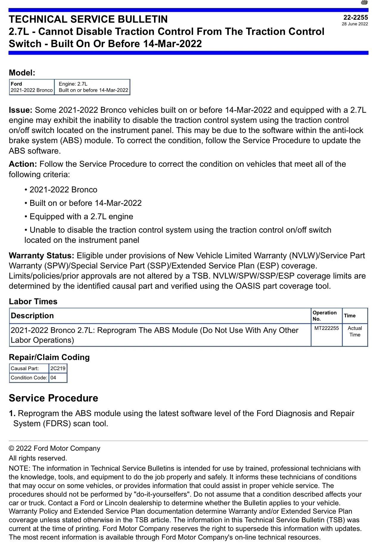

The dealer needs to update your comtrol module. Had the same issue.
I am still getting parking brake faults, but the TC turns off and on now.
Thanks for the info. I’ll check it out.
