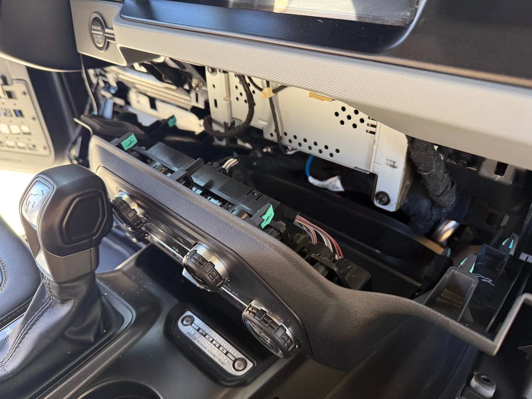

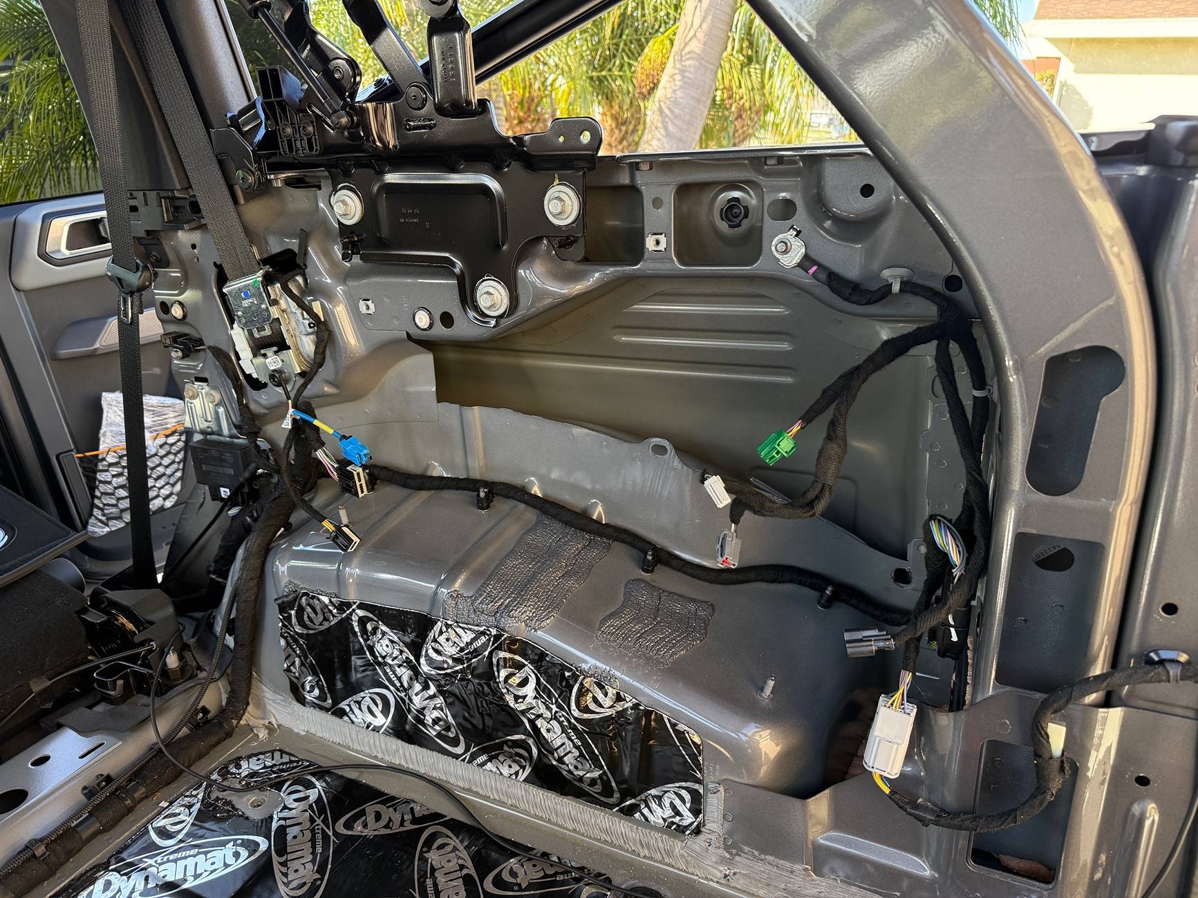

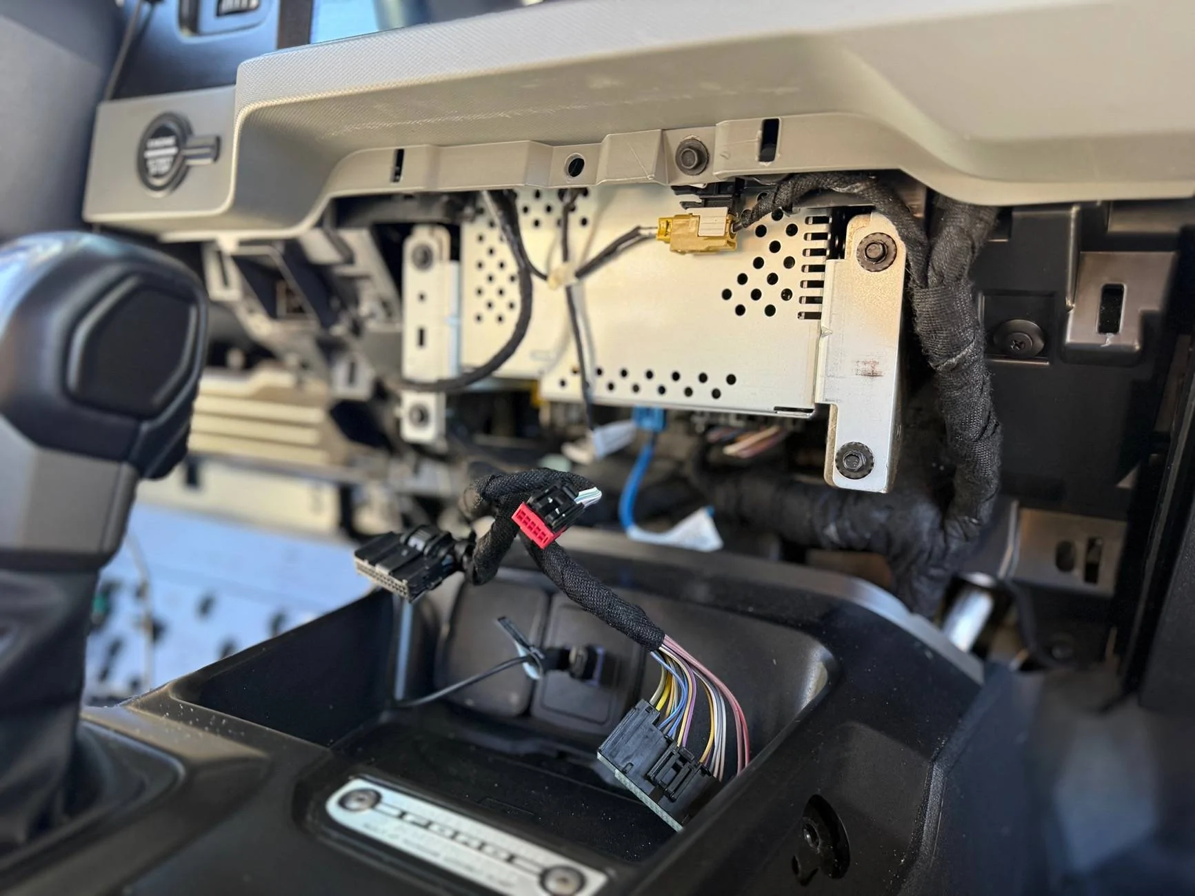

Installed the Trail Seven Bronco Full System Upgrade on a B&O-Equipped 2021 Bronco
After spending countless hours reading detailed forum posts about audio upgrades, I quickly realized that while the write-ups were informative, the technical jargon was like a foreign language to me. As I began piecing together my own kit, I stumbled upon Trail Seven’s website and discovered their complete audio system upgrade.

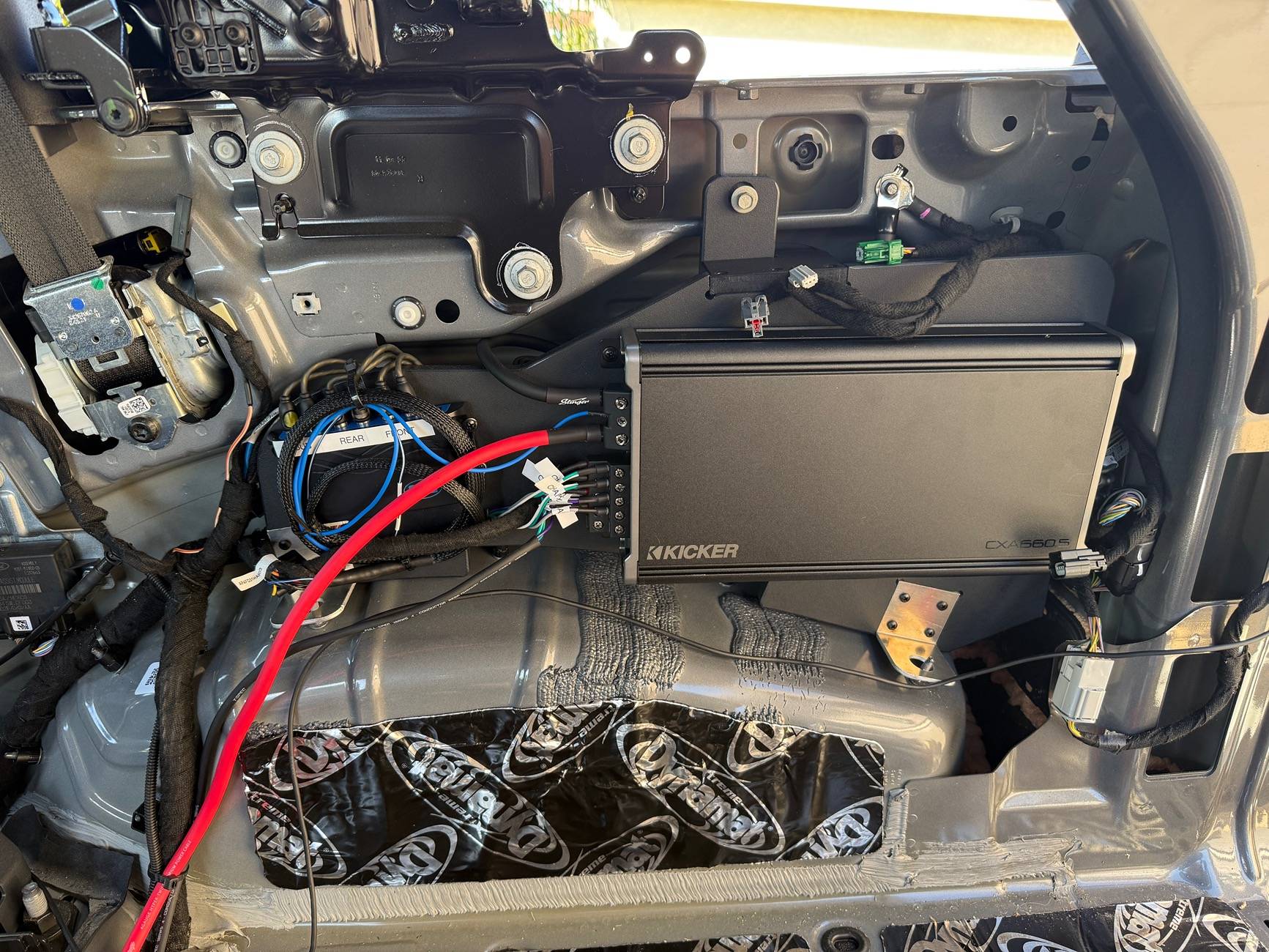

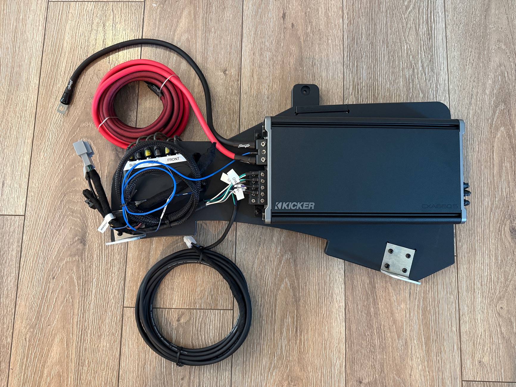

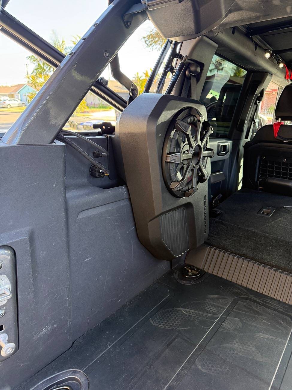

Their kit is reasonably priced, fully plug-and-play, and customizable. You can choose between different brands for the amp, speakers, and subwoofer mounting locations. I opted for the Kicker amp, upgraded Kicker speakers, and the SSV-mounted subwoofer.
Installation Experience:
The installation process was surprisingly easy, as long as you’re comfortable removing some interior trim. Trail Seven even provides a highly detailed YouTube video with step-by-step instructions, which made the process straightforward.
The only hiccup I encountered was with the ground wire—I had to scuff the painted surface to ensure proper grounding. Other than that, everything went smoothly.
Complete installation took approximately 4 hours with taking short breaks along the way.
Why I Chose Trail Seven:
While the kit costs a bit more than sourcing parts individually, the convenience of a 100% plug-and-play system saved me hours of wiring and potential headaches. The ease of installation and the huge improvement in sound quality made it worth every penny.
The Results:
The sound is night and day better—easily 1000% better than the factory B&O system. If you’re on the fence about upgrading, this kit is the way to go.
Photos & Notes:
I took some photos of the installation process to share here. Unfortunately, I forgot to snap pictures of the speaker installation, but trust me, it’s straightforward with the included instructions.

They had a door mounted option also that should work with the Tuffy enclosure. I thought about putting together a kit where I could mount it in the original location. My fear was that it would rattle the cheap plastic trim panel like the OEM one did.
