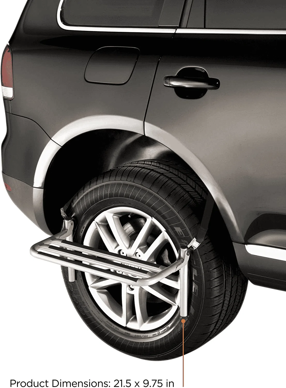

Just came up with a simple and embarassingly obvious solution: a portable step that attaches to the vehicle wheel. Standing on the step for near cargo, or up onto the wheel itself for hard-to-reach items. People with roof tents would have product-specific ladders, of course. Thule has a pricey one at about $100. Others come cheaper.
