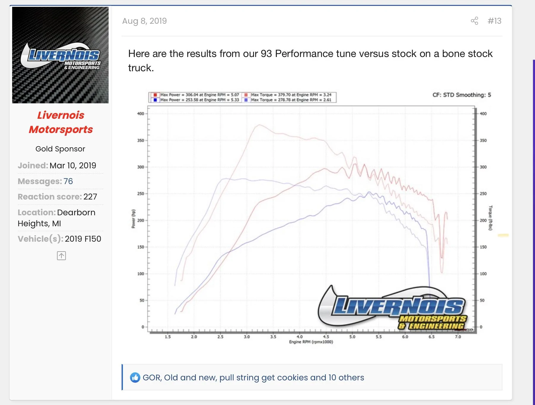

I think I would be good with this for a while 306 whp/379 wtq with no Mods other than a tune on a Ranger....keeps it right against the transmission torque specs.
Ford Bronco Transmission Torque Capacity BD68C0EC-540E-40BE-A072-9385152F2CE4
That graph looks like death quiver.
I'm actually more concerned about axles and such more than the transmissions once people start adding more power.
how about Cobb? Instant torque axle twister. Iā€™m not too worried at all because I dont beat on my cars.
