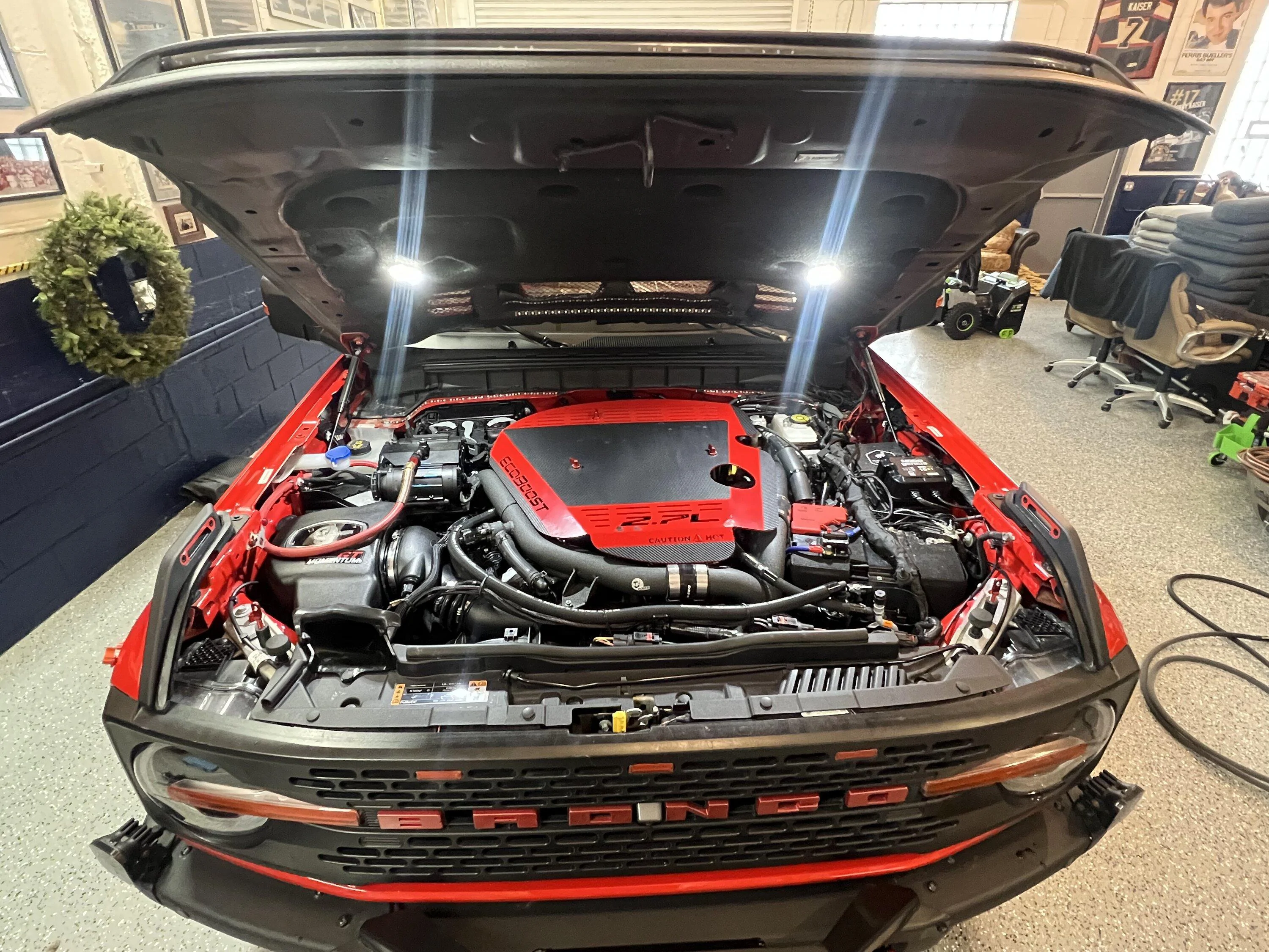

As some know I’ve been putting together the mods for the most power I can put down out of a 2.7 2 door. This will be the log for mods done and numbers put down. This will give the community a base line for what to expect between mods and mods with tune. Real numbers. This will determine what you can expect for making the trip for the “tune” and if it’s worth it for you.
Currently heading to dyno authority in Canada on the 17th. Last night I decided to run meth also. So not sure if we’re doing Friday or will push back a week. Dyno authority has put down the biggest bronco number to date with their tune. 403 out of a base 2.7 with a k&n intake, plus a handful more at or over the 400 horse mark.
They have yet to run one with downpipes as they can’t get one in with no cel on. Mine has never popped a light and running 100% with bolt ons. May be the unicorn badlands or I just had my mouth right on the last bolt.
Build is a 22 2 Dr Badland Sas high
2.7 auto
8k miles
Jan 10 2022 bd
Mods
-Afe momentum gt cai
/Afe blade runner charge pipes
-Jms pedalmax terrain
-Jb4 module
-Mishimoto intercooler
- Kompact EM VR19 Dual Port
-Upr catch can
-Spd down pipes
-Magna flow 11229 mid mount
-Awe 0fg rear/tip
-Jrcoffroad motor cover
-Anderson composites r type carbon hood modified to be fully vented.
-Maxxis buckshot 2’s 35”x12.50x17
-93 octane
This is the first time a complete list of what’s on my truck has been posted. Everything can be purchased and installed in your back yard.

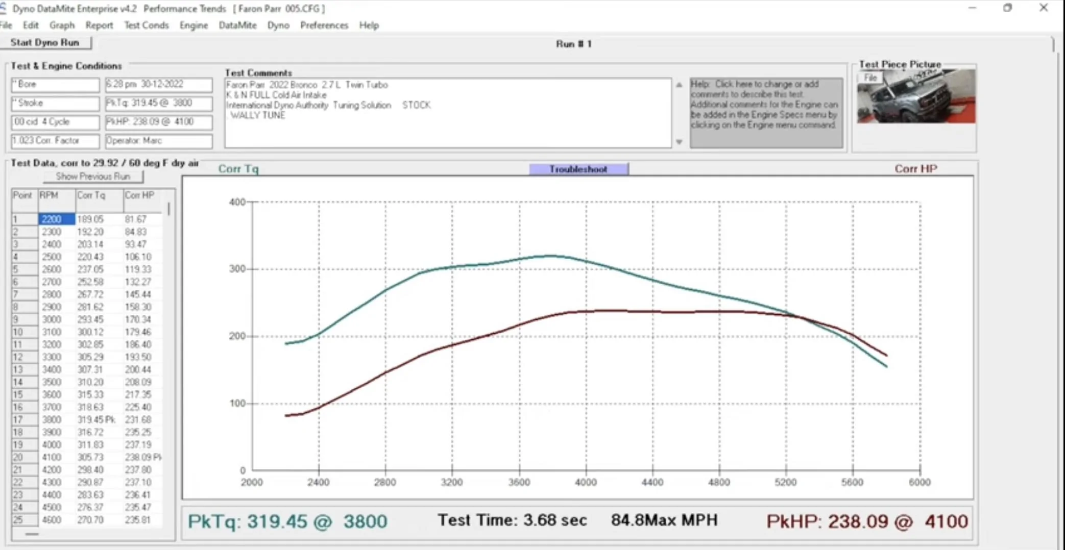

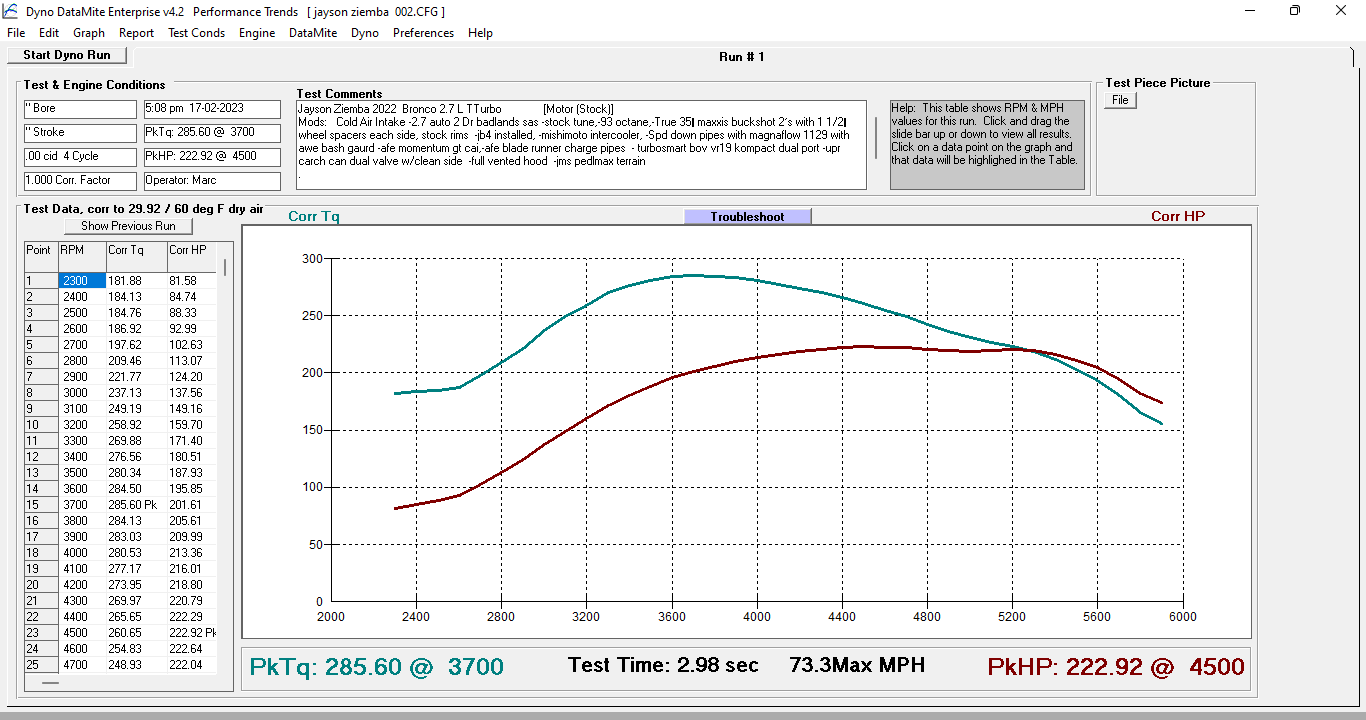

Went to see the guys at international dyno authority. Loved the place. Team is awesome. setup is small and personalized. Amount of knowledge was mind blowing. I tripped up Wally the tuner with the downpipes. First set they’ve seen on a bronco. He actually ran out of fuel and hit the lean fuel cut off. First time he’s ever seen that too. Said the exhaust is too efficient and loved it.
Took around 3 hours with 14 runs. Was very pleased with the trip.
This is my base line. All the mods plus the jb4 equals not shit without a tune. Talk about a hard truth. Was extremely disappointed in that base line run. But that is with big ass 35’s which he thinks only pulled 19 horse out from what he’s seen with the other broncos. Either way very disappointing.

You’re gonna make me wait a whole week to see the numbers 😁
Anyway, I’m really surprised how low your stock WHP and TQ numbers are…doesn’t seem right. The video they did with the stock WT put out much better numbers…
