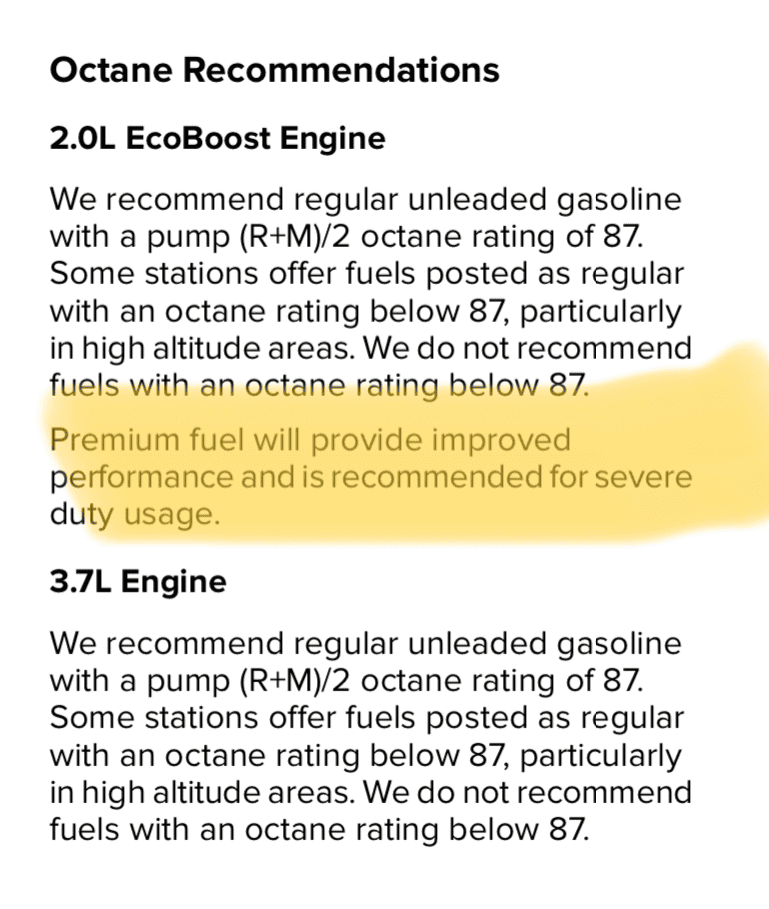

I haven't read the Bronco owner's manual, but the manual for my MKZ with 2.0L EcoBoost says that it accepts 87 octane but to use 93 octane for maximum performance.
Edit: It doesn't exactly say that, but I was close.
