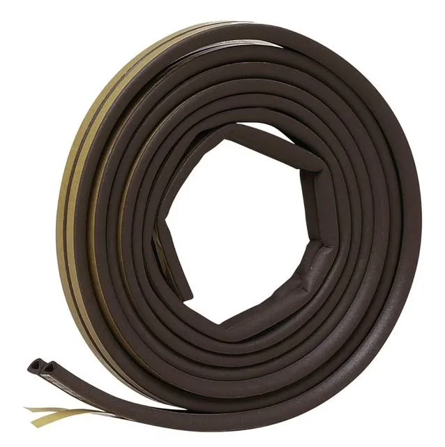

1/4" x 5/16" D-section weatherstrip (https://a.co/d/eM1QD0v)

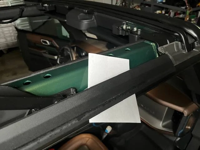

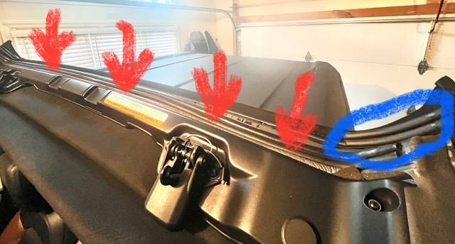

STEP 1. As you can see in the photo. a postcard-sized sheet can slide through the side mounting mechanism of the Sunrider which means that outside air can enter here.
Ford Bronco Ultimate 10-step wind noise fix for the Bronco Sunrider Top Sunrider_6

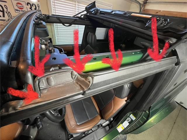

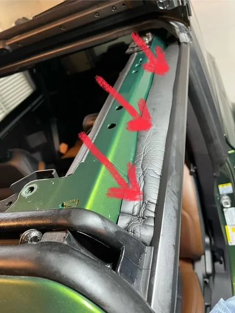

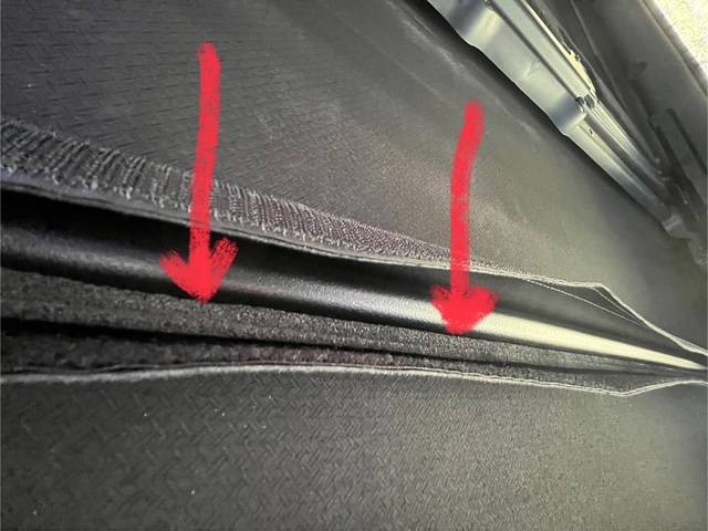

To seal the slight gap, open the top and remove the mounting bolts. Install 2" x 1" air conditioning foam (https://a.co/d/dpuvegQ) along the bottom of both gutters that run over the side windows (no adhesion needed).
Ford Bronco Ultimate 10-step wind noise fix for the Bronco Sunrider Top Sunrider_7
Ford Bronco Ultimate 10-step wind noise fix for the Bronco Sunrider Top Sunrider_8
STEP 2. To increase pressure from the Sunrider header on the secondary gasket at the windshield, add a double strip 1/4" x 5/16" D-section weatherstrip (https://a.co/d/eM1QD0v) across the Sunrider header (red arrows). LCW, another Bronco6G member, posted his solution: https://www.bronco6g.com/forum/threads/bestop-sunrider-wind-noise.33040/page-7. Be sure to clean the header area with isopropyl alcohol to assure adhesion. Also place a double strip (approx 3 3/4") at the very top edges of both sides of the header between the ridges on the roof material and the edges of the top (blue circle).
Ford Bronco Ultimate 10-step wind noise fix for the Bronco Sunrider Top Sunrider_9
STEP 3. Install a single strip of 1/4" x 5/16" D-section weatherstrip (https://a.co/d/eM1QD0v) over the top of the Sunrider side mechanism from just under the back folding material to the front windshield gasket. This will further block wind entering under the side of the top. Be sure to thoroughly clean the surfaces with isopropyl alcohol to ensure proper adhesion.

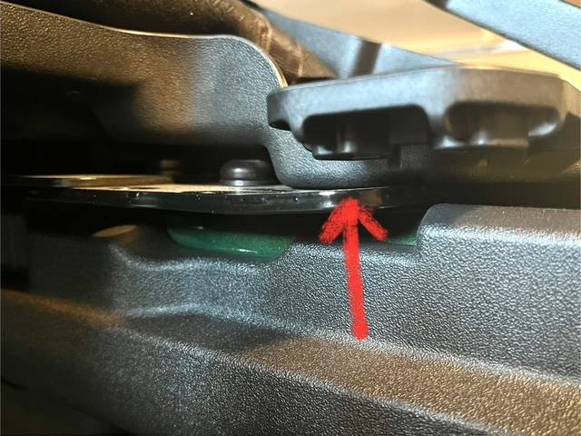

STEP 4. Remove the plastic washers on both rear mounting bolts to eliminate the gap between the top and the rear of the Sunrider before retightening the bolts. This will allow the back of the top to compress against the roof seal. If appropriate for your situation, you can replace the 5.5mm plastic washers with 2mm thick ones (https://a.co/d/2V82Ra2) or thinner stainless fender washers.

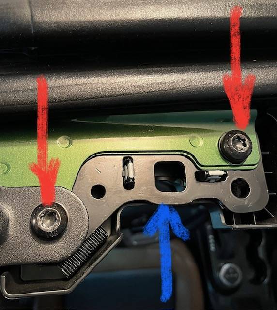

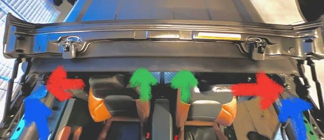

STEP 5. Loosen the rear mounting bolts on both sides (red arrows) and loosen the center bracket bolts (green arrows), then tap the assembly rearward as much as possible with a rubber mallet (blue arrows) before retightening all the bolts. Sean Gloff posted the following instructions: https://www.bronco6g.com/forum/threads/bestop-sunrider-wind-noise.33040/page-2
Ford Bronco Ultimate 10-step wind noise fix for the Bronco Sunrider Top Sunrider_12
STEP 6. Loosen the four front striker bolts (two on each side) at the front of the headliner (red arrows). Tap the strikers forward towards the windshield with a rubber mallet as much as possible (blue arrow) before retightening the four bolts. This will help pull the top down a bit tighter when latched. Again, thank you Sean Gloff: https://www.bronco6g.com/forum/threads/bestop-sunrider-wind-noise.33040/page-2

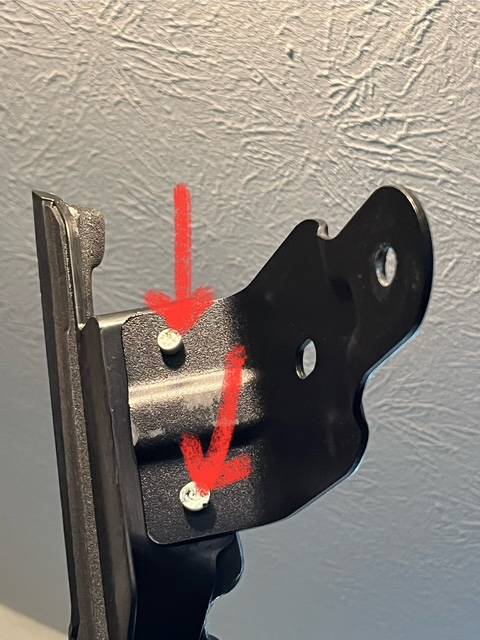

STEP 8. The rivets used in the front brackets are too long, hitting and scratching the door header sheet metal. This could also affect optimal alignment of the top. File down the tips, clean the edges and place rubber end caps on both of the shortened rivet ends to avoid scraping. (https://a.co/d/12Uvby2). You will need to trim the length of the rubber tips for a snug fit.

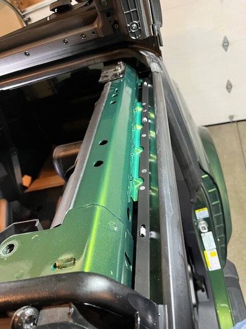

STEP 9. Correct a leaky side window maladjustment with this simple procedure:
