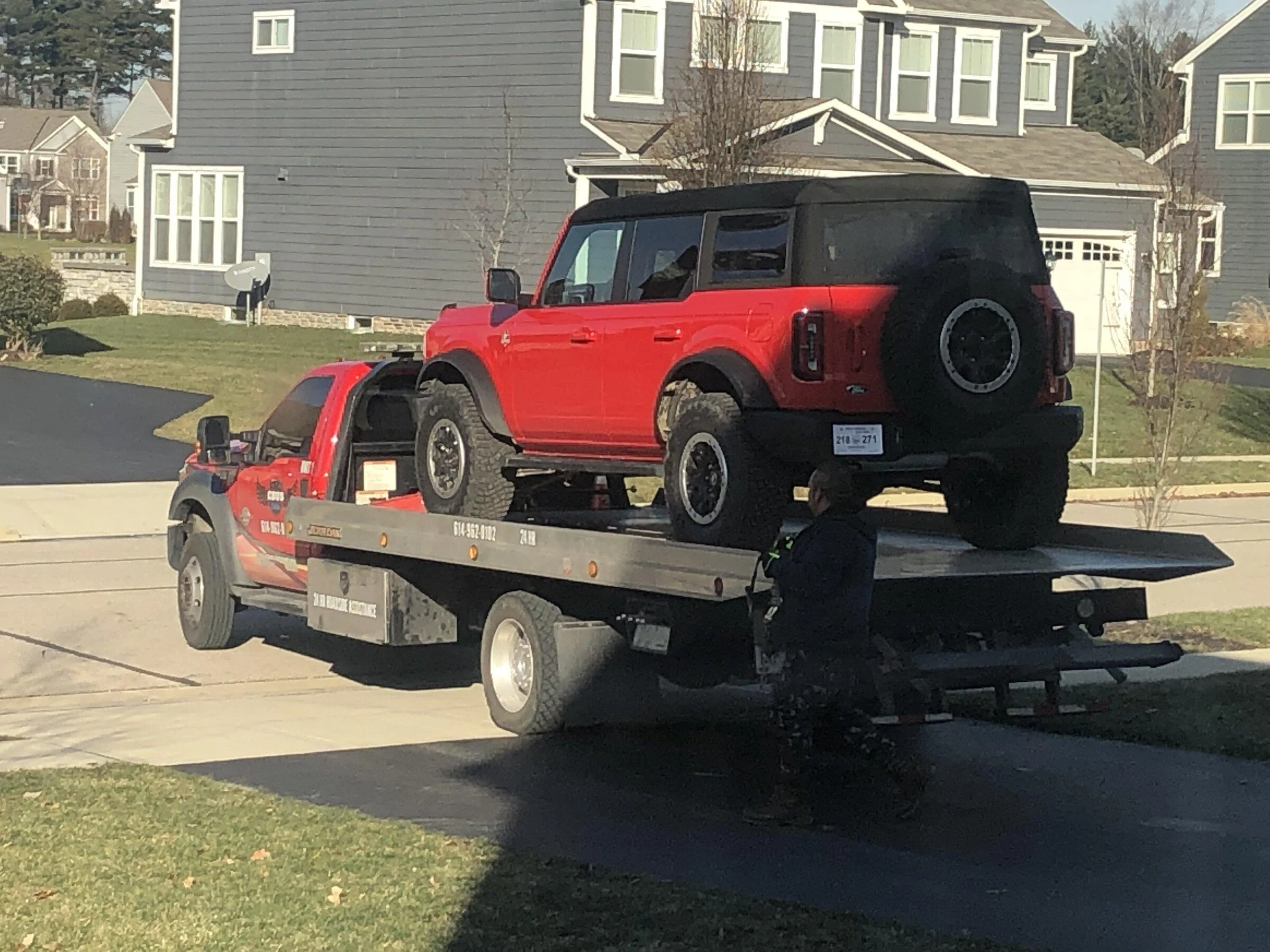

UPDATE: I got the dreaded call today from the dealership stating the engine has failed and will need to be replaced. I have heard of this happening with some of the 2.7s but not many 2.3s. I have owned it for less than a month and babied it the whole time. Only had 625 miles on it.
Original post:
I picked up my 2.3L 4 Dr OBX Sasquatch from Stephens just before Christmas and have put 600 miles. It has lived up to my lofty expectations so far. This morning a “low oil pressure” alert came on as I was close to home. I checked the oil when I got home and it has plenty of oil. There are no apparent leaks. I used the FordPass app to coordinate having it towed to the local dealer. It is being serviced tomorrow and I will know more then. Disappointing to say the least with it only being a month old.

Sorry to hear this. Does it still turn over or was it unable to start after the alert?
It still turns over and seems to run fine. The tow truck driver drove it onto the tow truck. Hopefully nothing major but concerning nonetheless.

Serviced in a day is a BIG win. Hopefully nothing serious, good luck and please report back.
PS: tow truck and Bronco are all matchy-matchy!

That sucks, did it stay on when they drove it on the tow towtruck?
So so, that's good, if not, I'd be surprised if they say anything other than "could not re-create problem".
Yeah, the light and alert came on again when they drove onto the tow truck.
