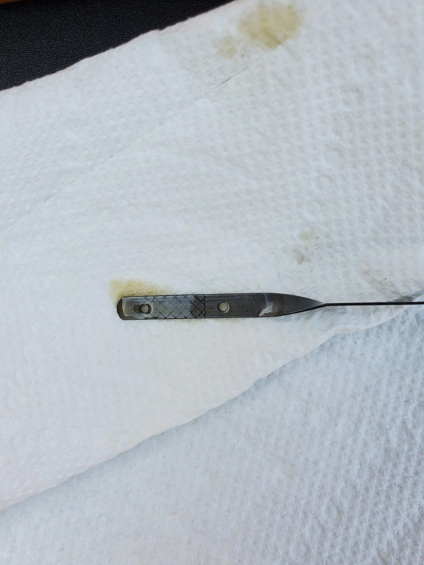

I had my oil changed by my local Ford service a little over a week ago. I decided to check my oil today when I was under the hood. See below....
I have driven a little under 200 miles with it like that, but thankfully I caught it. They went by what Ford states and put 7 quarts in. I went back today and expressed my concerns. They drained the oil and put 6 quarts back in and confirmed that's the correct amount. Ford needs to revise the manual!
Learn from my mistake and tell them it's only 6 quarts not 7 when getting your 2.7's oil changed.

WRONG....
flip said:
FSE was here and verified with bronco team engineering, 7.0qt for oil change is correct. My inquiry was the first they had received (through normal Ford channels) and they are investigating. One theory, which appears to be incorrect based on the last post, is they recycled the F150 stick. Beside it being longer, the part numbers are not the same so we can nix that. It's possible there was an engineering change since this 2.7 takes 1qt more than the other vehicles the Nano is used in. Gut tells me engineering spec'd 7qt after the indicator was designed/approved and no one caught it. Anyway, they are "officially" aware of it and looking into it.
My bet is the stick in the bronco is 1/2" too long and engineering just used the F150 length because of similar parts. They didn't take into account the bronco gets an extra quart.

I posted this before seeing the thread below. I think @flip is correct that the dipstick is not the correct length for the Bronco 2.7L. Ford has been made aware of this through the proper channels. Hopefully they will release something official and replace all the incorrect dipsticks out in the wild if that turns out to be the case.
https://www.bronco6g.com/forum/thre...-for-2-7l-engine-oil-change-is-correct.29047/
@flip Does my photo above seem consistant with what 7.0 quarts of oil is looking like on other 2.7L Bronco's?
