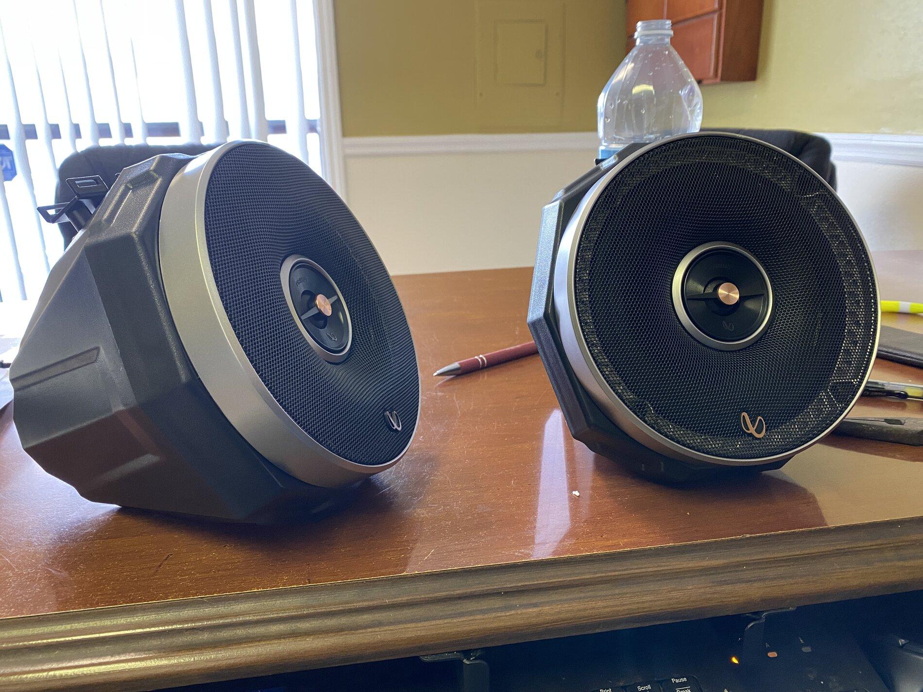

I got a set of CDT 3 way components for the front, a set of 6.5” Infinity coaxles with UTV speaker pods to replace the backs, a 10” JL W0 that I had laying around, and an Infinity 5 Ch amp. I will swap out the sub when I actually have the Bronco and know what will fit. I will also have to figure out how to mount the rear speaker pods. Has any done this yet?
