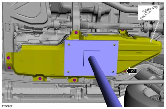

There really isnā€™t much more space for a bigger tank if you never seen the underside before.
Ford Bronco Upgrading Bronco fuel tank capacity A7A03312-B42A-4FF0-91C8-D052E2D86BFE
Aux tank on the opposite side, possibly rerouting the exhaust pipe a little - the are several for Jeeps and Landrovers out there.
