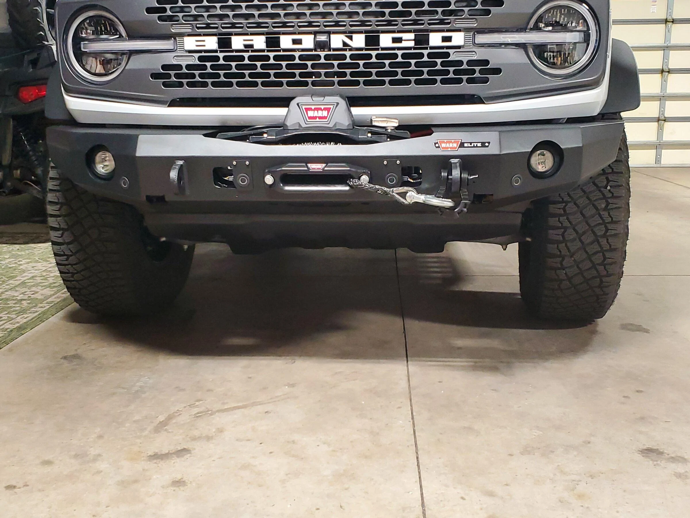

Had the Warn Elite bumper with Warn evo 10k-s winch installed. Found a Warn Dealer that said the Dennis Kirk 3.7“ fog lights work, part #2103379, $399. They come with spot, flood or hybrid lenses. Heres a picture installed, flagman
Ford Bronco Warn Elite bumper, lights? E29323AB-A23F-4EFF-B16C-7A6BECD481C0
Can you post other pictures? side profile etc?

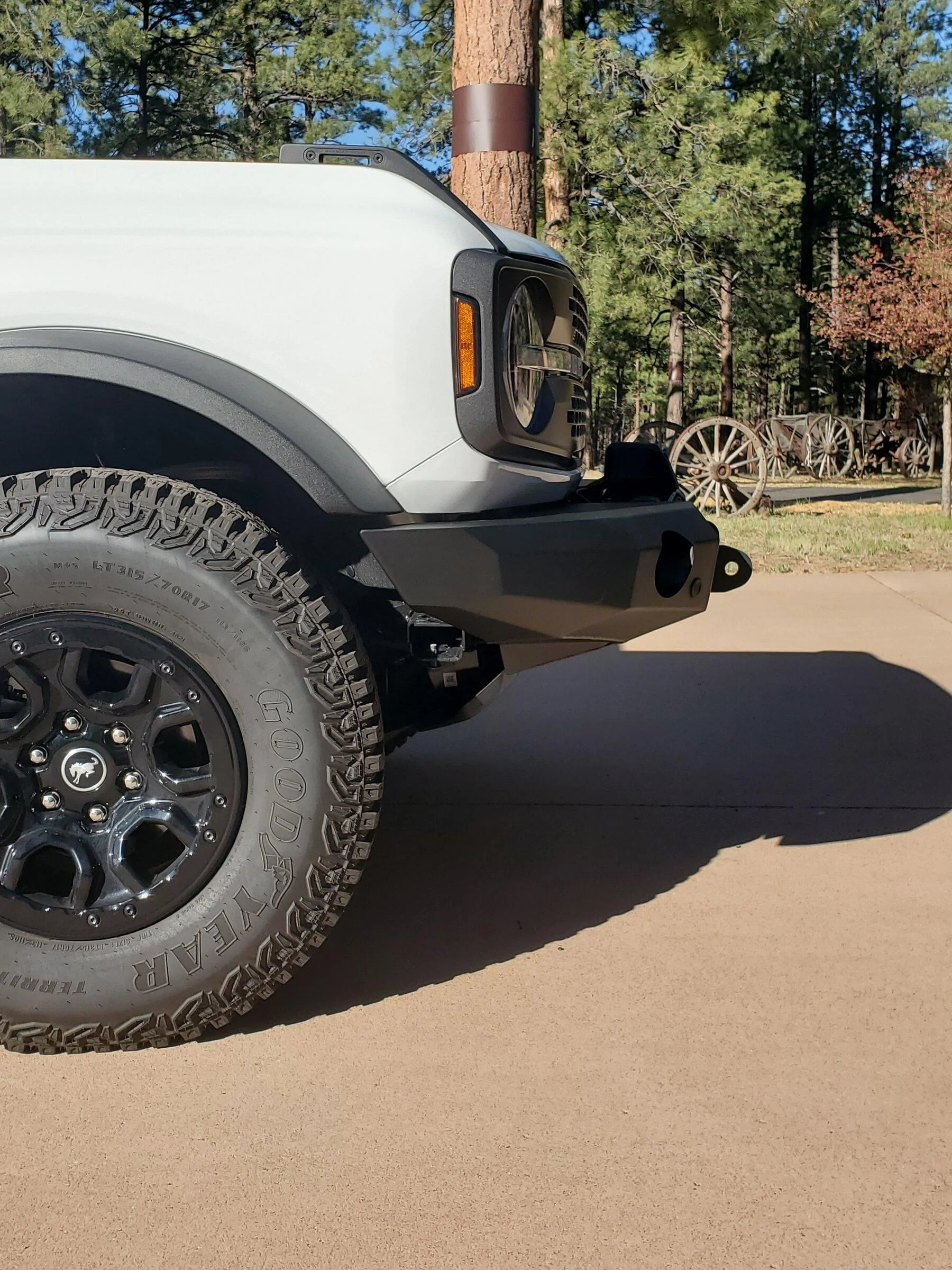

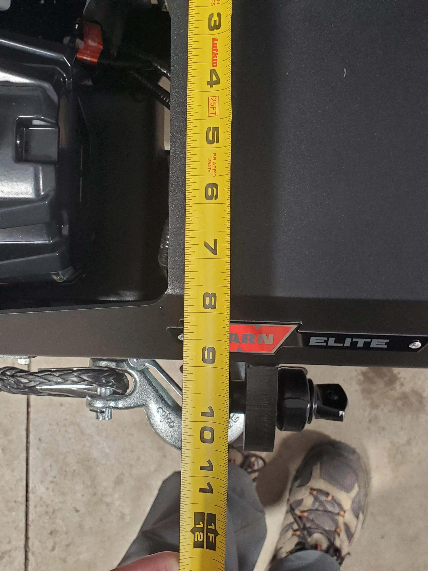

Heres a side picture and a tape measured off forward most part of body at winch location, flagman

Camera is acceptable, I asked dealer to relocate control pack to inside of bumper as winch kit comes with bracket and existing cables are long enough. They said they forgot and were willing to do this, however from what I can tell only the wireless feature would work as I could see no way to reach the wired plug inside of bumper. I called Warn several times, they were absolutely worthless about questions regarding the relocation Of control pack and corded operation. I feel relocating the control pack under hood would be the best solution, possibly using a KR bracket. flagman
Ford Bronco Warn Elite bumper, lights? 29279E11-FC25-4543-AF87-2E4415C28FC1
Hi flagman, can you please go into a tad more detail about the fog lights? Is it a direct plug in to original wiring harness? Also how did you mount the lights? Did you have to make a bracket?
I was installing the warn elite bumper to find out the OEM fog lights won't work without fab work. So disappointed warn never mentioned this. If the bumper didn't come in all chipped, scratched & I already paid to have it sandblasted & repowder-coated, I'd have sent it back, even though it looks nice.
