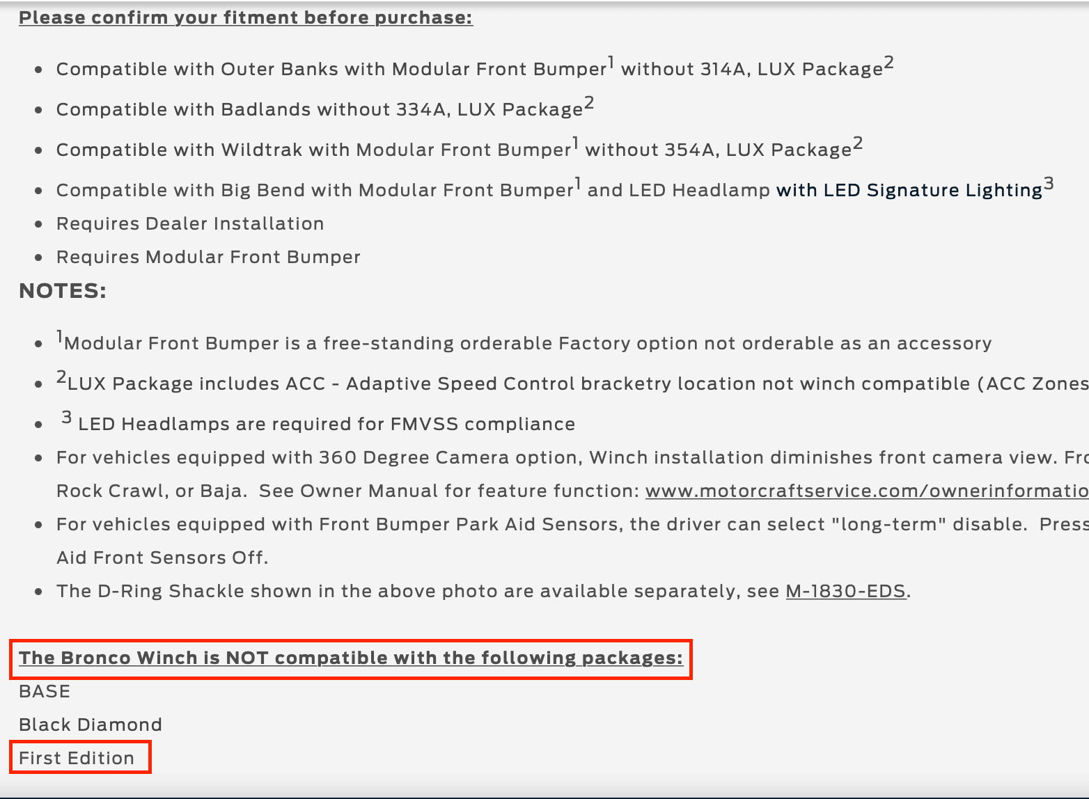

The winch isn't compatible with the First Edition.
It's not compatible with First Edition due to the ACC radar being standard. Where as its part of the optional Lux packages on others.
OP make sure your parking sensors are long term disabled and front collision is off. If ACC cant be long term disabled you may have to forscan it.
Ford Bronco WARN Winch 1643729634979
Spot on, winch can be installed but sensors and ACC will not function properly.
