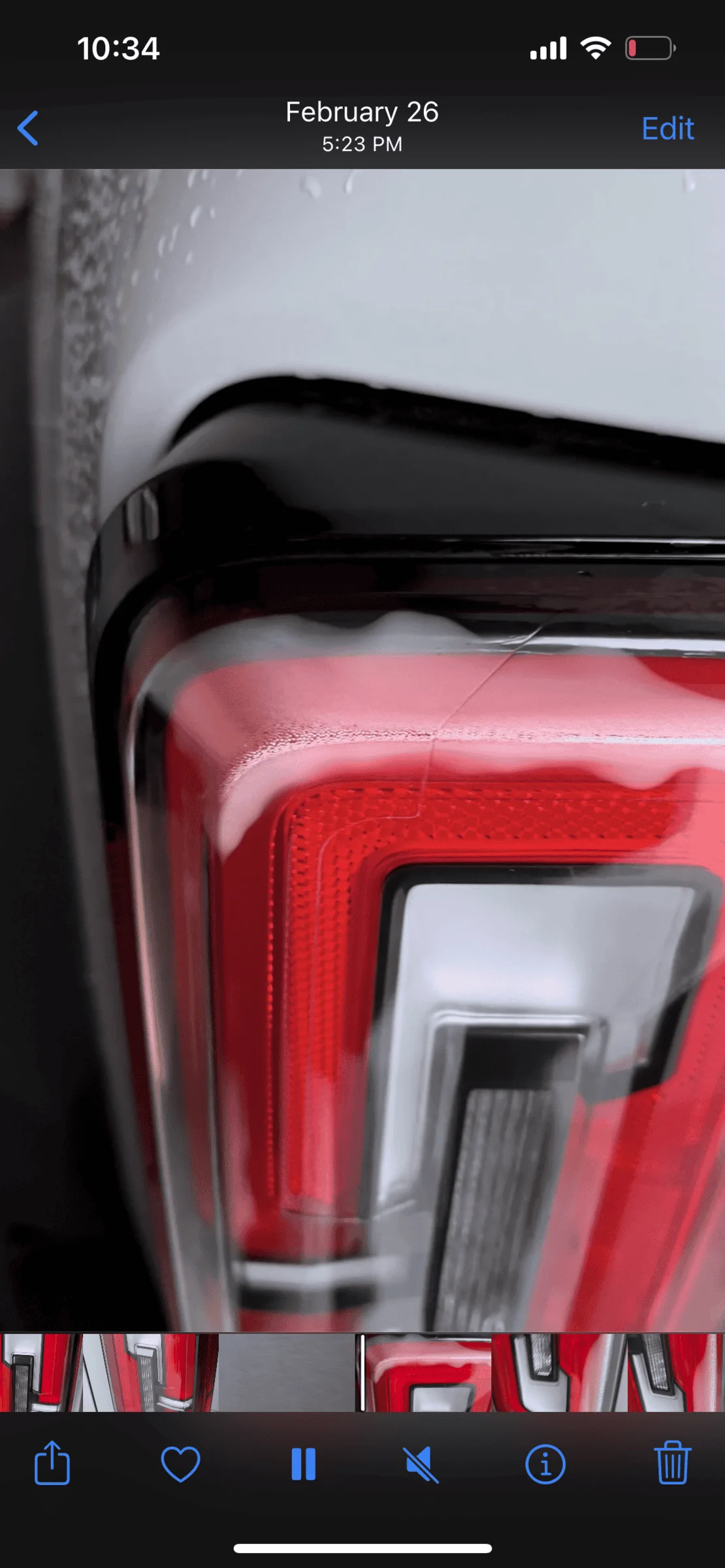

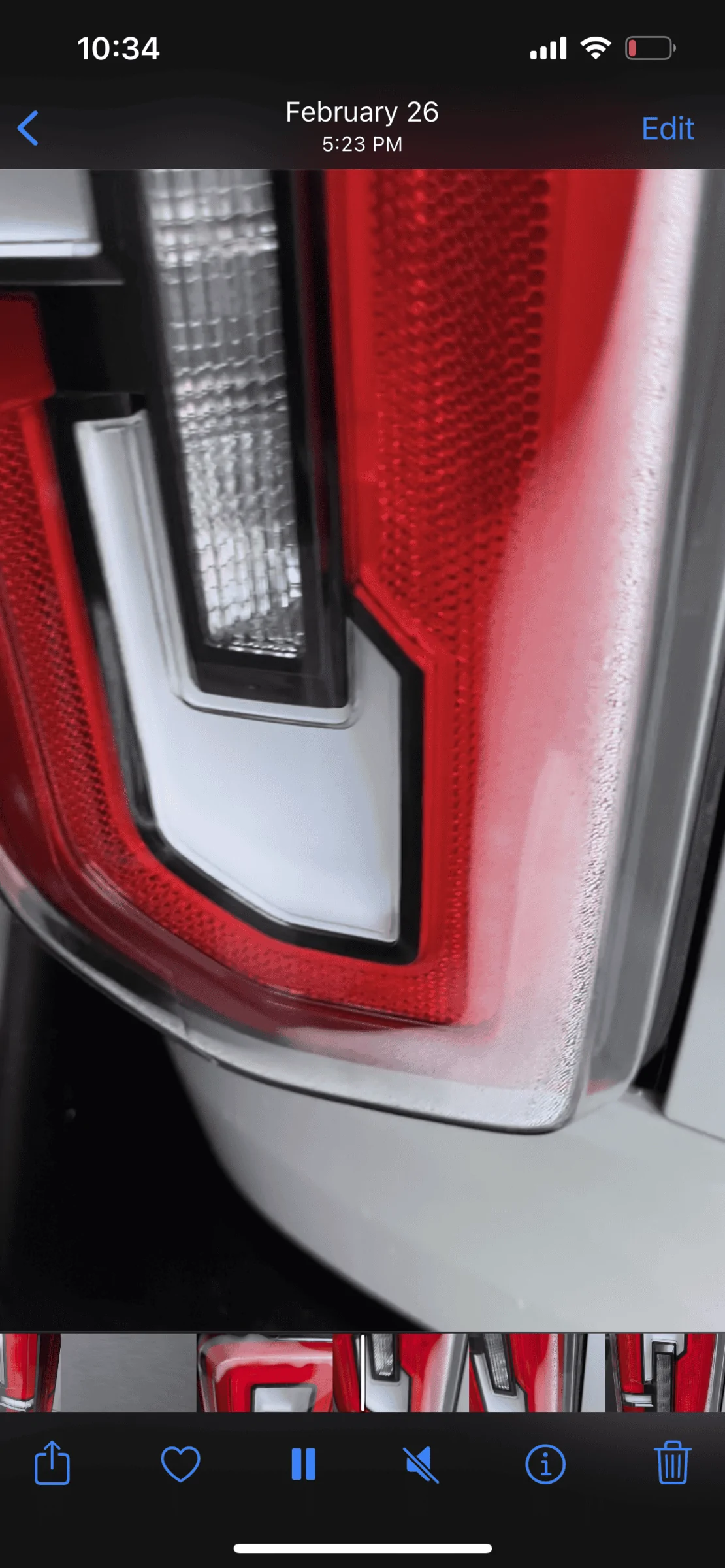

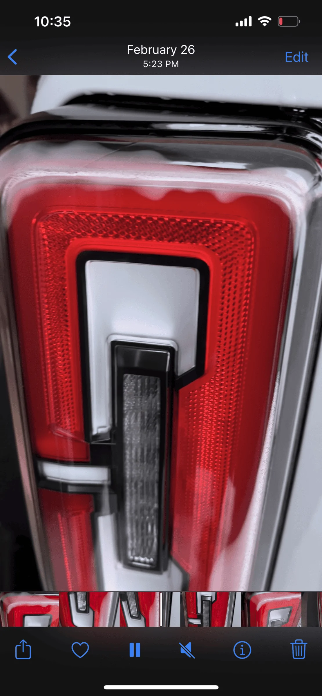

Hello, I am posting this picture and looking for anyone who might have encountered the same small issue with moisture in the tail lights of their broncos. I hand washed my bronco and as I was drying the tailgate. I noticed that the driver side tail light had moisture in it and the passenger side didnā€™t? As you would expect I recorded it on my phone and called the dealership. My appointment was a few days later and by this time the moisture had dried up and was clear. I showed the video to the service department manager and he told me that itā€™s a common thing that happens. He mentioned something about the broncos have vents in the tail lights for the release of moisture? So I asked him then why didnā€™t the passenger side have any moisture in it? He didnā€™t have an answer and told me that the next time I wash my truck to drive it immediately to the dealership so they can see it for themselves and not on a video made four days prior. I know this is probably BS. But if anyone has seen or heard of this? Any info would be welcomed. Iā€™ll keep you posted. Thanks šŸ™šŸ½

Thatā€™s no fun! Was there a substantial temp change in the time between rain/sun? Bet itā€™s condensation, not that thatā€™s a good thingā€¦ :(

That usually means you have a crack or the light is not sealed correctly. This usually can be handled with a dealer warranty.

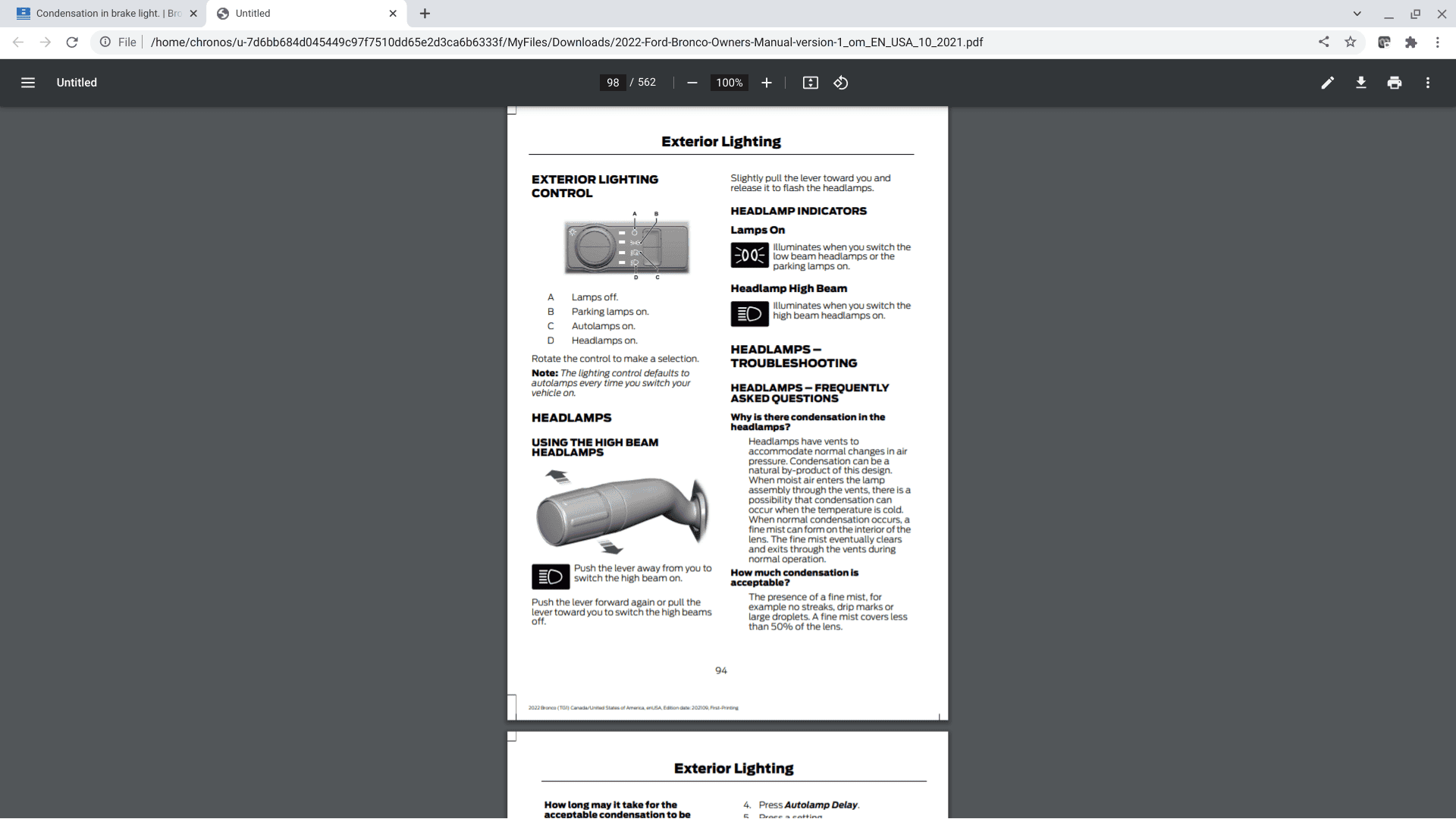

Wrong, this is normal. Plenty of threads on here already about this. Read the manual, up to 50% humidity/condensation coverage inside the light is normal. There are vent holes in lights, the condensation will evaporate.

^^^what he said. Dealer will send you away, as this is normal.

Yes the same thing happened to my Bronco 4dr Outer Banks. Drivers side after I washed it. The moisture went away in a few hours parked in the sun. Have not noticed it during a rain storm but will watch it closely

šŸ’Æ Totally normal

My 2019 VW Tiguan had water in one tail light that was literally sloshing around. Dealer replaced. Re the Bronco, a little condensation is typically not an issue from what Iā€™ve heard, but Iā€™d keep an eye on it.

Yeah I took my Mustang in for the same thing and they pointed out and showed me the vent holes at the bottom of the lights and said it is only a concern if it stays there for many days without clearing out.
