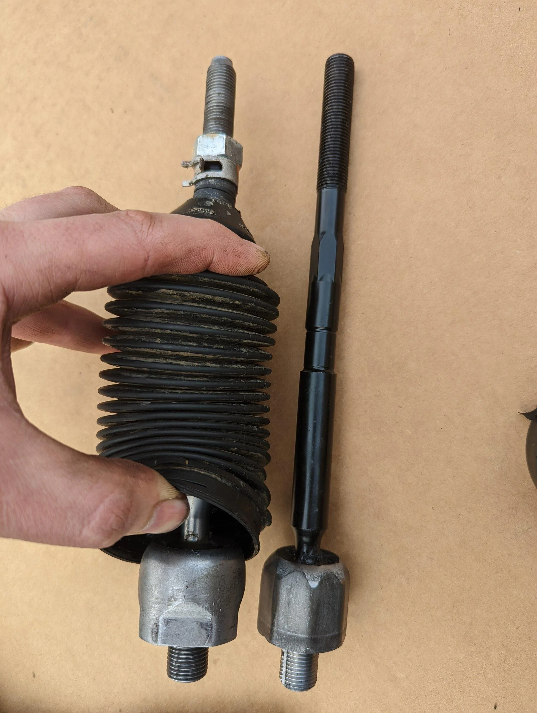

Today I ripped apart my steering again and confirmed that a 98-11 Ranger inner tie rod is a direct fit for us in a pinch. Length is the same within 3/16" and all the threads match. No strength upgrade but it will get you home.

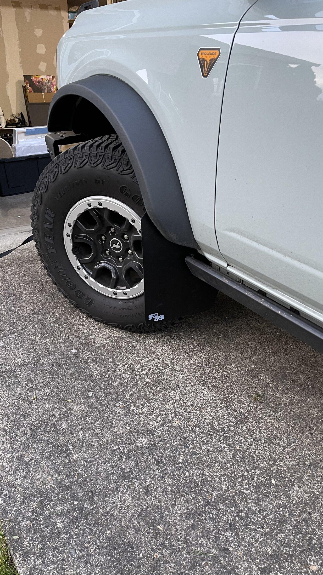

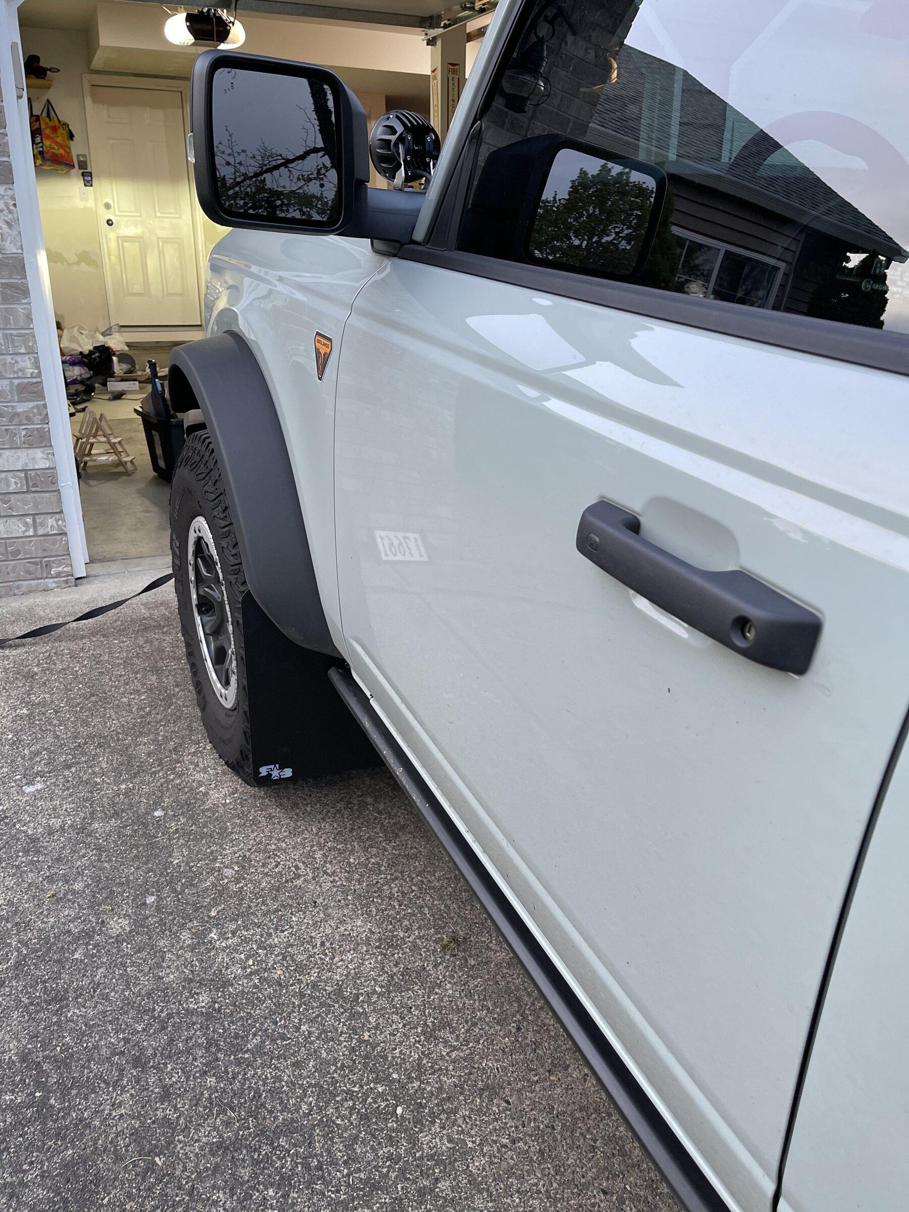

Rokblokz front flaps only. Won’t run them 99% of the time but down gravel road they’ll be on. I also did a ghost GMRS install. Here’s a short video I made.
