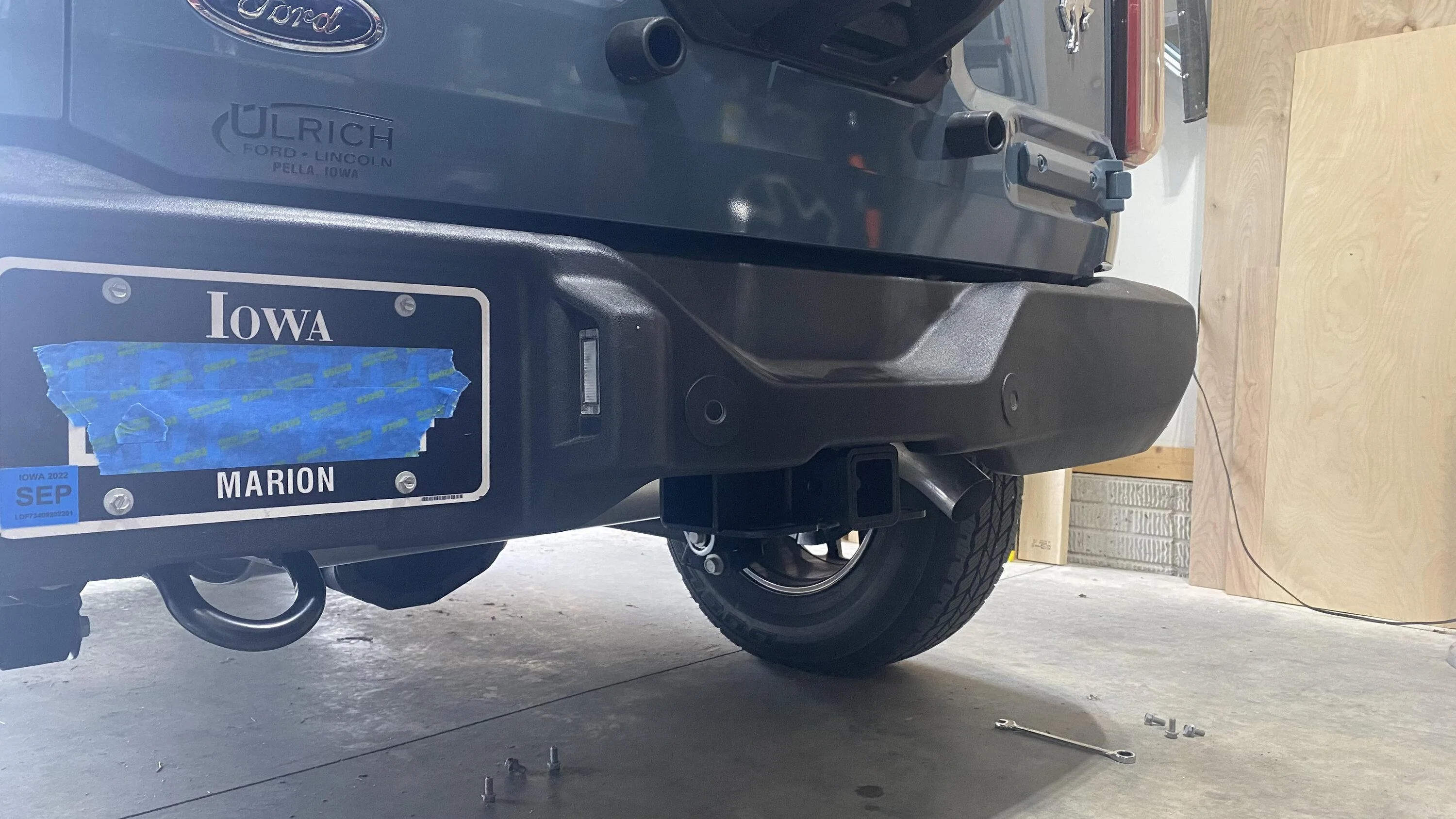

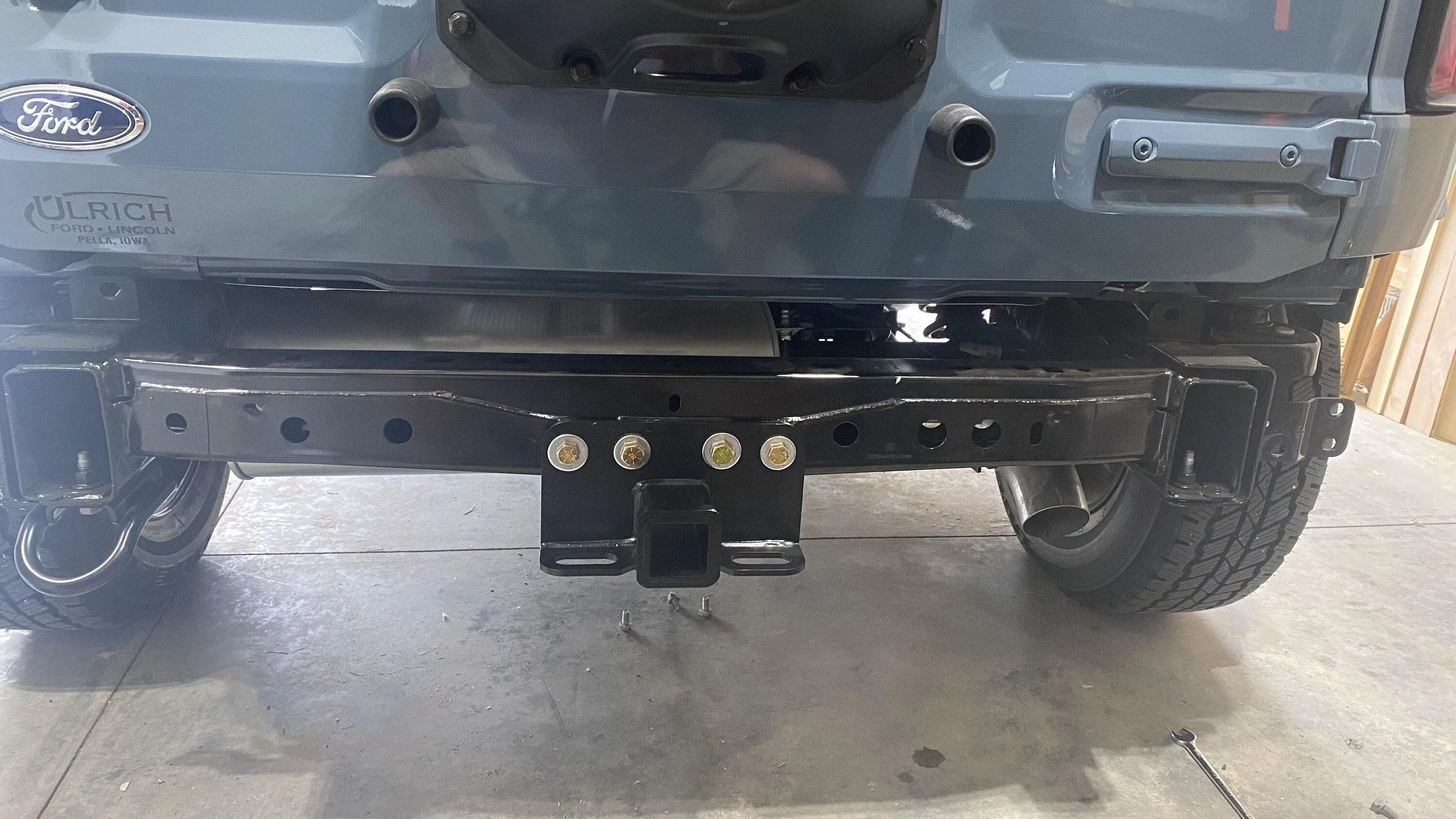

Added the rough country hitch. Instructions were crap, but the install was easy and took about an hour.

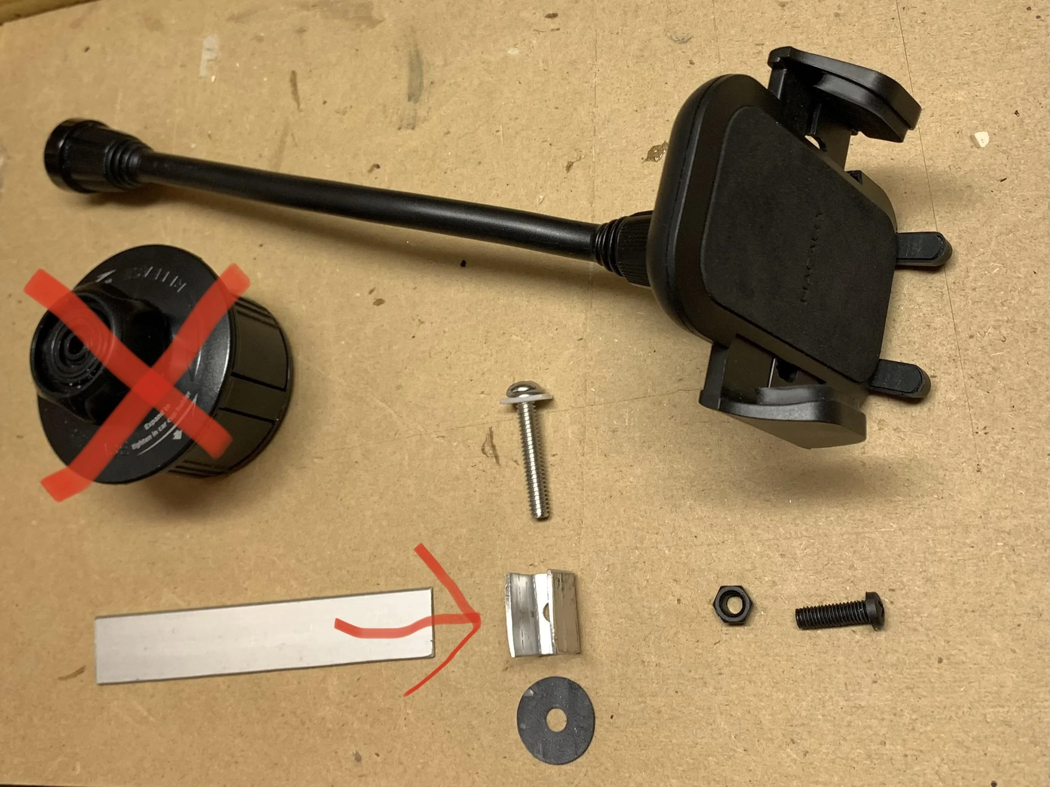

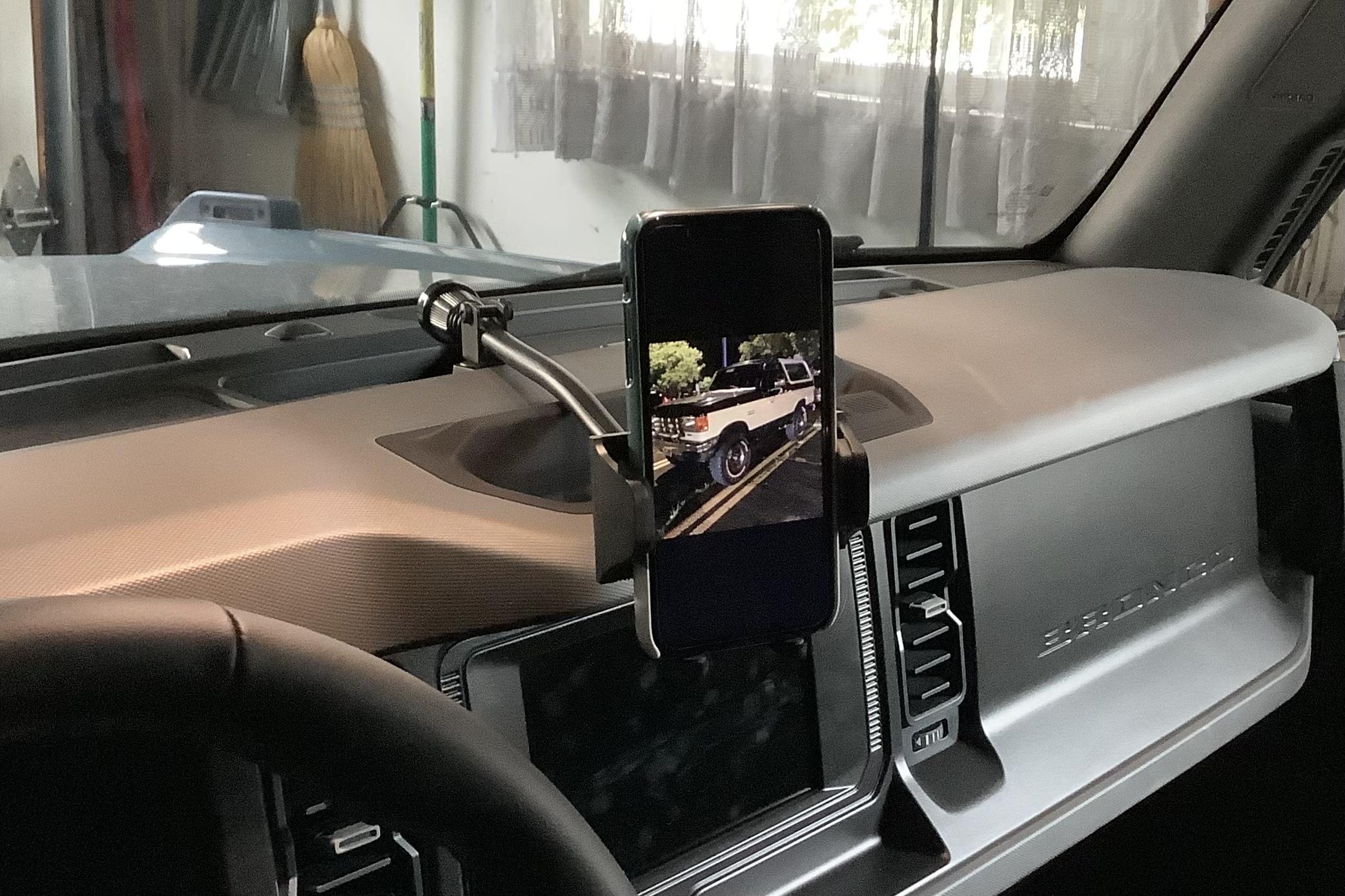

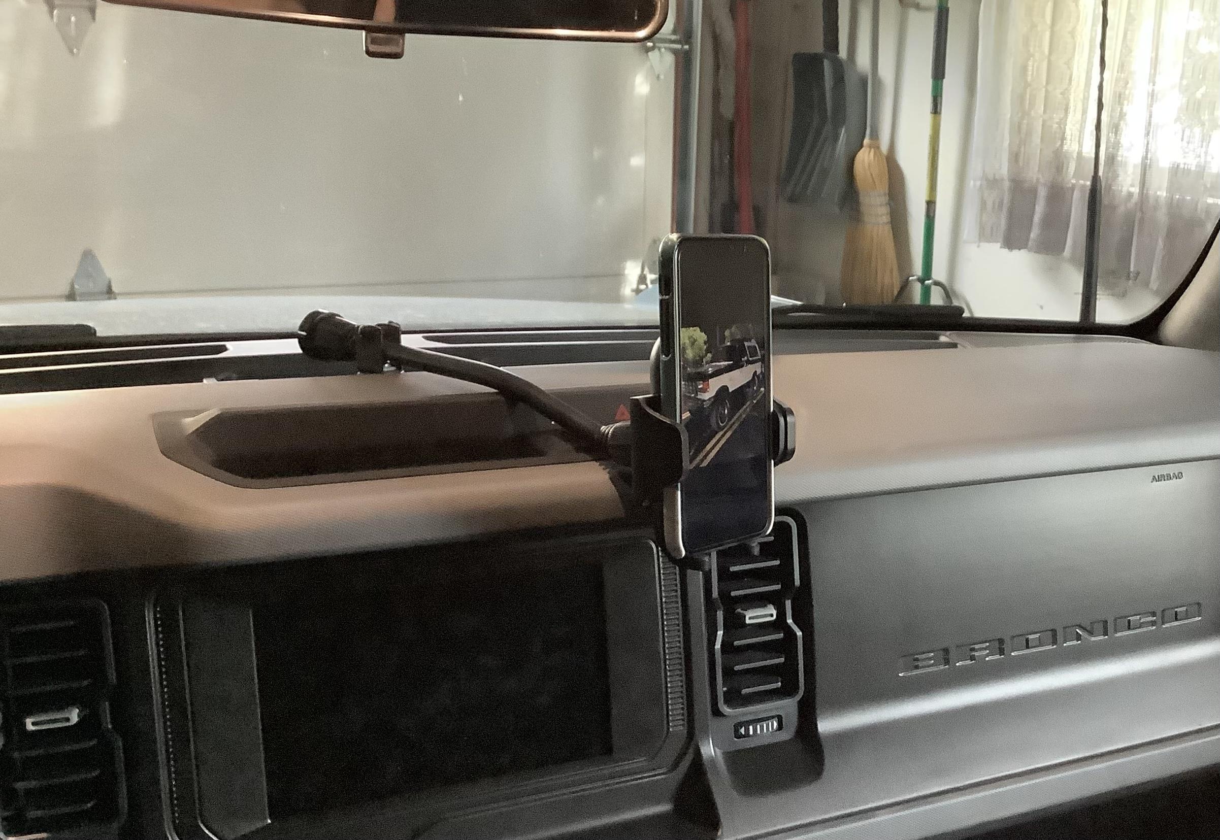

Converted my cup-holder phone mount for use with Bronco’s dash GoPro threaded socket:
  1. Removed and discarded cup-holder base from arm
  2. Fabricated a metal bracket from 1/16” x 1” aluminum (this step took by far the most time, with many test fits and adjustments) and spray painted it black
  3. Made thin plastic washers to protect socket and bracket paint
  4. Obtained a bolt- stainless 1/4 x 20 x 1 1/2”- from Lowes (2-pack for under $2); this was my only purchase
  5. Drilled cross-holes and inserted black nylon nut-bolt, which is gently tightened to clamp and retain the arm.
Phone can be positioned to face driver (without blocking view out windshield) or swung to passenger (leaving access to touch screen). Frees up cup holders for coffee, water, or whatever. Easy and cheap (if not quick) modification.

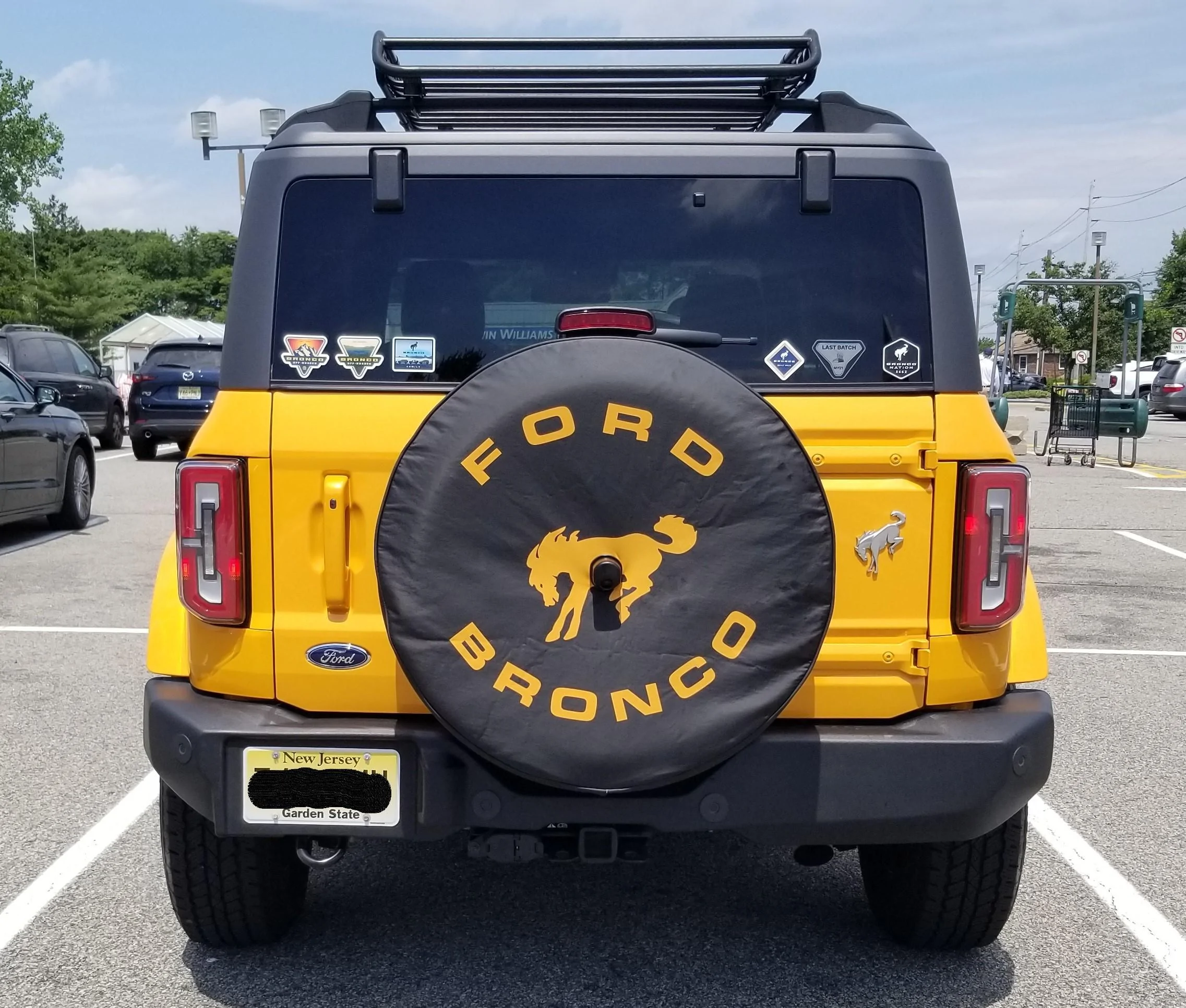

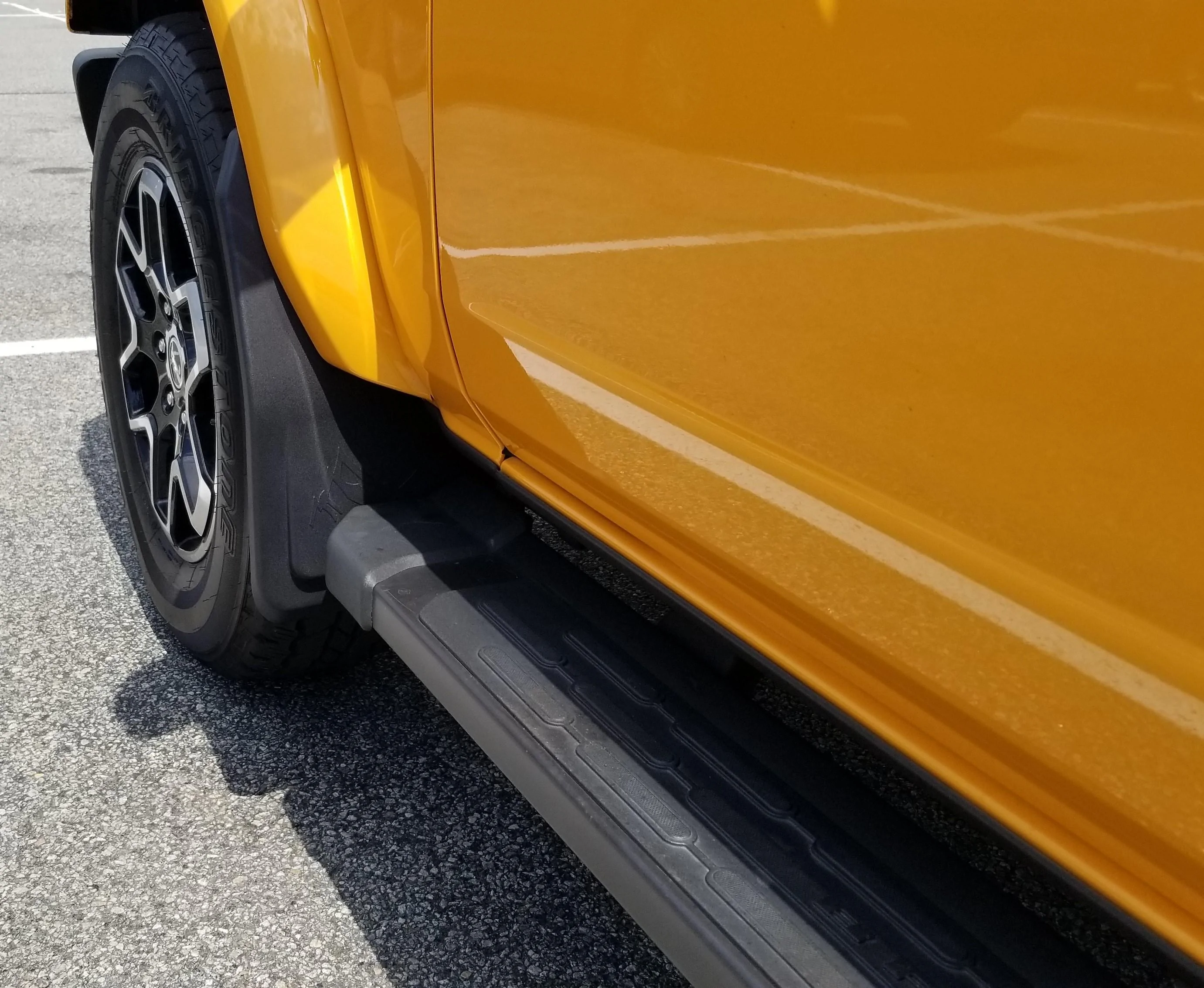

Installed my Mabett front mudflaps, and put on my tire cover.

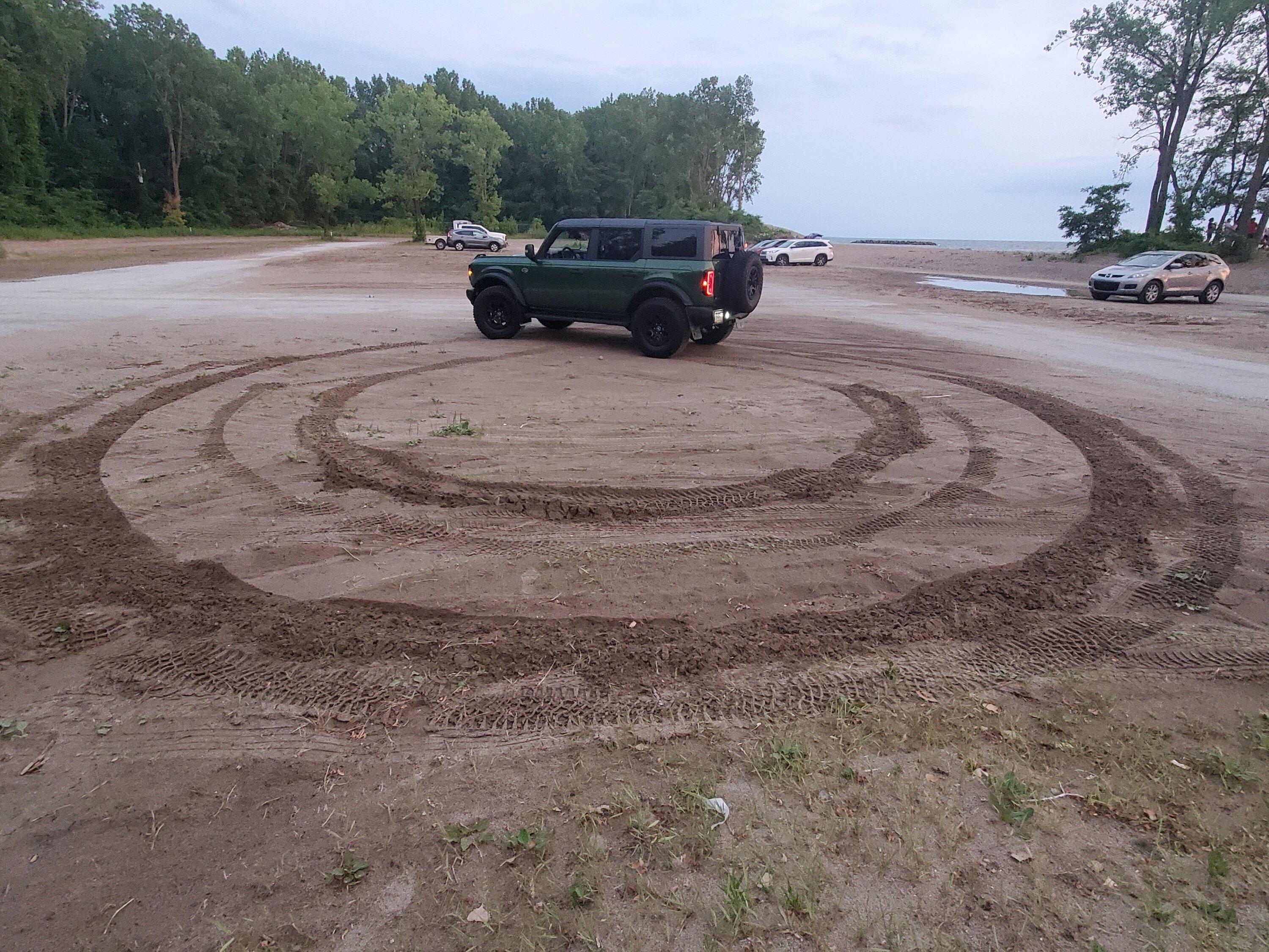

Tried the trail turn assist
... Shouldn't that be a lot tighter?
Here's from Off Roadeo, granted this sand looks softer... But we were able to turn dang near 90 degrees on the trails.
