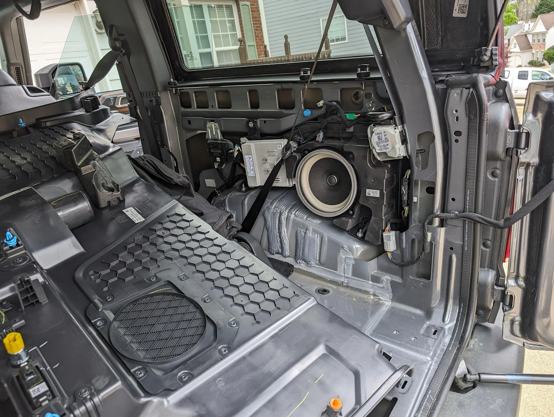

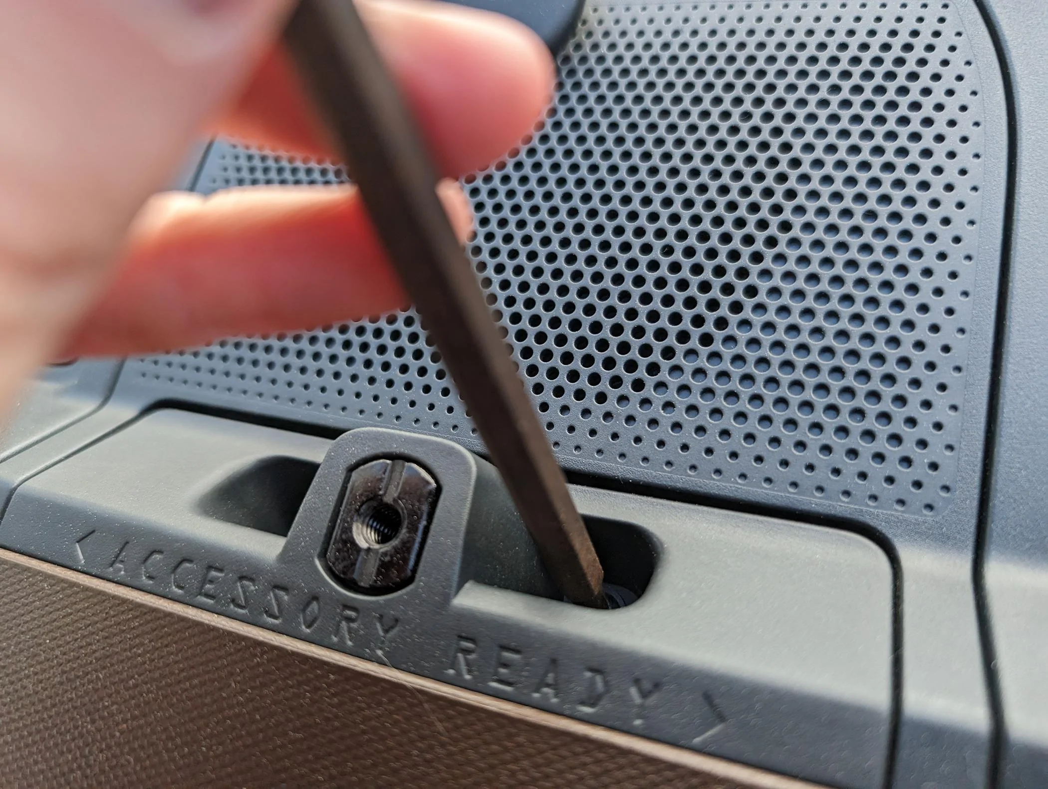

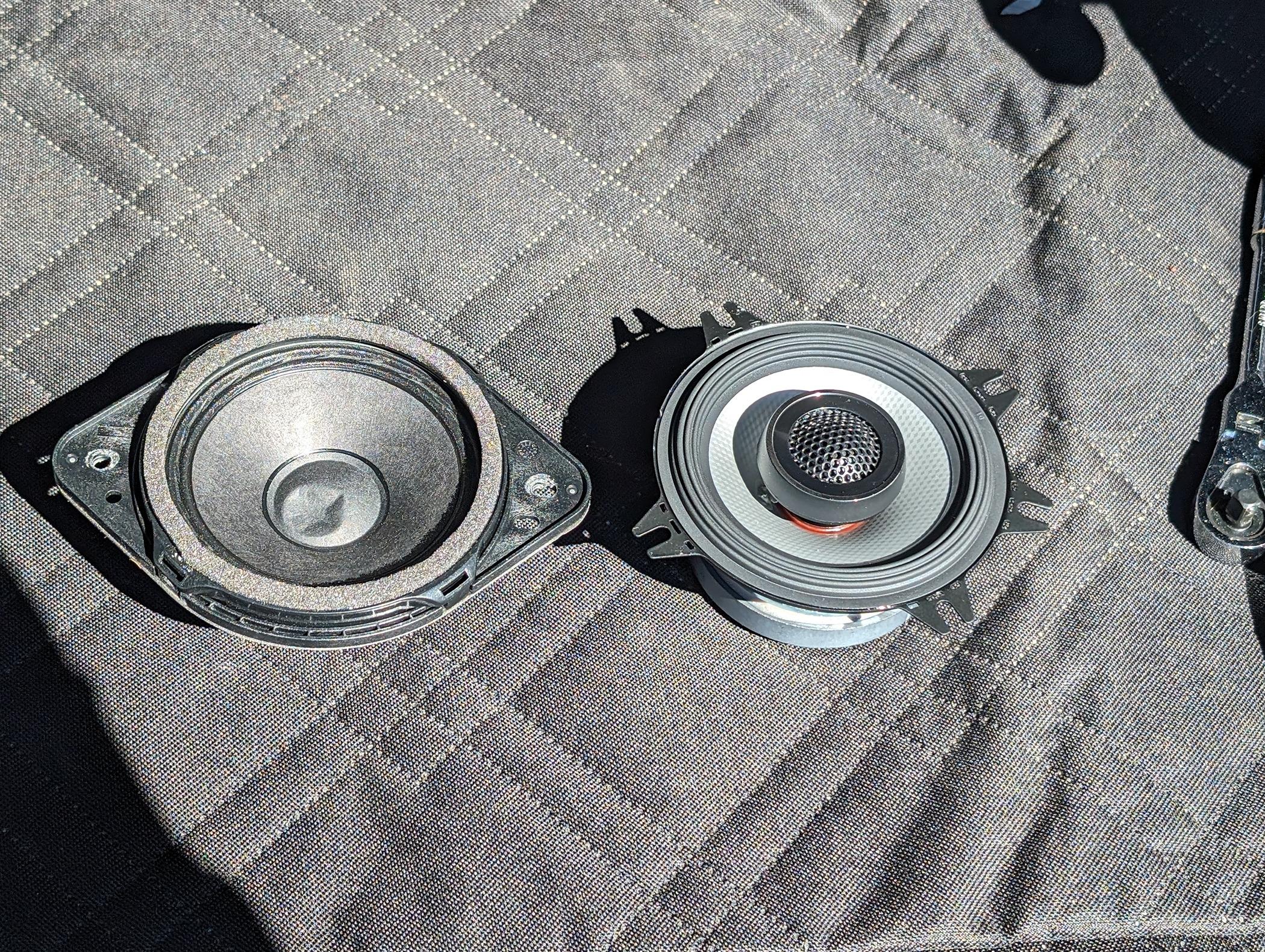

Replaced the "B&O" speakers with Alpine S2-S40s. The center dash speaker was replaced with a PRV Audio 4" midrange speaker.
Huge difference in sound quality and clarity, especially at higher volumes.
The accessory ready rail is a bit of a pita. The screws are T20. I read on this forum they are T27...
The B&O speakers are just standard cheap AF paper off-the-shelf Ford speakers.
This is a super easy DIY and only took an hour or two. and a few hundred bucks.

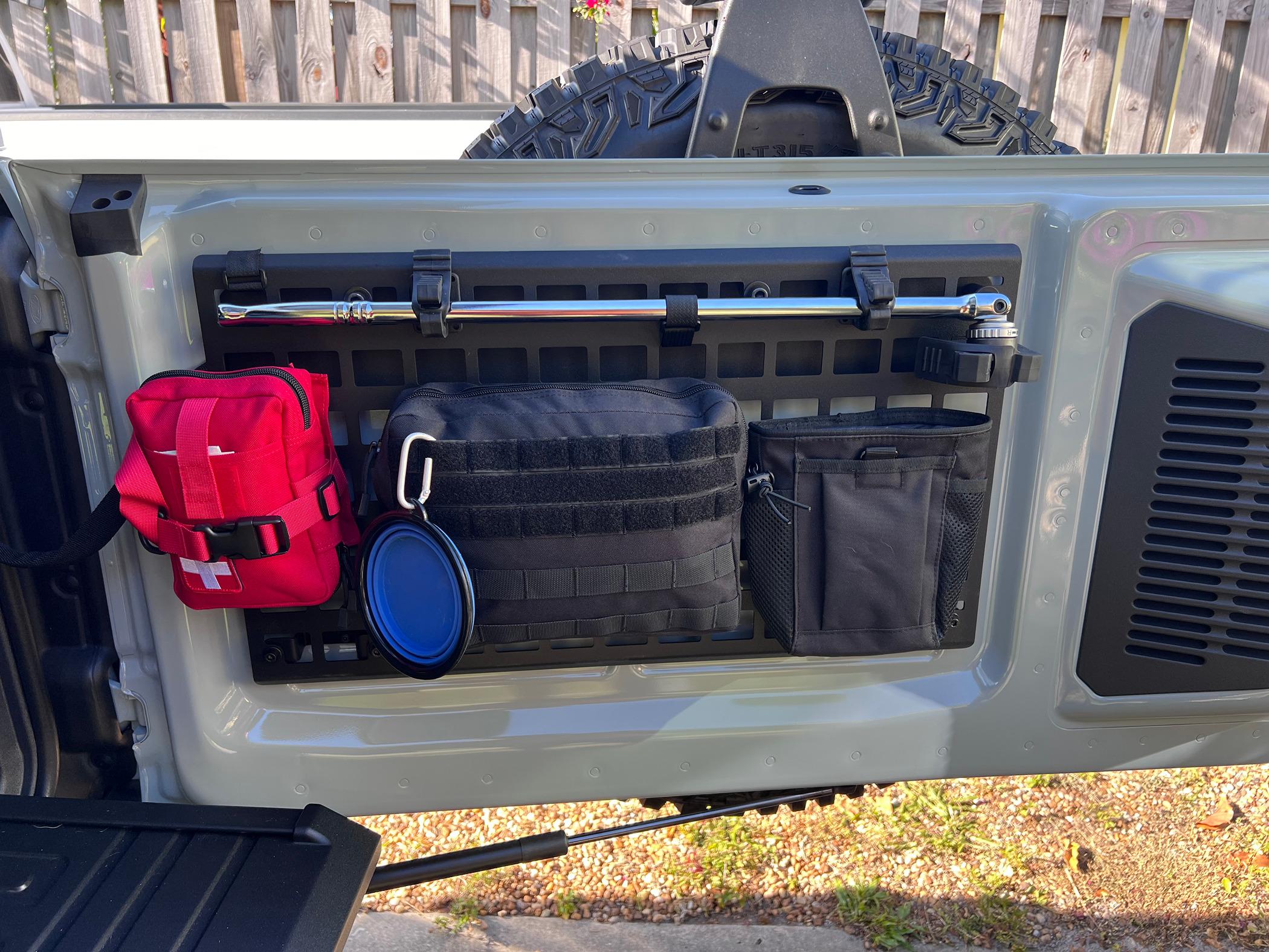

I love that breaker bar setup, share the details?
The breaker bar I got at Home Depot. The large clasp as the right end came with the molle panel. I ordered 2 small clasps from Putco (the company that manufacturers the OEM molle panel). The small clasps were still a little too big to hold the bar snug, so i added a small velcro strap to secure it from rattling.

I am waiting on my Alpines to arrive. Same speakers. How do you like how they sound?

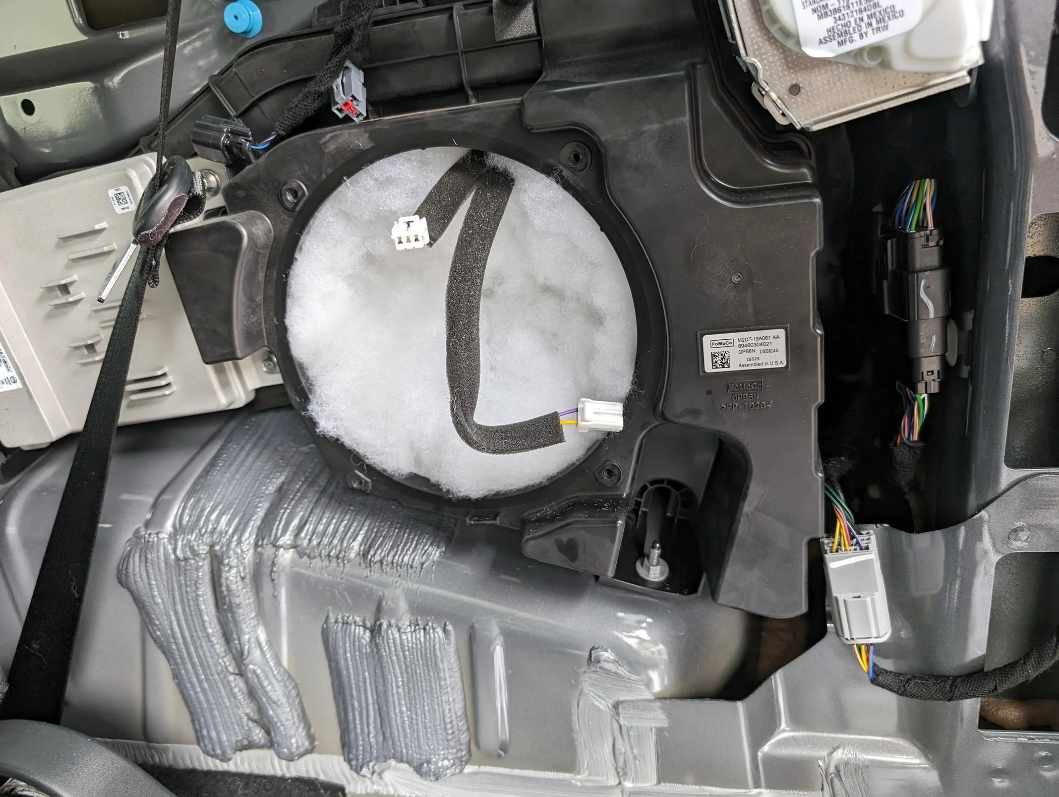

Polyfilled the factory subwoofer. Immediate improvement.
I'm a home audiophile, not a car audiophile, but this combined with my speaker upgrades is good enough for me.

I'm very happy with them.
Drove for 6 hours over the weekend and was very pleased.

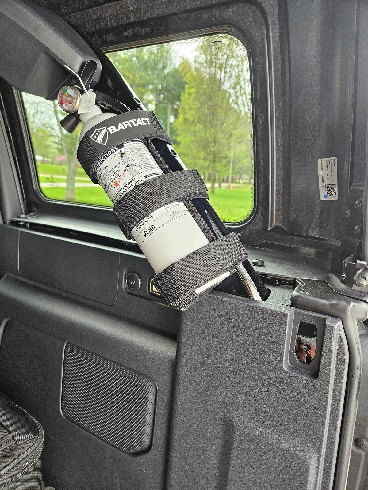

Mounted my fire extinguisher on the roll-bar using the Bartact mount. On the fence with it. I may get a different mount for it. I would much rather have it sitting on top of the roll-bar versus the side.
