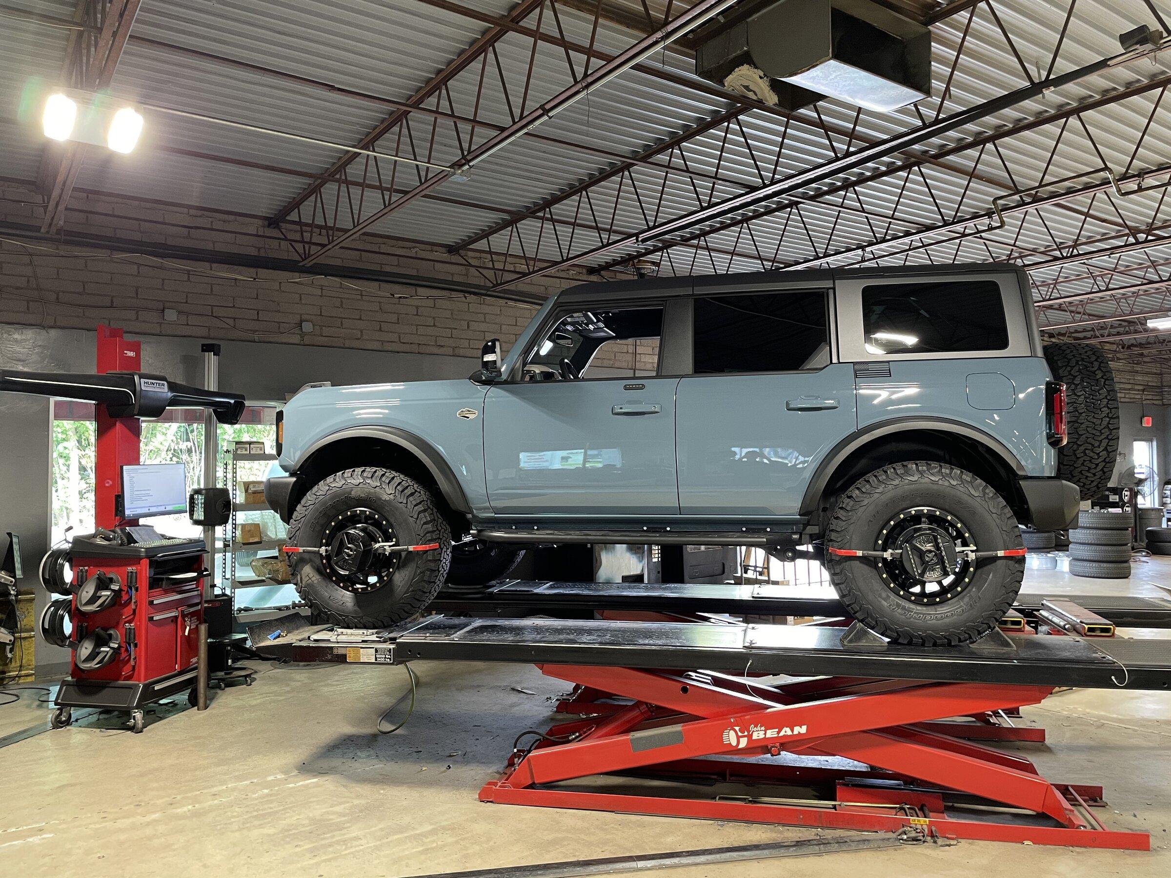

Ford Bronco What do I need to Run 37's on Sasquatch? 523EA44D-2F34-4894-8160-F3001B1CAD46
RPG collar perch kit running ko2 37x12.5 no rub yet we’ll see what the shop says after driving it
