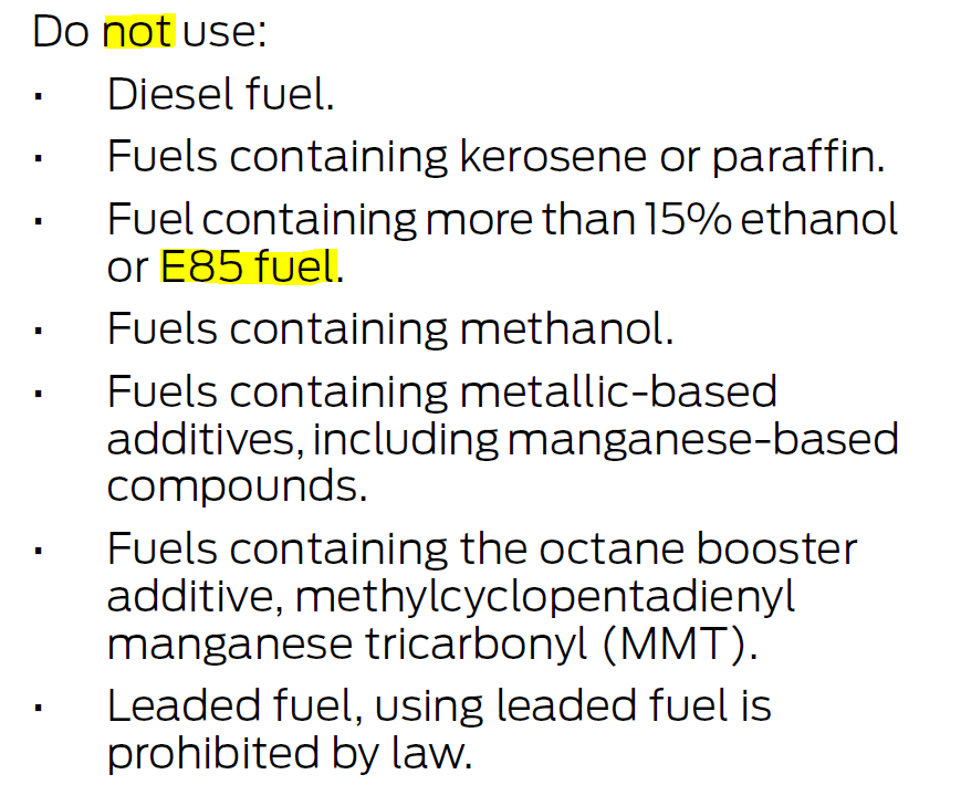

Wondering if anyone know what type of fuel the bronco takes and if it is a flex fuel. Would love it it can run on e-85. It one dollar less a gallon now.

No E-85. Unleaded 87 octane or better required (10% ethanol is OK).
Ford Bronco What gasoline does the bronco take? 1623917724207
