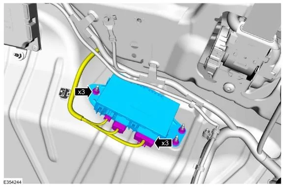

Here is a cad picture of the tow module that is included in the tow package. Look at some of the other threads on towing for the wiring diagrams. There is a lot of electronics in that box.

Electronics in the box equals chips equals delay

So that tow module would be typical of an after-market tow kit?
This translates a signal from the network communication system into turn signals. The Ford accessory will tap into the tail light wiring and essentially do the same thing just not as clean. I'm trying to figure out how to utilize some factory connectors and wiring to make it more like factory and not so shade tree.
