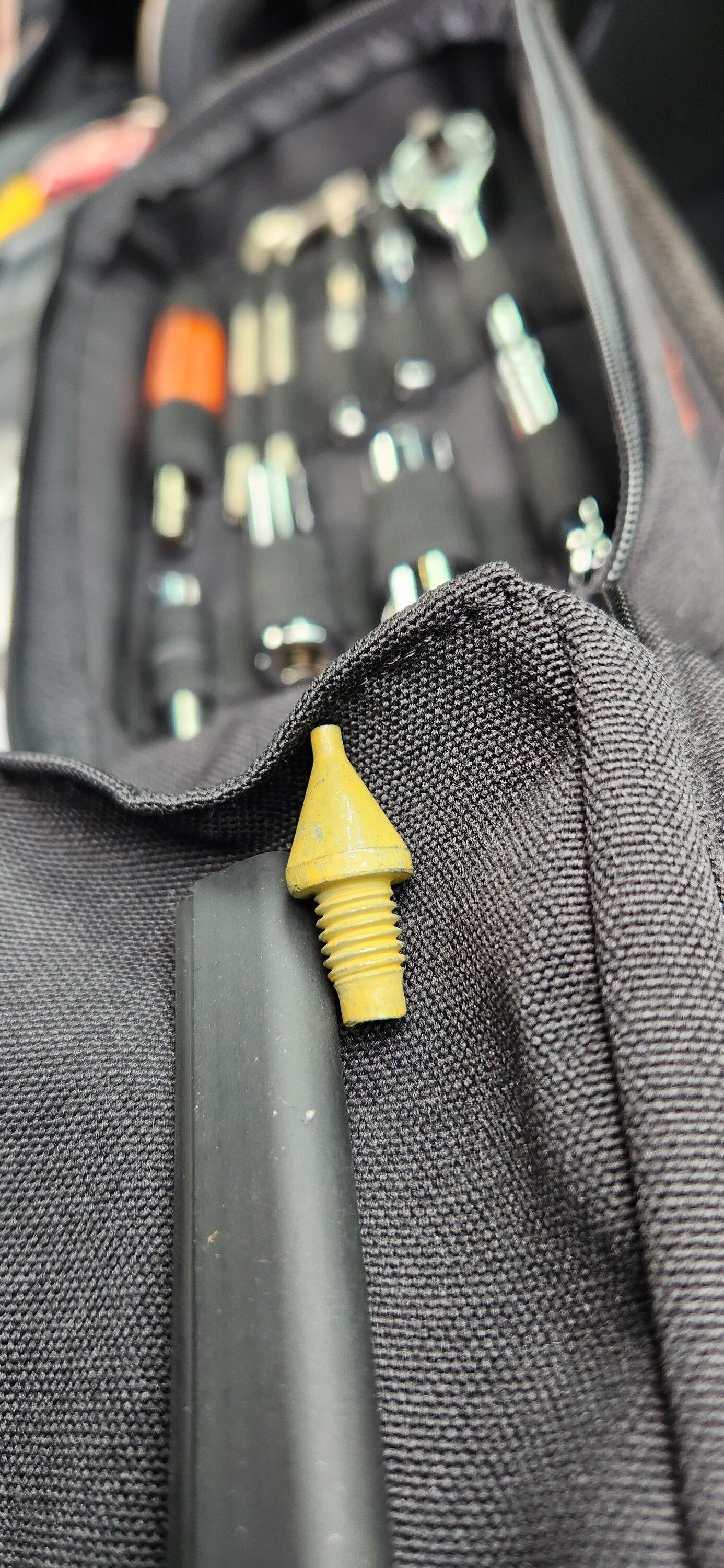

I was going through the tool kit in my Bronco Raptor and found this little guy in one of the zipped pockets. My guess would be a door alignment pin when reinstalling doors or something. Am I close?

which answer do you want?
in all cerealness, its a guiding pin for when you put the doors back in, screw that in the bottom hole, and screw it back out when you got the top door screw back in.
Its a Godsend

And I forget to use it every time and just do a lot of cursing 🤣

Is there a video of the usage?

When you use it, do not screw it all the way in, get it finger tight and then back it out a turn.
Otherwise you won't be able to unscrew it when the door is back on.
Learned the hard way.

Also its a PITA to install the doors in the dark, ask me how I know 😆
