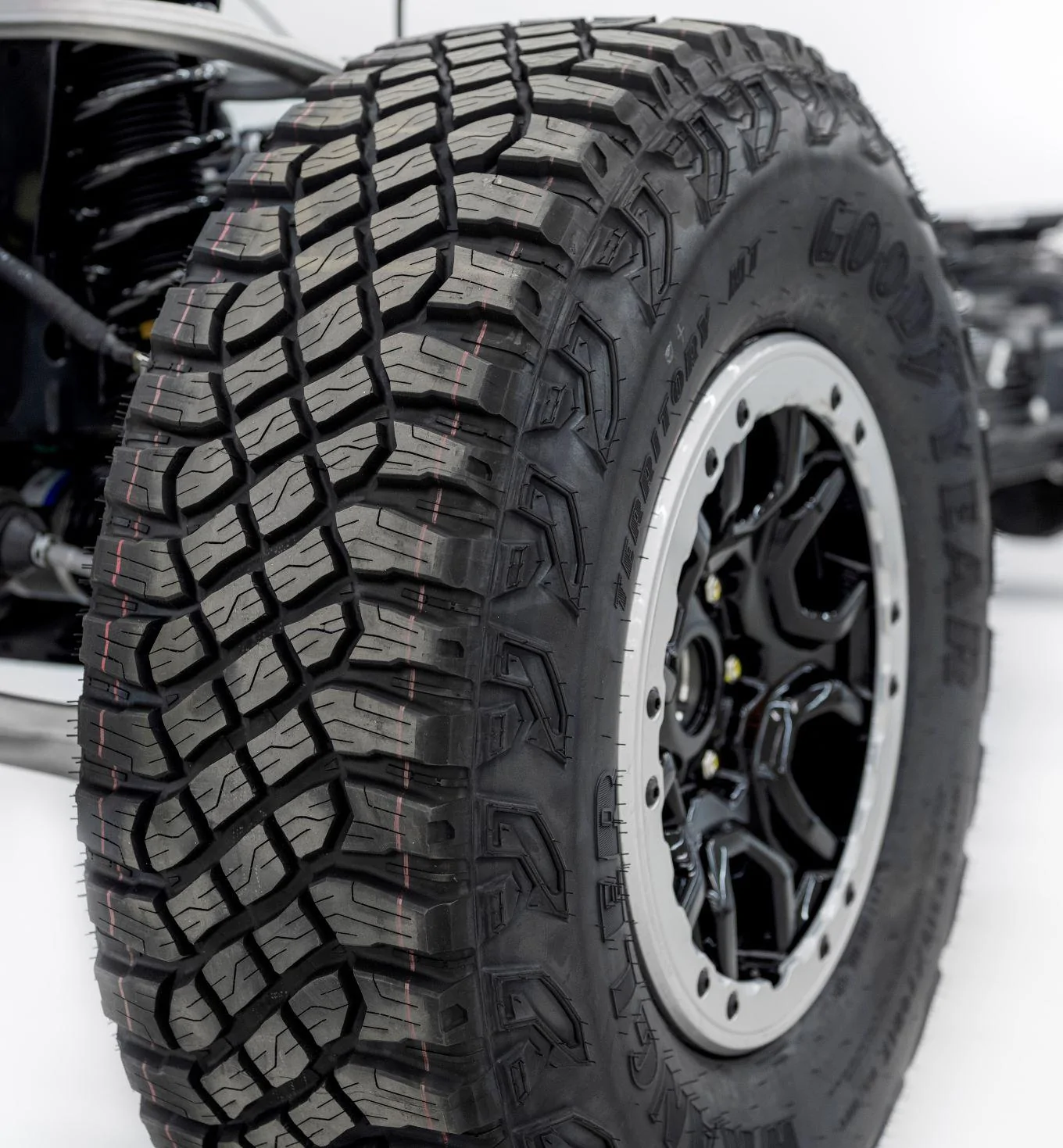

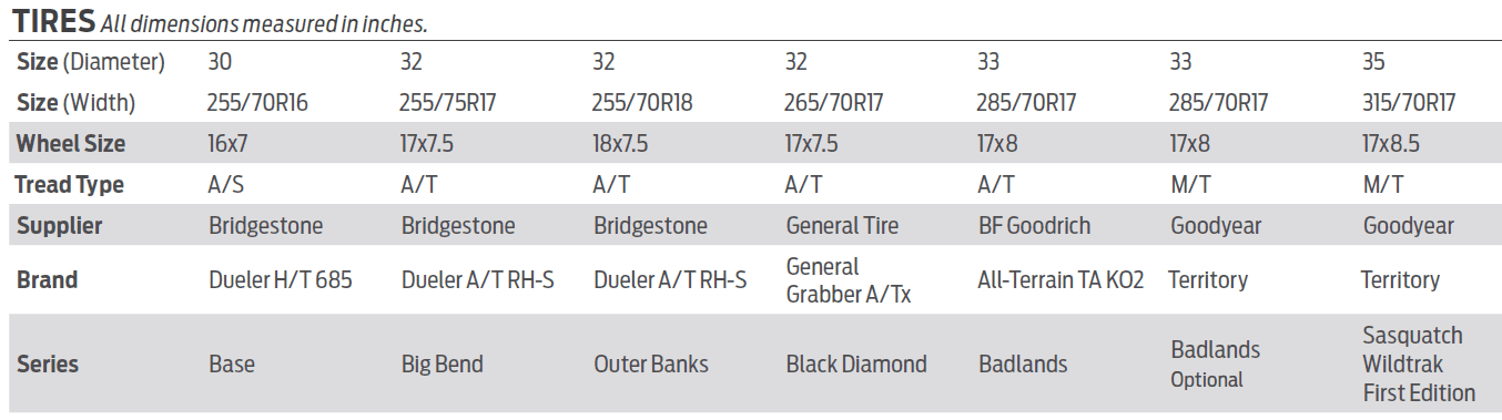

Besides the 35" size - 315/70R17 Goodyear Territory M/T, the 33" - 285/70R17 Goodyear Territory M/T is also an option on the non-Sasquatch Badlands, as seen in the below pdf spec sheet. As @Frank N pointed out these look more like an R/T tire. So what is an R/T tire, I went to google to find out:
R/T Tires: New Category, Not Marketing Hype
Top 5 Best Hybrid Truck Tires For 2020
As we get closer to the ordering time in December we should see some hands-on Bronco reviews, it will be interesting to see what is said about the new design Goodyear Territory M/T.
I may even consider ordering the available 33" - 285/70R17 size for my non-Sasquatch Badlands, anyone else?
That will be my choice. Keeps the smaller fender flares and less road noise on long trips.

Another thing to keep in mind when changing tire sizes is the gear ratio, stay with stock or upgrade will be a required decision.
Some one please help me understand the factors involved and potential impact when changing a tire size from stock to something else larger or smaller.
In my case am thinking that I'd like to get to a 33" tire and not sure whether it will be with an increase in size from the BlackDiamond [Automatic] 32" or as a decrease in size from a 35" Sasquatched BlackDiamond [Automatic].
I get it that the speedo will be off. And am familiar with the road handling advantages of lighter wheel/tire (unsprung weight) combinations.
But am concerned about what the impact might be for on-road acceleration, fuel mileage, or other bad side effects.
In my case the transmission would be automatic.
What should I expect or what do I need to evaluate?
I hope this data is current and accurate:
32" P255/75R17 32.1 x 10 46lbs
32" LT265/70R17 31.6 x 10.4 53lbs
33" LT285/70R17 32.7 x 11.2 58lb
35" LT315/70R17 34.4 x 12.4 65lb
