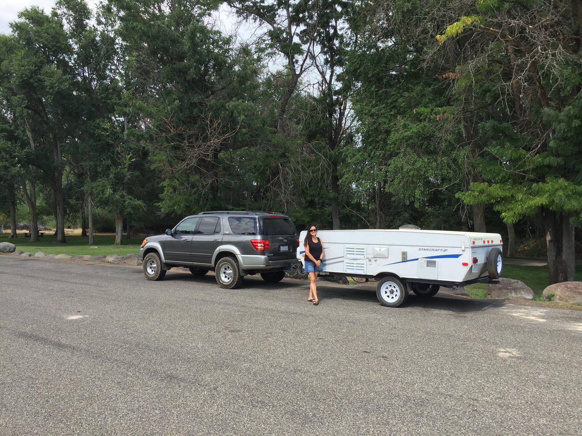

Id like to pull our Pop-up once in awhile.
The Sequoia has been doing it for years.
