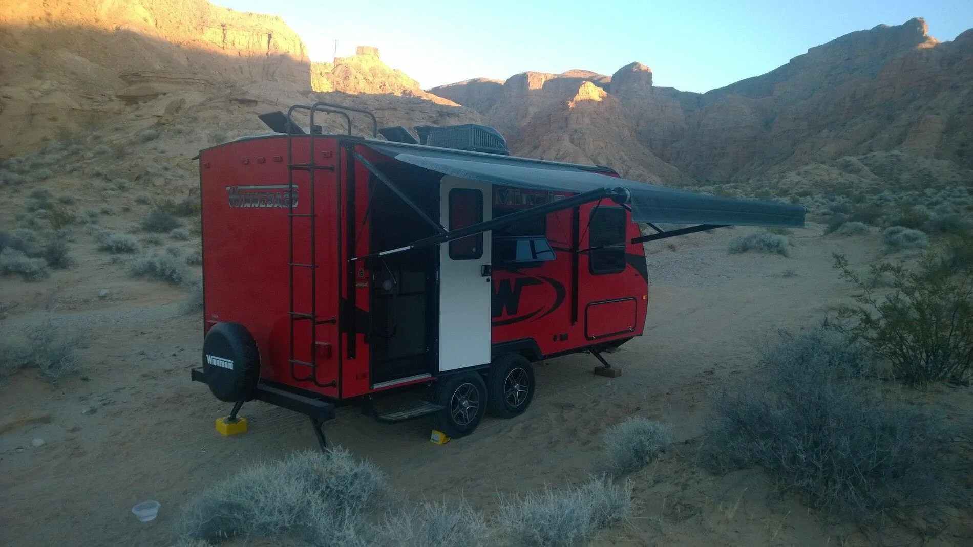

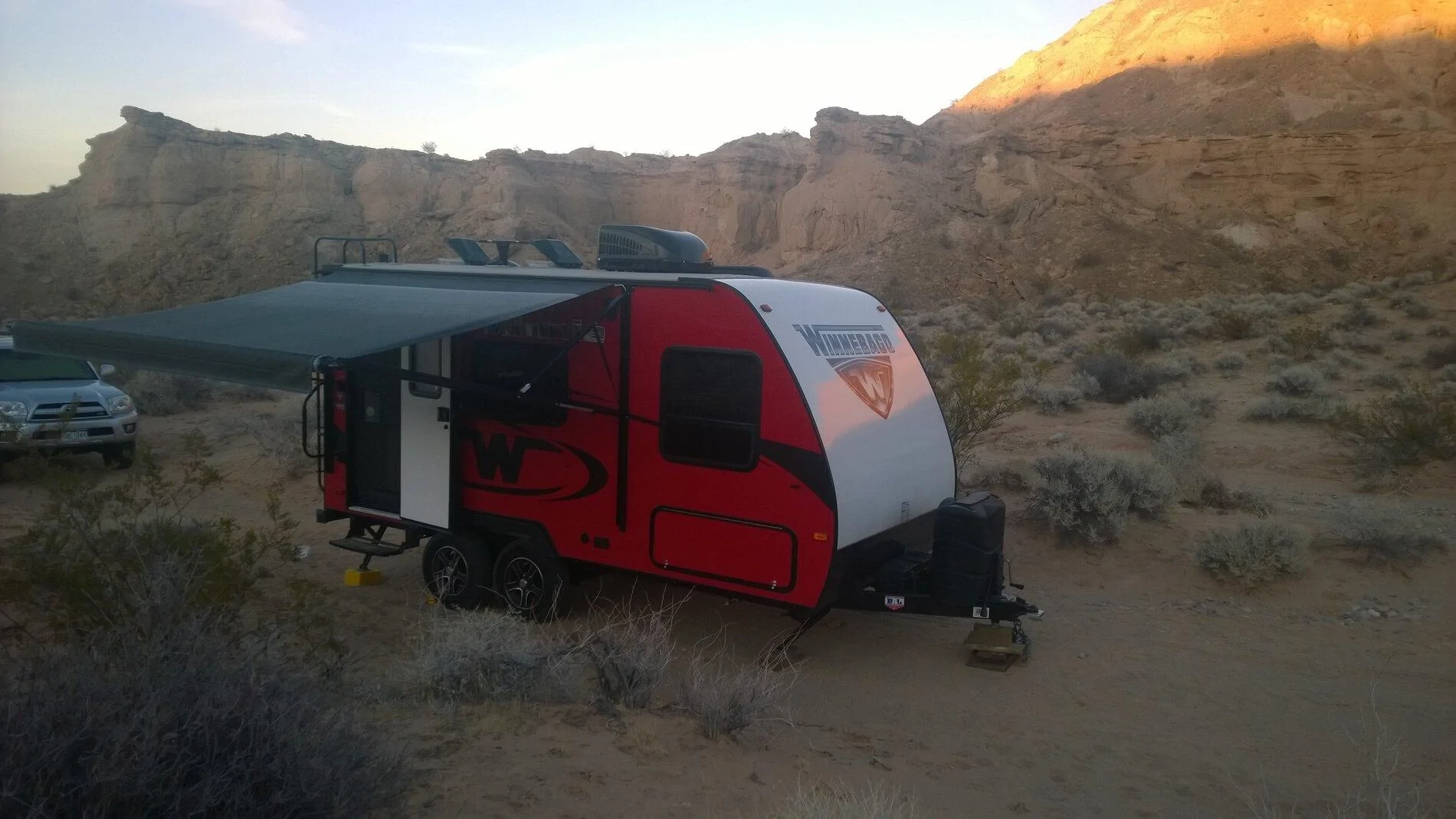

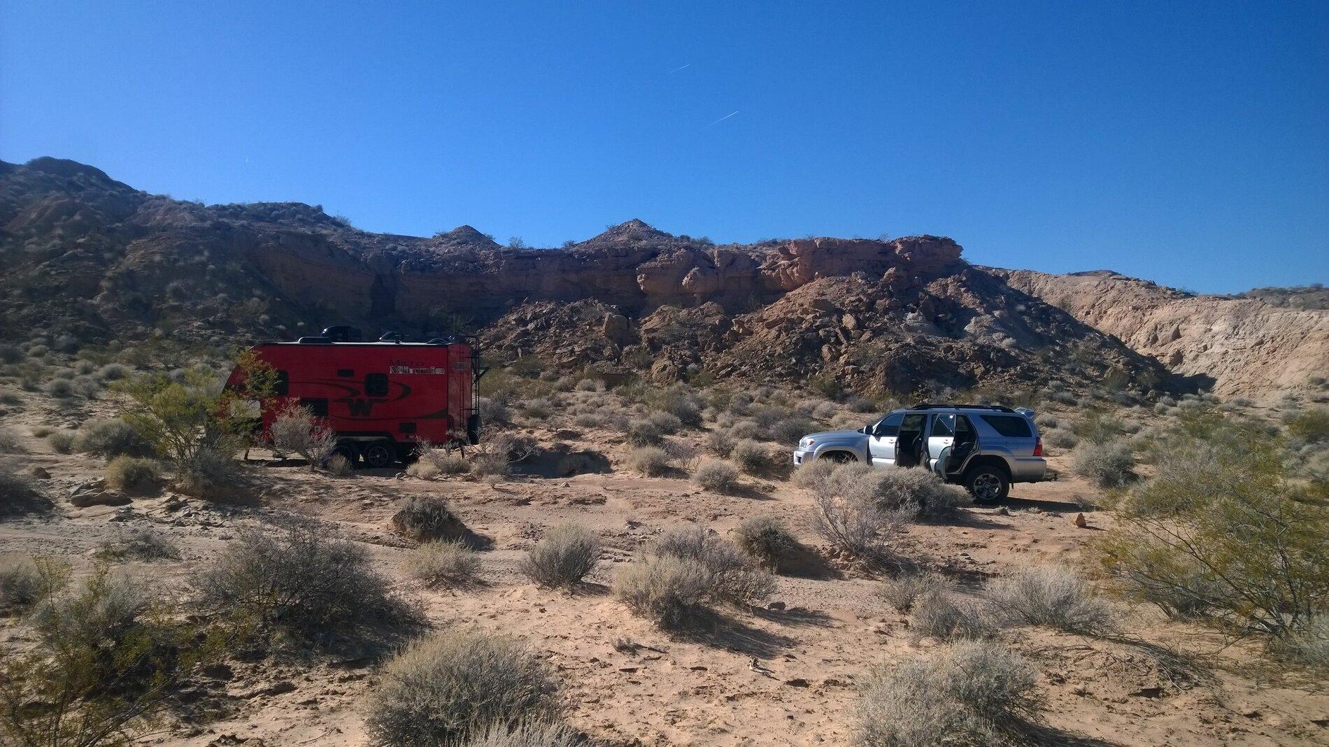

Well said. This is what I tow with a V8 4Runner
3000lbs dry, 4000lbs+ loaded for offroad. Gets to some nice places with the comforts of home. Bronco 4-dr should be able to easily, EASILY tow that to the same places as a 2008 4.7l 4Runner.
