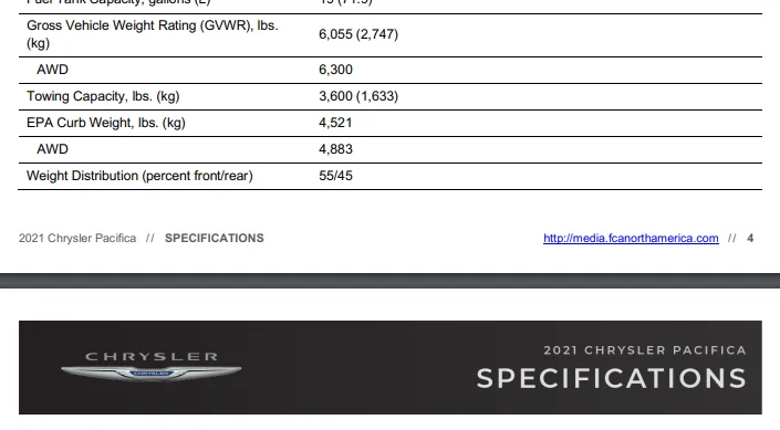

FWIW, an 8-passenger mini-van can tow 3600 pounds.
Ford Bronco What would be a realistic towing capacity? pacifica towi
