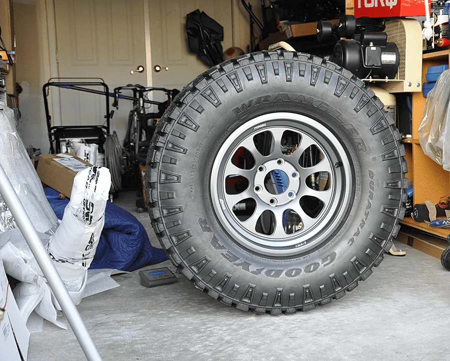

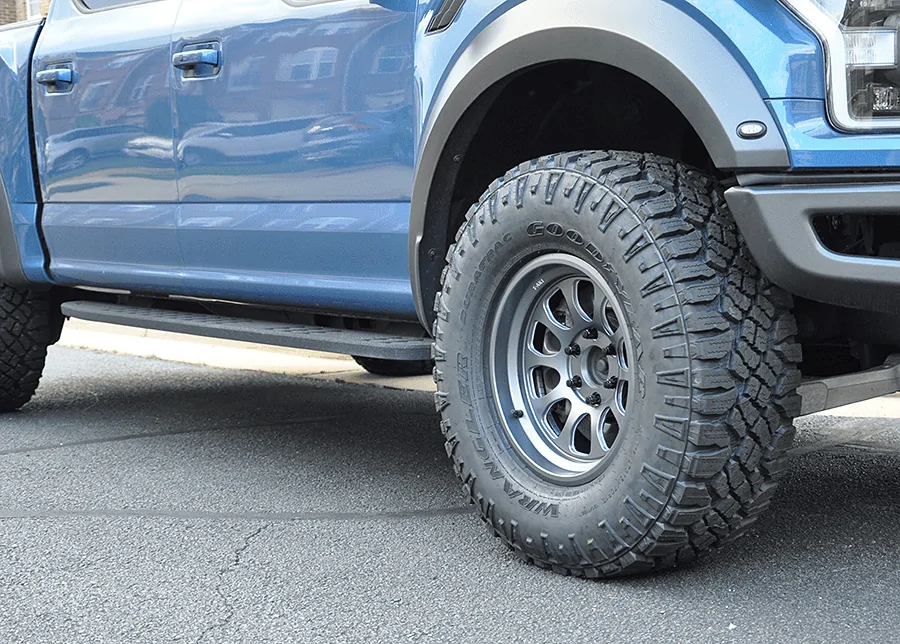

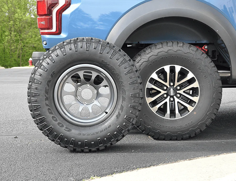

I am waiting as there are many manufacturers waiting on specs. I run Titan7s (Forged and about 10 pounds lighter when compared to OEM wheel) on my Raptor and will most likely run the same on the bronco:
Raptor911
Raptor911
Jun 17, 2020
1,152
2,443
Ashburn, VA
2019 Raptor, 2018 BMW M2
A new version is coming. The version I am running on my 2019 Raptor (the one below) was never designed with a center cap. The new version will have a center cap and it will most likely have a Bronco application.
