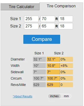

I don't really know anything about tires but what would happen if you selected a 275/65-18?
If these fit there would be no need to adjust the speedometer. Someone please correct me if this would not work. I was thinking of the Bronco Accessory wheel (18x8) and the size 2 tires in this chart if I changed from a BL to an OBX.

Your OB comes with +55 offset wheels… the widest tire that Ford sells on the +55 offset are 285s (the 285/70r17 on the BL).
There is already reports of people putting 315 width on +55 wheels without issue… but thats via a FB/IG post.
I’d say you’re absolutely safe doing up to 285 width since that’s what Ford already ships.
(diameter is a different story, but I think you won’t run into any real issues if all youre looking for is aesthetics)
