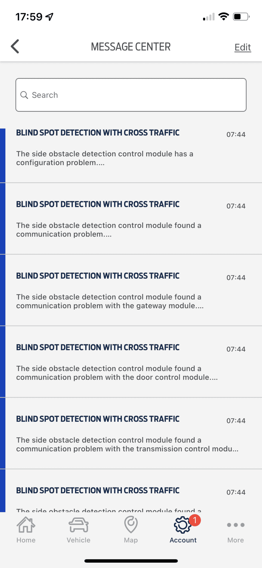

On Wednesday, I crossed over from Northern UT to Colorado Springs, saw some built Broncos headed west on 70 riding trailers, Havok Offroad was one. Anyway, in Chilk Fil-A parking lot, I got a "trailer brake fault" on the screen. I wasn't towing and had places to be, so I ignored it.
Did what I did in COS and drove back over I-80 in 40 mph headwinds getting horrific gas mileage.
Then, this morning, the wife asked me to take the daughter to school. Got "trailer brake fault," "trailer control module fault," then a bunch of "blind spot detection fault," "cross traffic fault," etc. And the passenger window wouldn't roll up! My daughter asked, "Can you roll the window up?" "Actually, no, let's take your mom's Lincoln instead." :eek:
Managed to get an 0830 appt at the dealer and they looked at the faults, then applied SSM 50148 (unplug and reseat C210 connector behind glove box).
Problem resolved.
Anyway, I was in at the dealer for a couple of hours this morning, but all's well now.

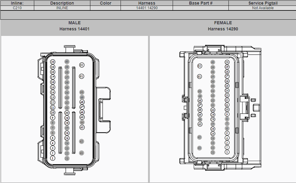

Had this happen on mine and one in the shop right now for some accessory install. We took mine apart and inspected, no issues found, reinstalled and have not had the fault come back. IMO, this is a real bitch to get apart and the terminals are stupid small, you mess it up and it's going to be expensive. Take your time and don't get rough with if you decide to inspect it.
SSM 50148 - 2021 Bronco – Multiple Warning Indicators / Messages In The IPC - Multiple Communication Fault DTCs Related To The HS2-CAN Network
Some 2021 Bronco vehicles may experience multiple warning indicators / messagesdisplayed in the instrument panel cluster (IPC) and/or multiple communication fault diagnostic trouble codes (DTC) setting in and/or related to the HS2-CAN modules. This may be due to a loose and/or improperly seated connector C210. If thevehicle exhibits the above conditions, access and inspect connector C210 for proper attachment and/or damage and repair as necessary. To access the connector, remove the right side lower cowl side panel (follow Workshop Manual, (WSM) Section 415-00 > Removal and Installation > A-Pillar Speaker, Steps 9-10) and the glove compartment (follow WSM Section 501-12 > Removal and Installation > Glove Compartment). If this fault persists, refer to WSM Section 418-00A and continue with normal diagnostics.

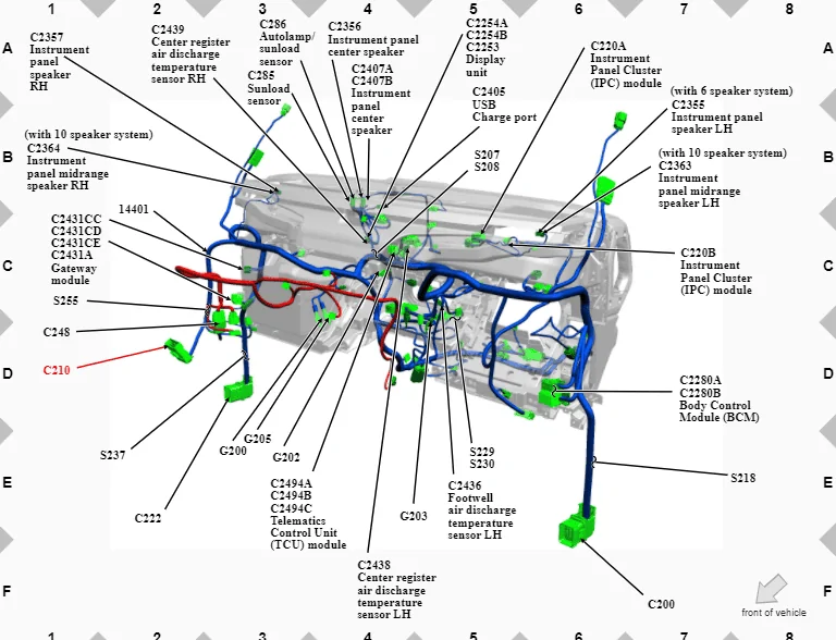

For others confused by the diagram — it’s from the perspective of the FRONT of the car, not from inside the car looking forward. You can tell by the direction of the grab handle that left is passenger side and right is driver side here.

a big THANK YOU for sharing this diagram, my electrician is going to appreciate this info!

So where is C210? Is it just under the passenger kick panel? Or behine the glove box? Ir is it worse than that?
