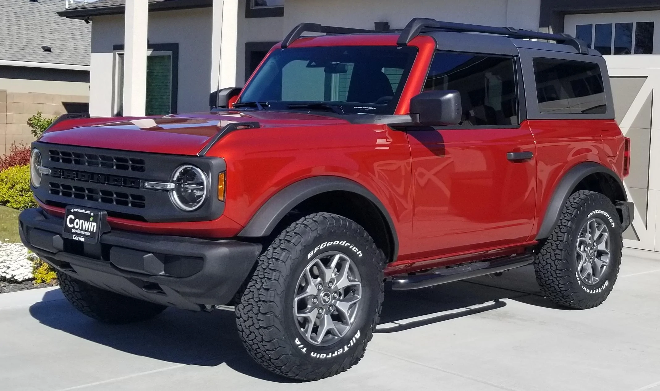

Rossel
Rossel
May 21, 2021
TriCities, WA
Ford Edge, C8 Corvette, Road King
Got my Ford Bronco Base and had Ford Quicklane add BFG KO2 to the Badland wheels. They removed the TPMS from the steel rims, put them on the Badland wheels and used the original lug nuts from the steel rims. I have not adjusted the speedometer yet so at 65 mph per Google maps I am going 70 mph.
