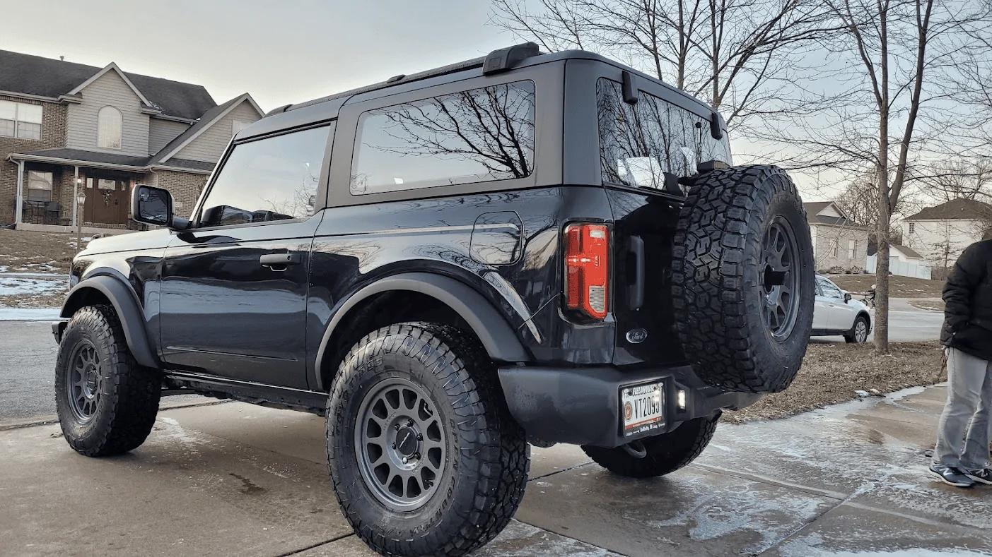

I went from a 30" Base steelie to a 35" on a 17x8.5 +35mm wheel.
It fits fine. Just kisses the brake light. Rides right on the tire support nub perfectly.
Go to https://tiresize.com/wheel-offset-calculator/ and check your fitment on the offset calculator and see if it sits any further inboard or outboard. If it does, you may need to do something with the little nub that supports the bottom of the tire.
Mine only moved by about 4/100th's of an inch.
