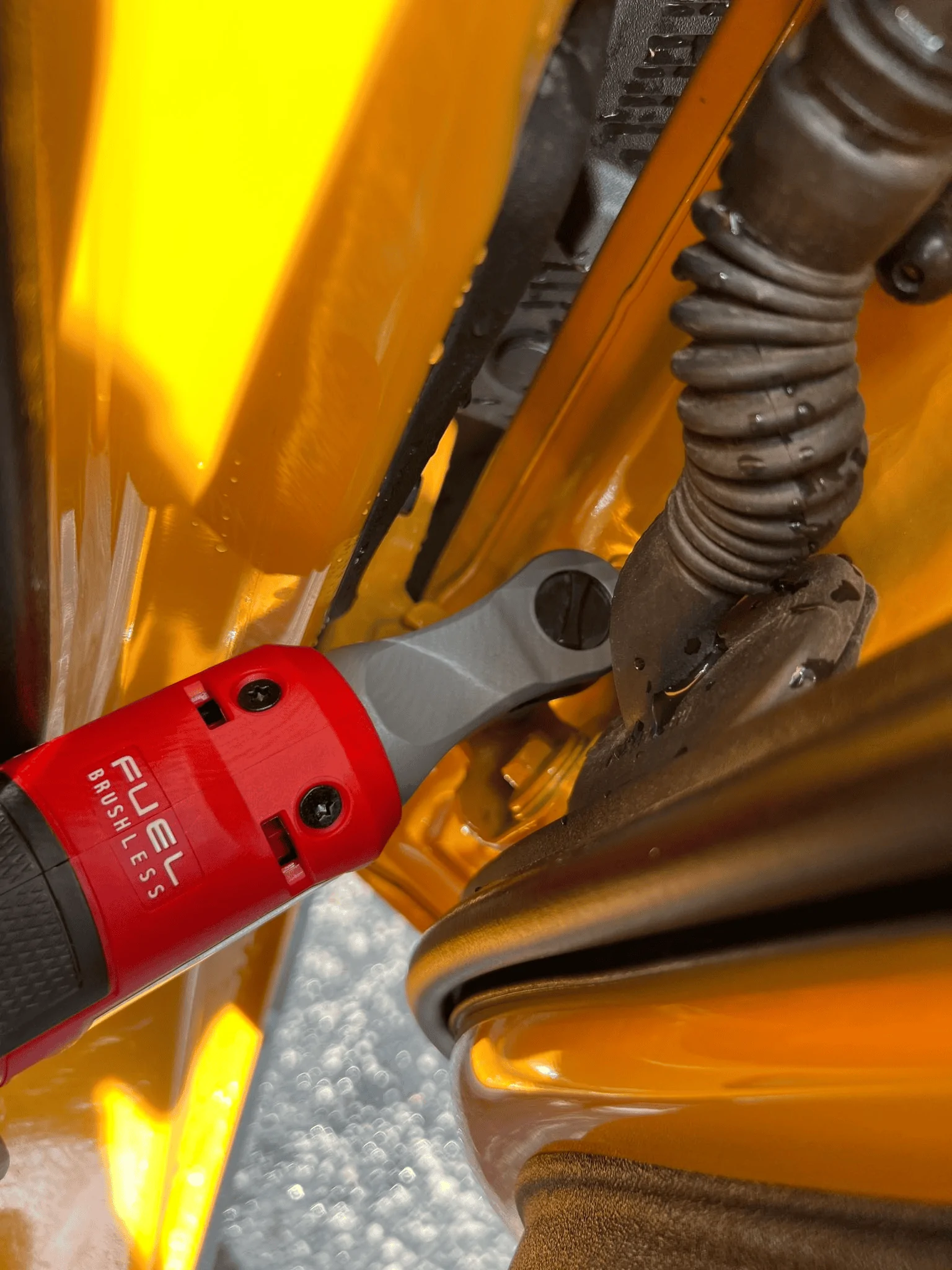

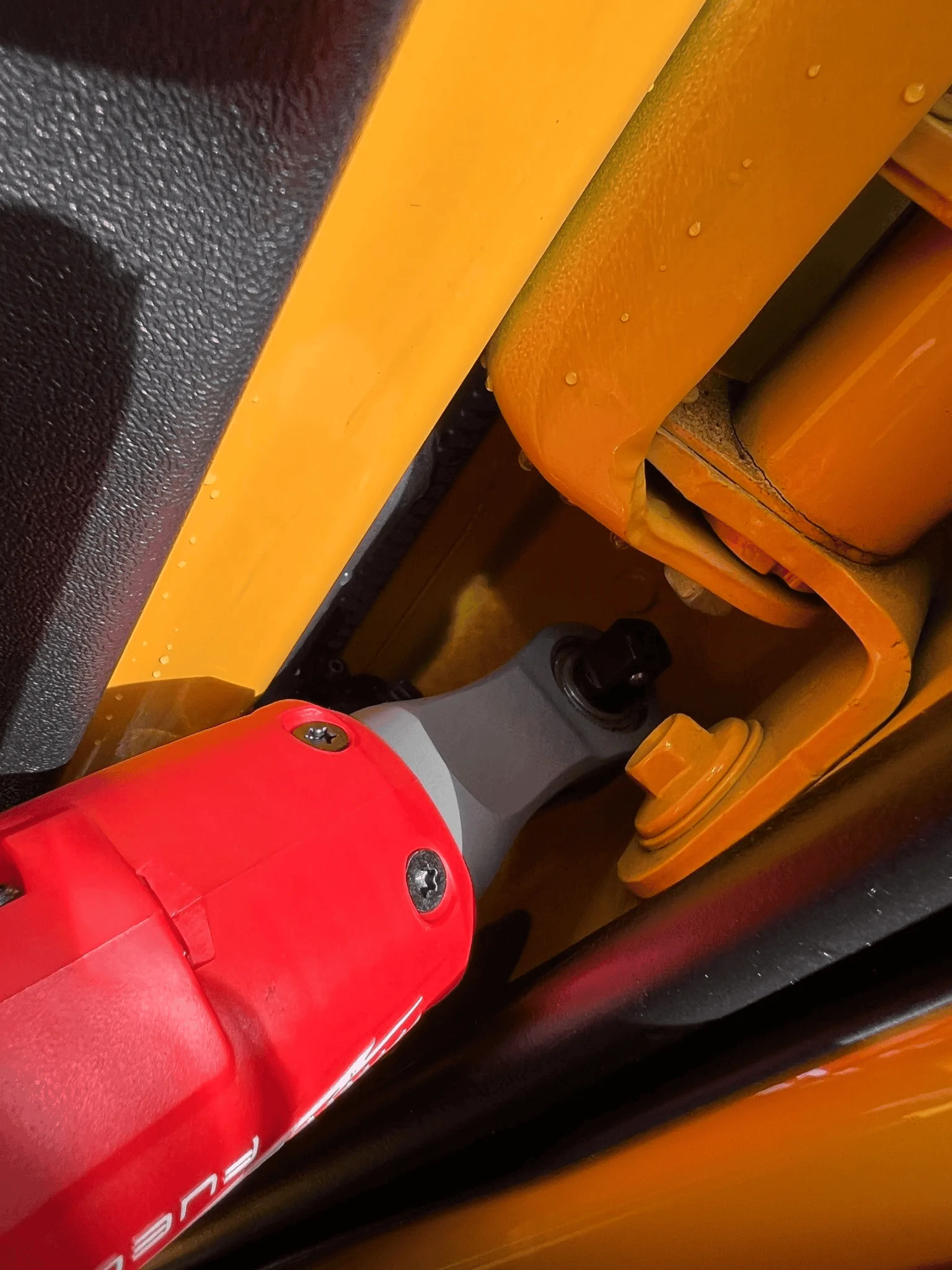

I have this Milwaukee ratchet:
https://www.homedepot.com/p/Milwauk...ne-Battery-Charger-and-Bag-2567-21H/317212356
It appears to have a smaller head than the one you posted. But I'll see if it fits tomorrow and post up here.
Ford Bronco Will this cordless ratchet work with taking doors on/off? 1661363542150
Ford Bronco Will this cordless ratchet work with taking doors on/off? 1661363554256
Keep in mind, these don't have a ton of torque so you normally have to start it by hand (can use the tool) then use the power feature to get it out the rest of the way. Because the wrench is thicker than a manual one you don't have as much room to break the bolts loose, but I think it would still work.
But I also agree with what has been said.. using the manual ratchet is fine. Most of the assistance the cordless one gives you is getting long bolts out after having broken them loose. The ones on our doors just aren't that long.
