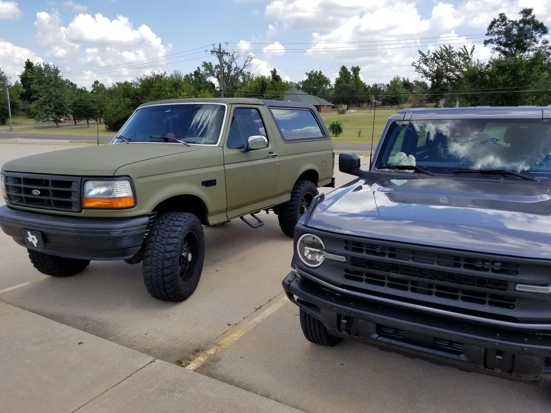

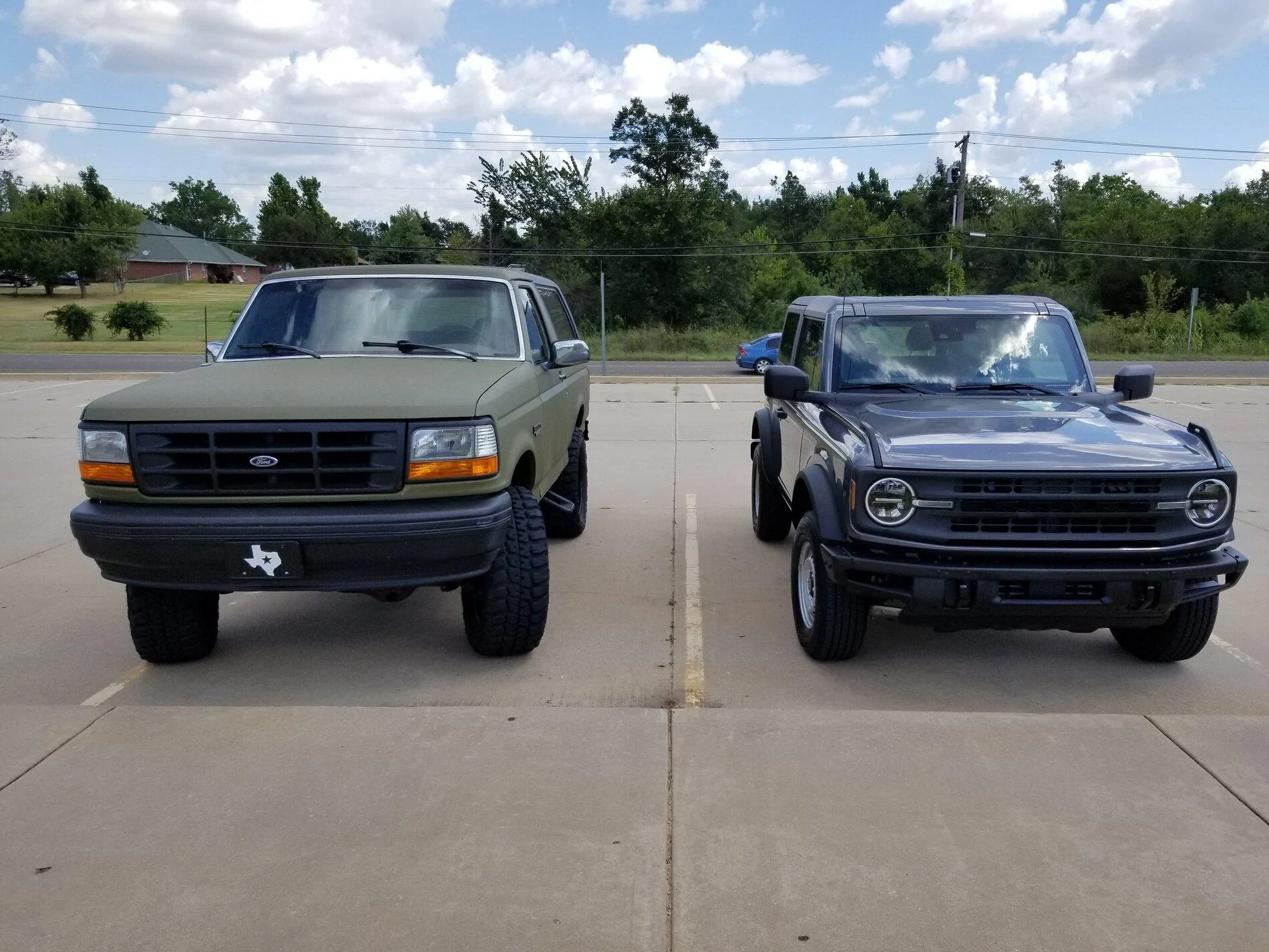

I've used Line x on a lot of other vehicles, on fender flares, roof rack and a bull bar. I plan on Line xing my upper dash. I parked next to a Bronco that was all Line x ed.
