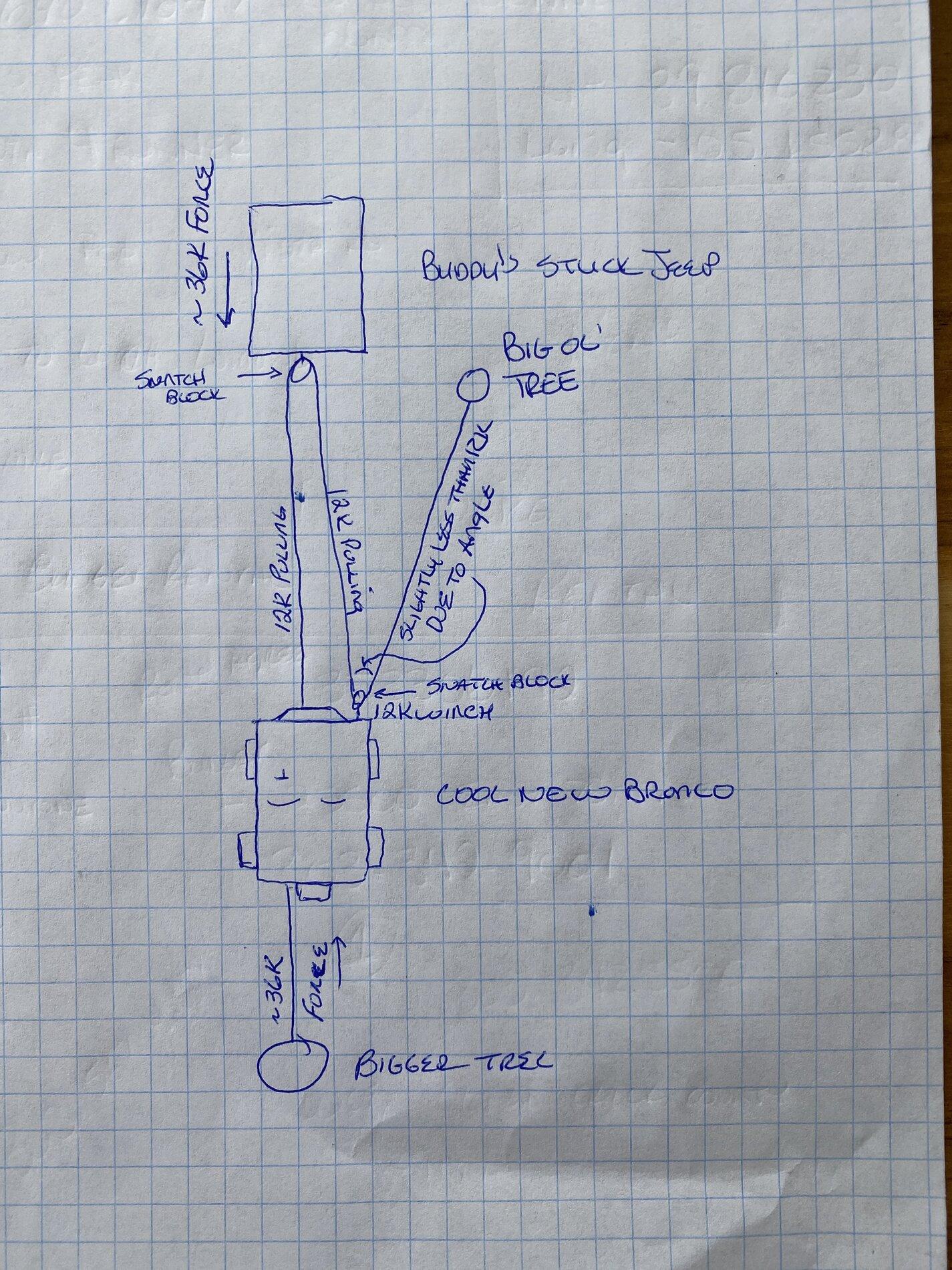

Help. This eludes me. Physics is magic to me!
Can someone draw what this looks like with a couple of pulleys and the power puller? I like this since it's for emergency only for me.

Here is an example of using a 12K winch to apply nearly 36K of pulling force on a stuck rig. There are a few things going on here. The winch, if near the last row on the spool, good powers and ground, good battery and charging system can get near the 12K rating. Each time the winch line goes around a pulley the force is increased at the snatch (pulley) block. So if we ran the line from the winch to the snatch block on the Jeep and back to our Lightning Blue First Edition, we would have 24K of pulling force at the Jeep and at the line at the back of our Bronco holding us still. The force on each line is only 12K. If we were to run a snatch block from the front of our bumper, run the line to a tree, we can apply nearly another 12K of force to the Jeep and the back of our bronco. 36K is a ton of force and puts a bunch of load on winch and bumper mounts, snatch blocks and mounts as well as the tree behind the bronco and the line connecting it. The tree savers involved, d-rings or soft shackles all have to be rated for those loads!

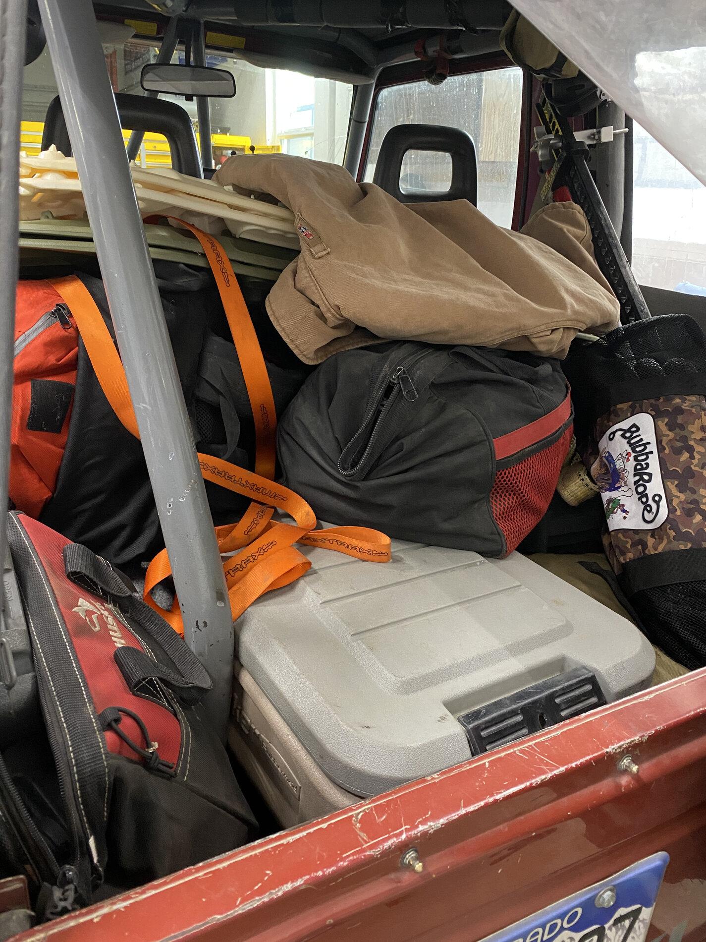

Here is what I carry in my Samurai when I am doing recoveries:
Ford Bronco Winch vs Lockers, Maxtrax, More Power Puller C7CAA77C-2F2A-4CE6-B0A5-A544F0CBF0FB
You will have to forgive the mess. I had to pull out a couple things last night.
