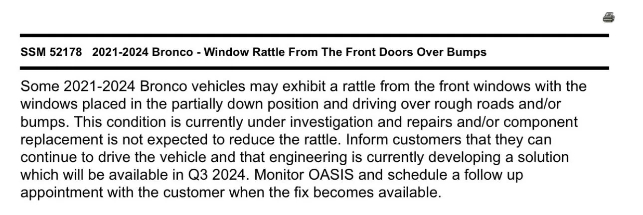

Still the same information that’s been out. Sometime in Q3
Do you have a link or pic of the info you're talking about? Do you know if it includes the auto window drop down when unlocking that they had for a little while?
This is specifically for the rattle over bumps.
The window drop feature is no longer available on vehicles not built with it.
Thanks for sharing. And yeah, I went to make an appointment for the window drop feature recently and found out they stopped doing it a couple months ago. Hope they bring it back
