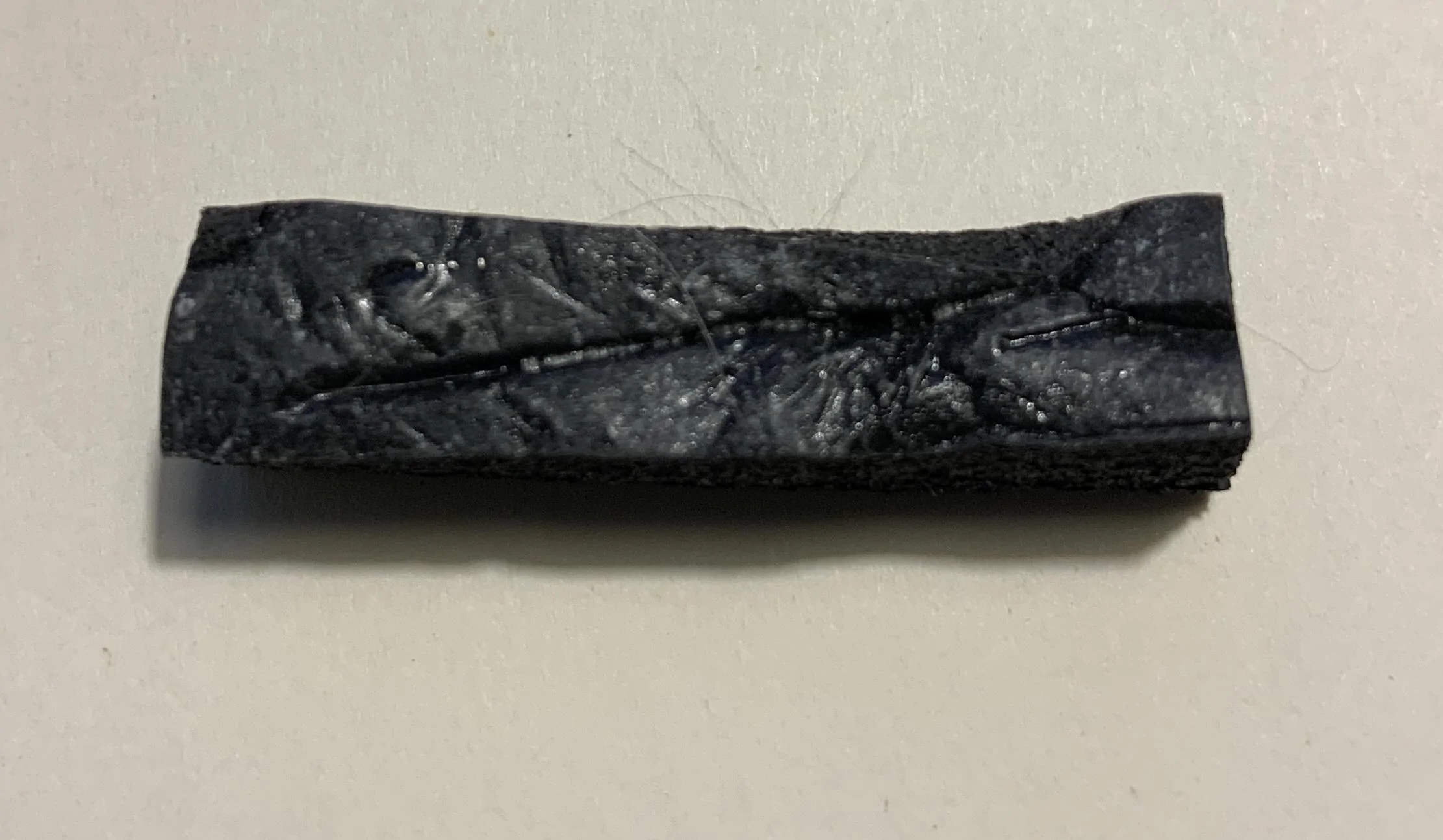

The first time I rolled the drivers side window down, when the window was rolled up this approximately one inch piece of foam came out of the door and was stuck to the inside glass. There appears to be adhesive on one of its sides. By chance is this part of the "rattling window fix" that came loose? Texas went through weeks of triple digit temperatures, so with the A/C on, the windows were always up. When it gets back into the seventies I'll check for rattles.

Omg don’t tell me that is a legitimate “part” being used to fix this
