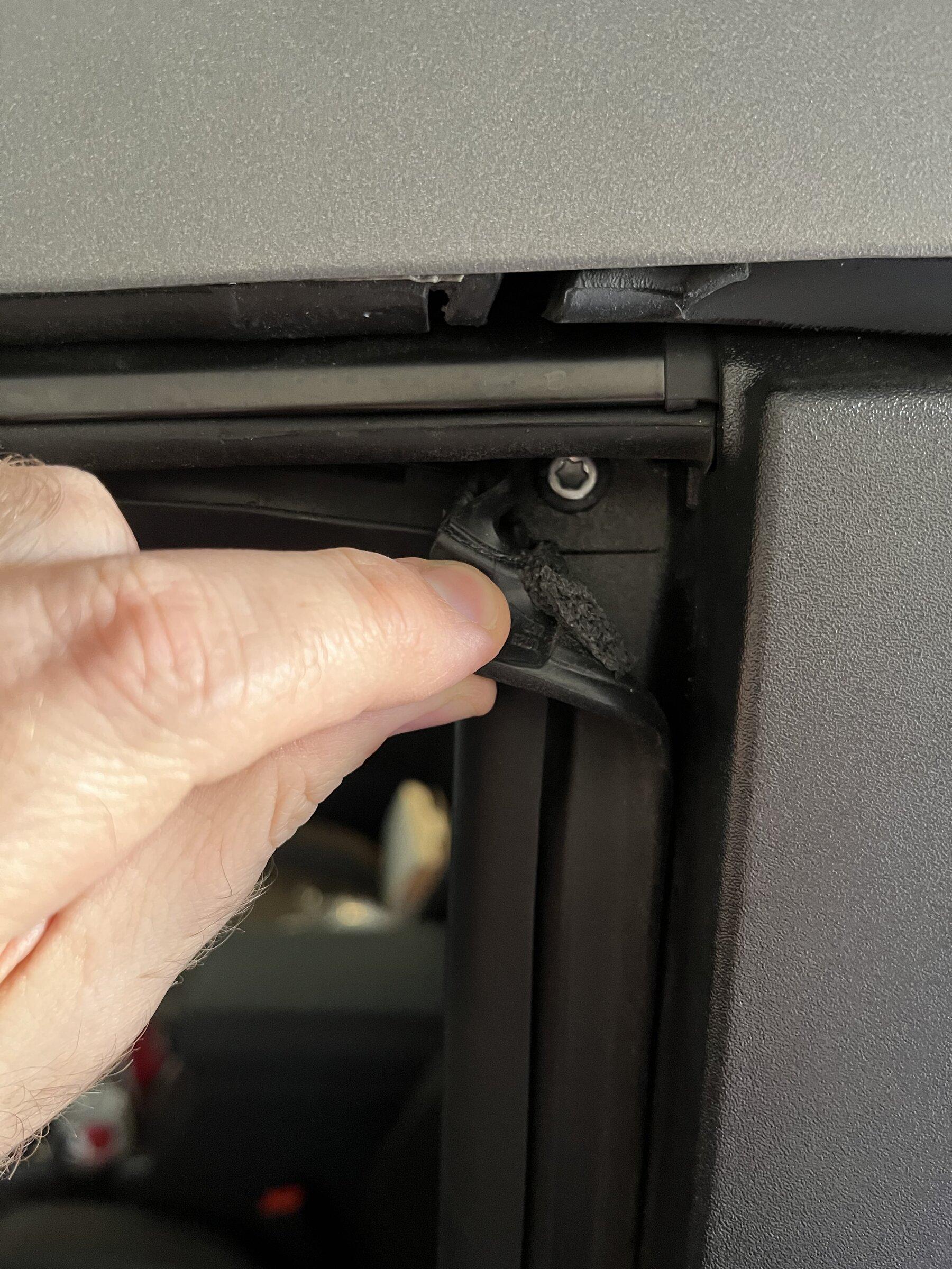

So I took it to the dealer on March 10th and they said they cannot do anything about the driver side window rattle when closing because it is a "false" pillar and there is nothing to support the window.
I took a little closer look and I think the window is rattling because the vertical weatherstripping near the top corner is not thick enough to support/put a little pressure on the window when closing (as the door latches).
As a test, I took some black cotton fabric and packed it behind the weatherstripping (from the top corner down for about 4 inches) and the rattle is much less noticeable. I also noticed the weatherstripping is not glued in place (you can slowly pull it to the left and it separates from the plastic trim easily. Maybe this is normal so it can expand/contract with temperature changes.
Below is a picture of the top corner access and my before/after videos.
Questions:
1. Is the weatherstripping attached properly?
2. Any comments on the DIY improvement? Long term, I think it needs to be a rubber or additional weatherstripping piece.
3. @Ford Motor Company Is there a better solution from Ford? I can't post these videos in our PM thread.

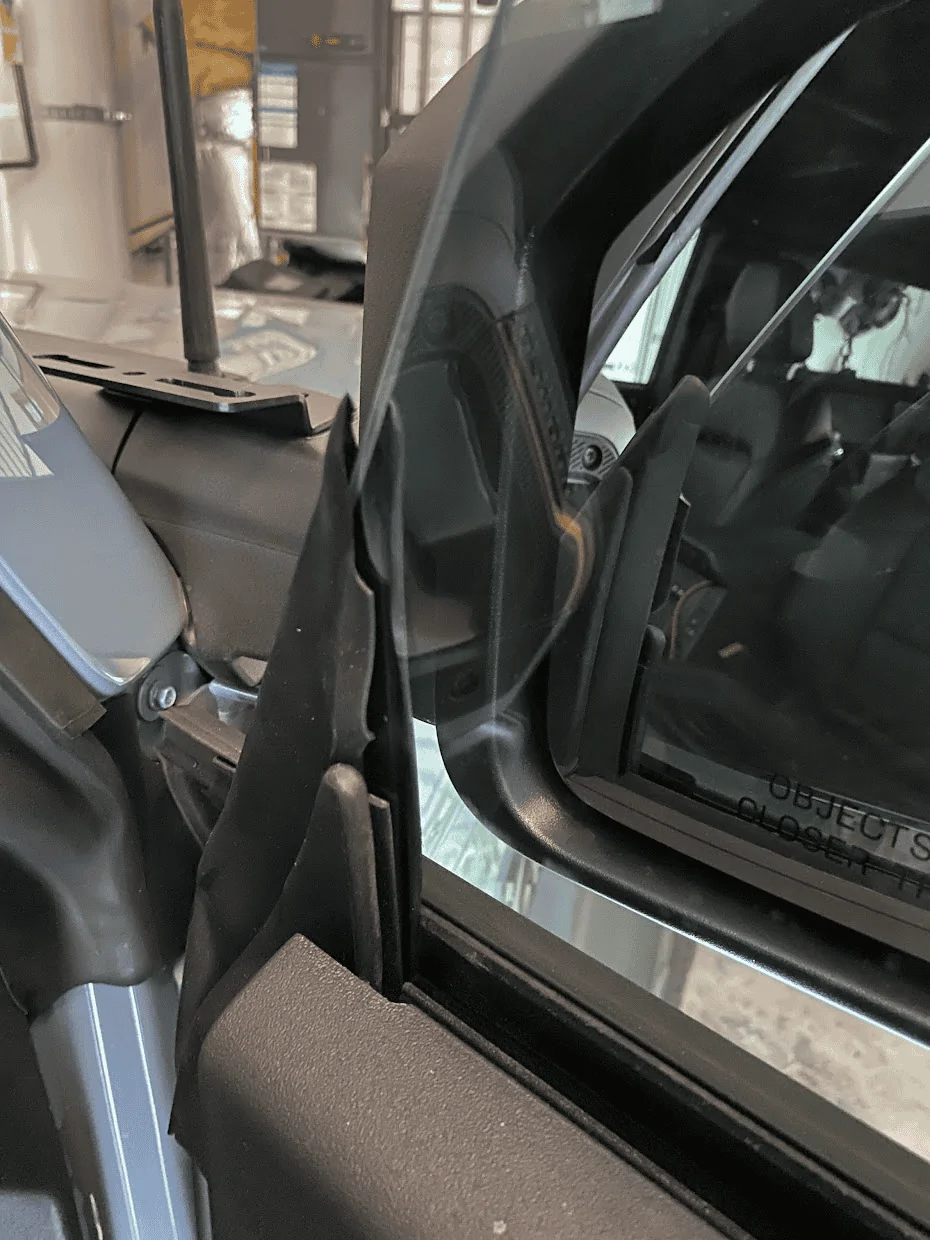

Can I send you my info too? I'm having a similar issue with my passenger door window on my 2-door. Much looser than the driver door and the weather stripping is gapping/tearing which makes for a howling wind noise even when fully closed. It's done this from day one. My dealership was looking into it, but I've heard nothing back.
Here's a picture of what is going on with the passenger door.
