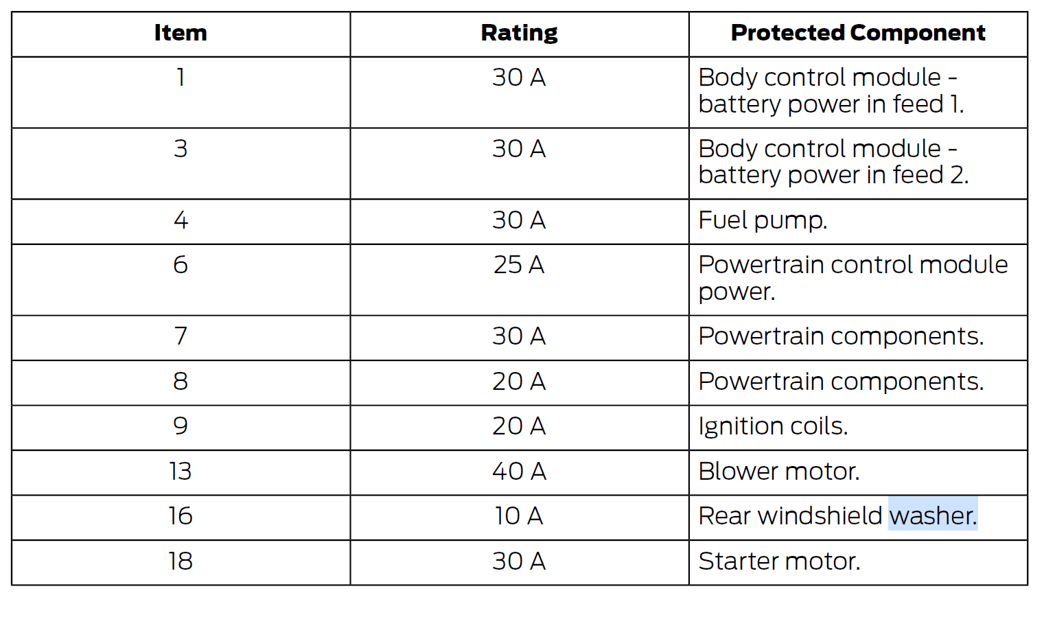

Anyway, discovered that front and back washer pumps are #16 under hood. Pulled it, was burnt out. Didn't see any "spare" 10 AMP fuses, so poached the sway bar disconnect, which my Wildtrac doesn't have.

Recently had this happen to me, only thing I can think of is the -10 degree weather we had where I drove into work and I'm guessing the fluid froze, as flip had suggested above. Sure enough, the fuse was blown when I decided to finally check it. I'm guessing I'll just replace the fluid with a better quality fluid that won't freeze, the scenario makes sense as to what happened.

Experienced this today also, was out in temperatures around 15*F overnight, and my fluid (summer blend) froze over. Attempted to spray my windshield and ended up blowing fuse #16. Replaced it & all is well now.
