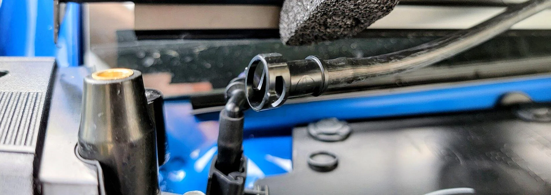

Easy fix. Found the hose disconnected under the cowl.

Remove the cowl cover passenger side lift up and you'll see the washer tubes.
Nice. Just a couple of screws, right? Just got back from her first ride...

Yes the hex heads
same issue here, sprayer has never worked. I removed the hex head but cant check all the lines without removing the wiper arms as well. Anyone know how to do that? I removed the nut but the arm still doesnt come off. I hate to take it to the dealer just cause it is not spraying. I dont drive much so it will be a while before it needs a service.
