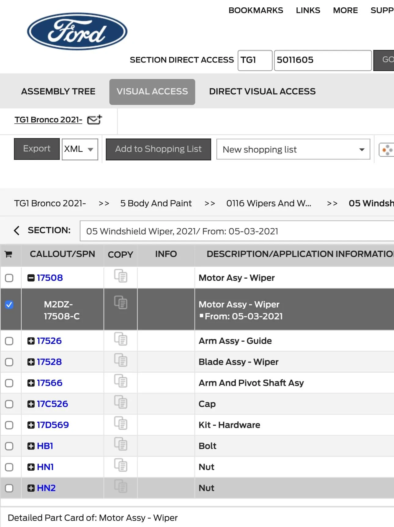

That is not correct - wiper motor part number is M2DZ-17508-C. Original motor p/n is M2DZ-17508-A.
Wrong.
Just because it is -C and not -A, doesn’t mean it’s been updated at all.
As you can see, M2DZ-17508-C has been the ONLY part number since 5/03/21 when the bronco was first built.

That’s not accurate at all. The wiper motor that it was built with, is the same as the service part sold over the counter at any Ford dealer currently. The share the exact same engineering and service part number.
I have been running (+ restoring) Fords my entire adult life (40+ years).
Just because they have the same engineering & part # absolutely does not mean they came from the same supplier.
Ducati1098
3,693
7,360
Midwest
2022 Bronco Wildtrak, 2012 Ford Fusion
Anytime a part changes suppliers or anything else, the part number is changed.
Considering the part number for the wiper motor has NEVER changed, it’s the identical part that it was built with from the factory.
